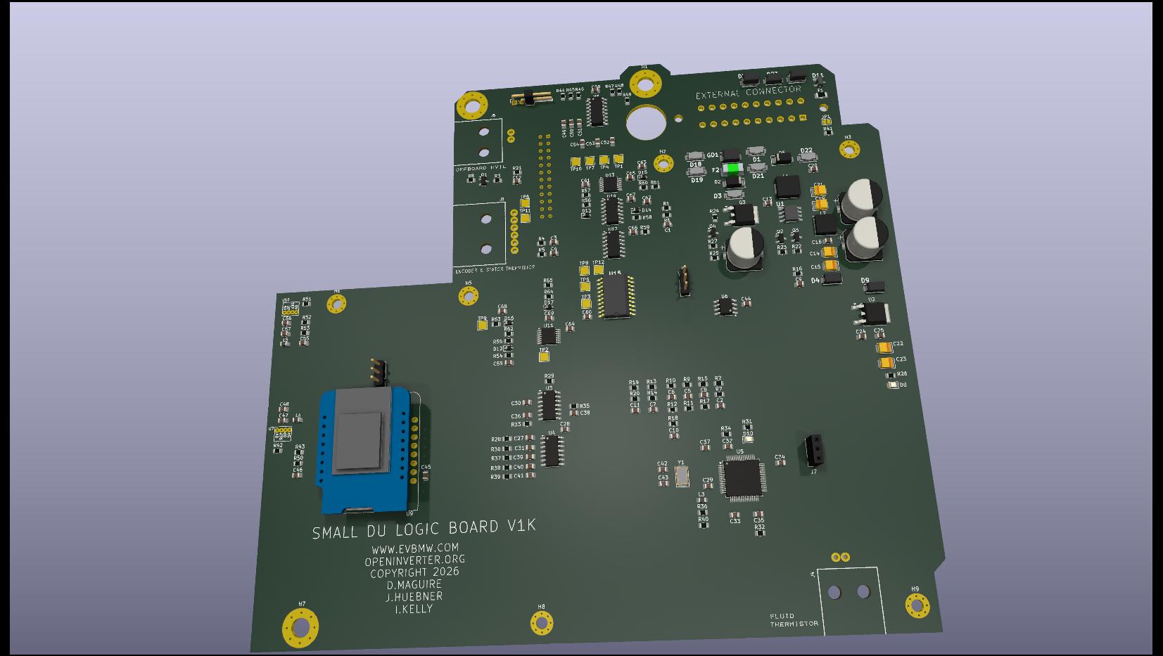

So just a little preview of a long overdue upgrade to the SDU board and if proves successful I will also apply these changes to the LDU board. The Model 3 project thought me a lot. The changes are (in no particular order)
-Move to Kicad from Designspark PCB. A guy did this some time ago and posted a few videos but never made the design public so I had to reinvent the wheel as usual.
-Power supply updated to the same as the M3 (XL1509) with Terminal 15 control. No more uncontrolled shutdowns.
-All input pins have TVS protection.
-Gate driver section now has hardware enforced minimum deadtime and anti shootthrough protection.
-5V throttle output protected by a polyfuse.
-Contactor drivers removed. There is no need these days to drive contactors from an inverter.
-Gate driver powerup and enable now under control from the STM32.
-Wifi module changed to Wemos D1
-Current sensor filters updated to M3 design.
-Canbus now has dedicated TVS protection.
-PCB mounting holes now hard connected to the GND plane as M3 board.
Attached a very rough schematic showing the work so far. Not shown here but will be on the final PCB is a kind contribution from my old friends at Arch Enemy Motors in the form of a 3d printable retainer for the Melexis hall sensors.
I don't have an SDU anymore but was donated a failed inverter and OEM logic boards for development and testing. I can't give a timeline on this as yet so please don't ask but it is being worked on as much as I can given other projects. Once I have something resembling a board layout I will add the Kicad project to the SDU repo on GitHub.
Finally , I THINK I know what is causing the failures but until I get some hard proof I don't want to speculate as its mostly just gut feeling. During my research I can across this website which has some very useful info for both SDU and M3 : https://ohm.ninja/tesla-traction-inverter-gate-drive/

Some folks use the positive contactor output for fan control, maybe you could leave the TO footprint and traces intact?
One pattern with the failures was they usually happen during slow takeoff and not at full or at speed. Hope that fits you theory.

By popular demand the current work in progress of the Kicad SDU board is now shared on GitHub :
https://github.com/damienmaguire/Tesla- ... U_Kicad_V1
Updates will be on the repo as I go.
- Posts: 4000
- Been thanked: 1117 times
Re: Tesla SDU board out of stock
Getting some time on this project again. Parts placed. Tracking begins.

For me driving the SDU in my Porsche 986 the missing emergency off Hard wire would be the biggest thing to add . I worried around it by letting my emergency button put my sdu into neutral via r d wires. But on software side this can never be used to also cut the HV contactors after the motor is in a safe state .
Very simple change as discussed here :
https://openinverter.org/forum/viewtopi ... 4&start=25
Edit: Just saw the full video . I am really looking forward to implement the updates in my car. One more idea: any diagnostics to be implemented on it? The STM32 should have enough free pins.
This is not a criticism, just a question - why is the contactor control being removed from the new Kicad board? Related to this question is the need to have tripmode set so that the contactors don't open on "overcurrent" to protect the inverter - maybe that's no longer expected to be a requirement? But if it is, does an "overcurrent" event detected on the board get propagated back up to Zombie or other VCU via CANbus?
I didn’t notice. In my car BMS is in charge of contactor control. I want states (charging , conditioning) where HV should be active but not the SDU. I currently have BMS and SDU parallel connected to the contractors , where SDU is just a failsave holding contactors in case BMS resets , to not break my SDU .
