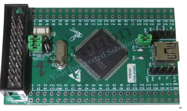

So the cpu board look like this, minimal components:
cpu
cpu
I have changed xtal to the 8Mhz that the zombieverter vcu use. (took me a while to realize that i had to flash Hubners bootloader, not just the zombieverter program to get everything to work :)

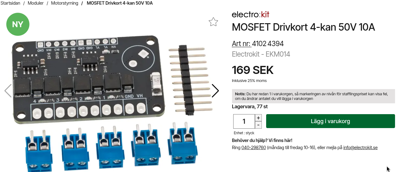

And I got a mosFET board to control the contactors:
mosfet
mosfet
