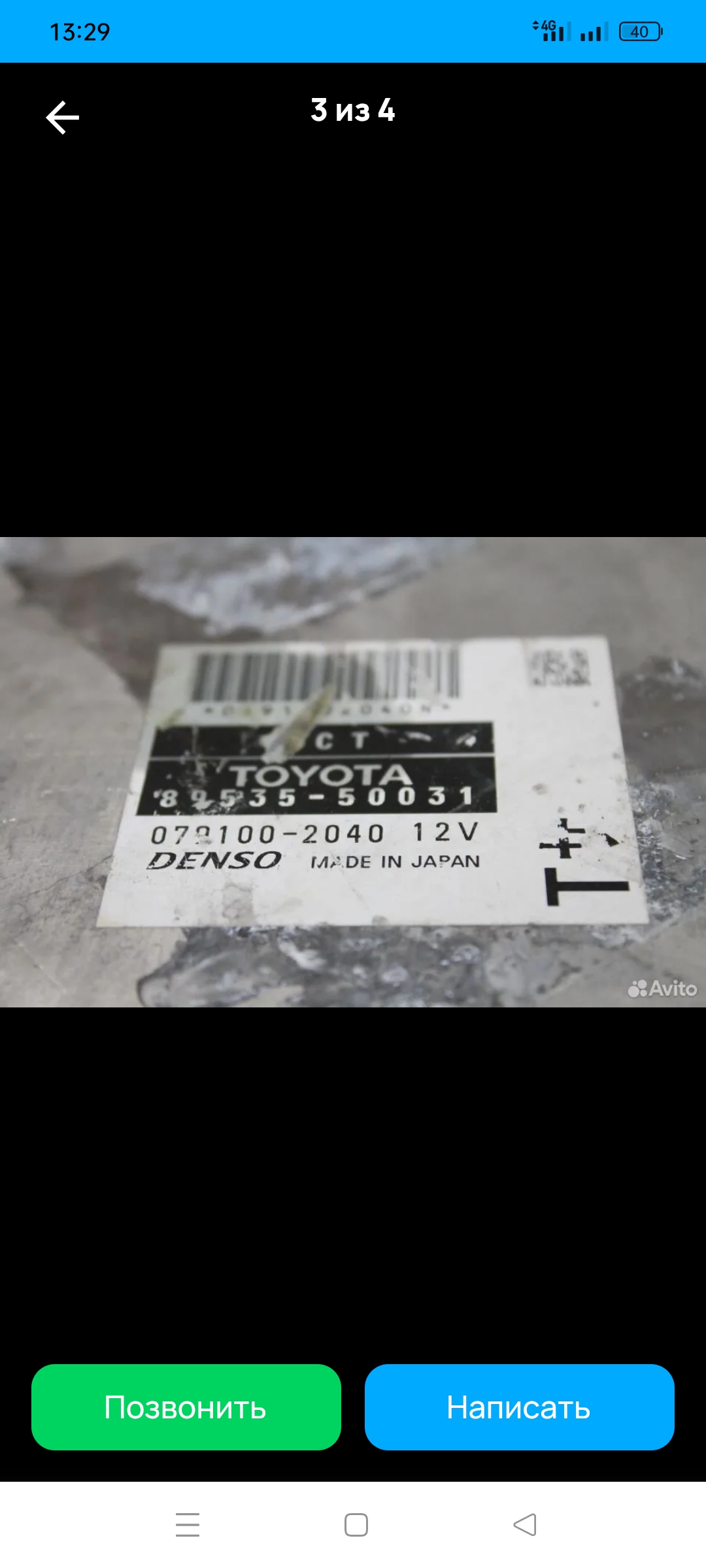

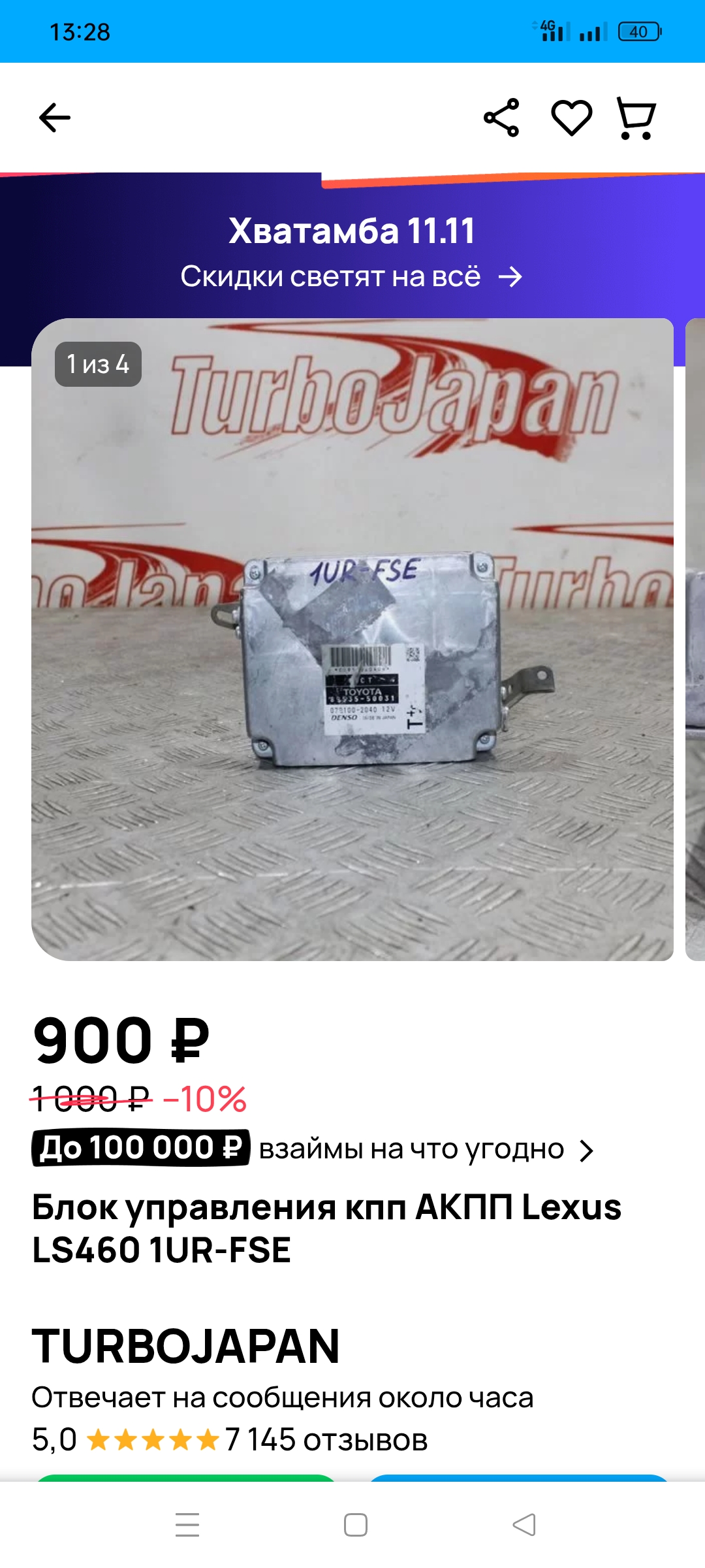

Hi everyone. I stumbled upon this forum by pure chance. Where I'm from, electric traction and information about new cars aren't as widespread.
Given the sanctions, I don't know how people will receive me here; I'm from Russia, Siberia.
I'm interested in either manufacturing an AA80E/AA80F automatic transmission control unit.
Or controlling the stock control unit via the CAN bus from this car.
The main problem is that I need to swap the 1UR-FSE engine to a different chassis. The engine is already running on a third-party ECU without the CAN bus.
I don't want to install a manual transmission.

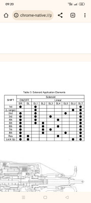

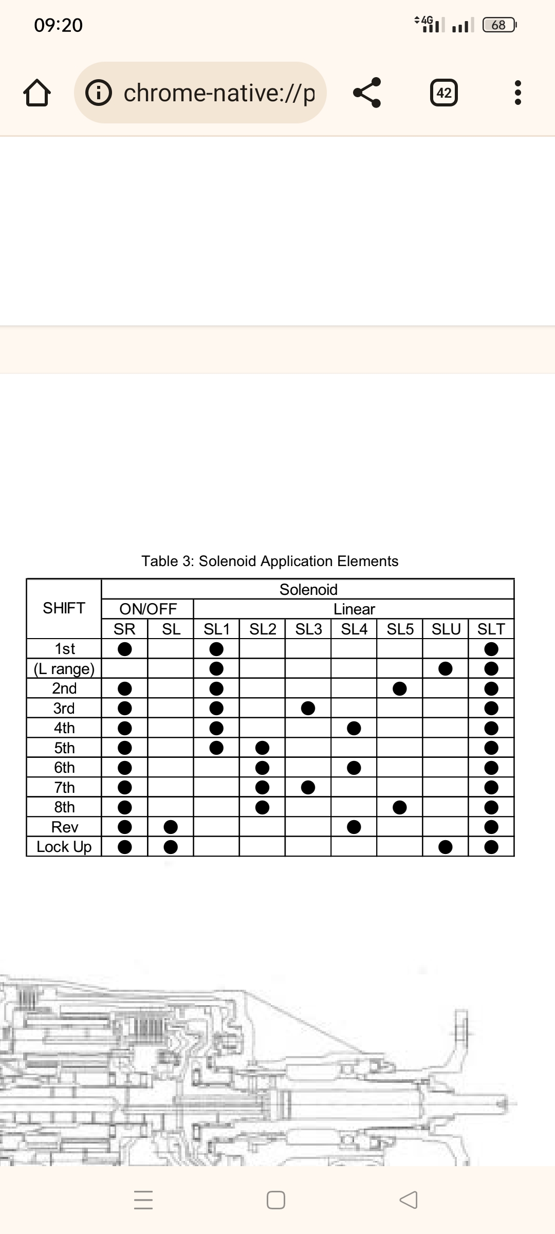

Does anyone have a CAN-BUS analyzer for Lexus/Toyota?
I posted a thread on the OEM forum.
I have a stock automatic transmission unit. Perhaps it needs to be fed RPM, engine load, and ABS speed information, and it will shift gears 1-8.
