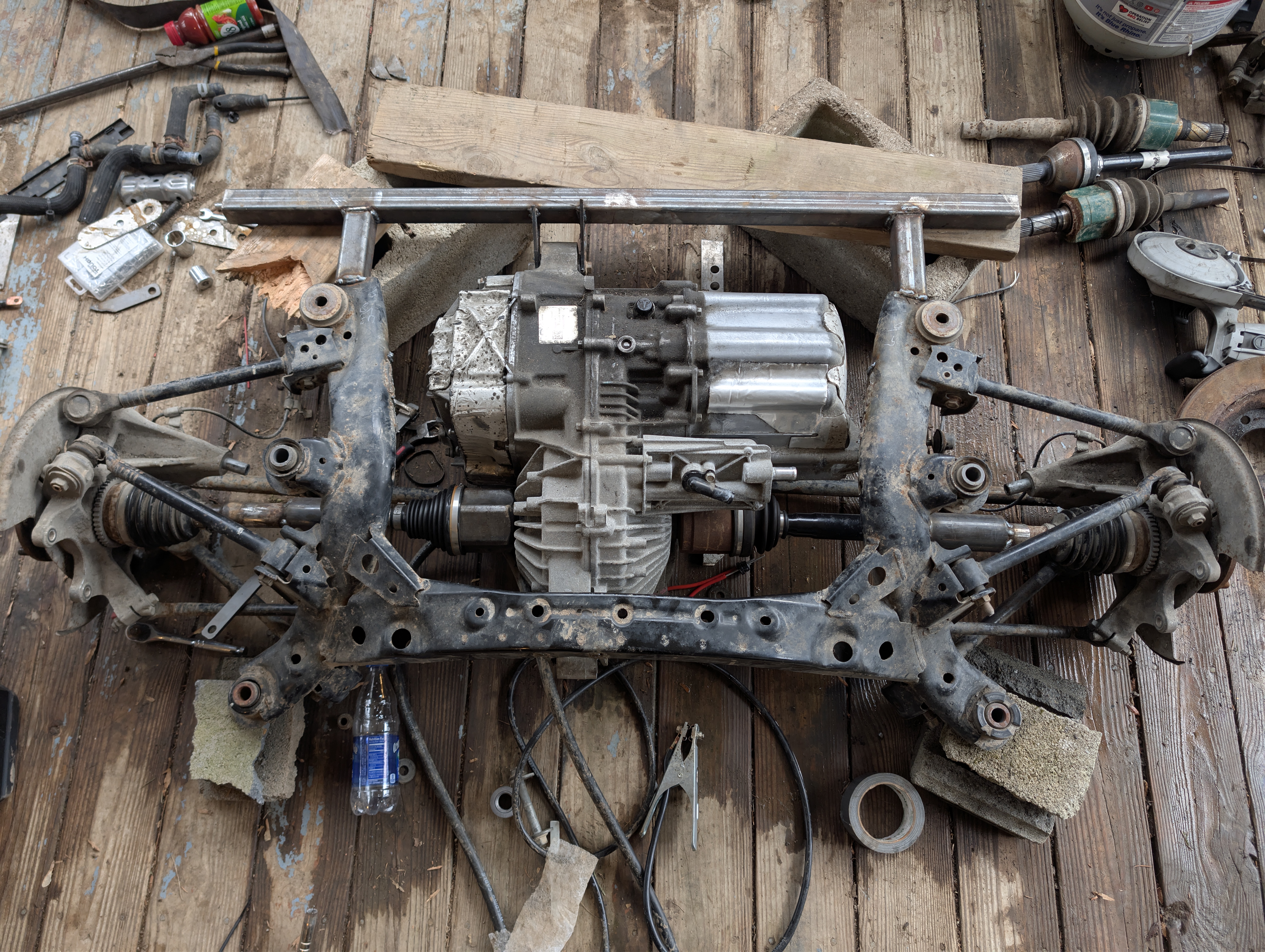

nearly 7 years ago i started a conversion on a Mazda rx8 to electric using a 2015 Toyota Avalon hybrid transaxle and two Prius prime lithium battery's. over the years came a new job which caused less time to work on the project, a LLC I've started for electric car conversions. well update for the past year i had zero testing on the EX-8 and started work on my hybrid diesel system using kia 2015 optima hybrid MSG for use on charging/driving the car using diesel as a limited range extender. this quest involved tons of hours of testing, destroying several prius 3rd gen inverters due to my mis connections of the battery power input. now with proper wiring harnesses for the msg's and prius inverters im planning on using one for the charging of the hybrid battery. full two prius prime hybrid packs at the nominal voltage of 360 and i think the cells tested at or around 25ah from 4.10 down to 3.35. running both pack together will give us roughly 16kwh 360 volts. now to present day work i found a cheap tesla SDU at a local junk yard from a totaled tesla. im posting a update to the current tesla sdu and mazda rear subframe. also would like to note that my old youtube channel wont have as many updates on this project and since the LLC creation im using a new Channel AppalachianEV with the videos of this project car. Big thanks to a few members of the fourm on helping with the control board. Will be posting a video soon.

link to the test video. glad to see it spin. although the web interface says its in reverse but the rotation is correct for the motor and mazda to be driven forward. unless i missed a picture where the motor is turned the other way.
