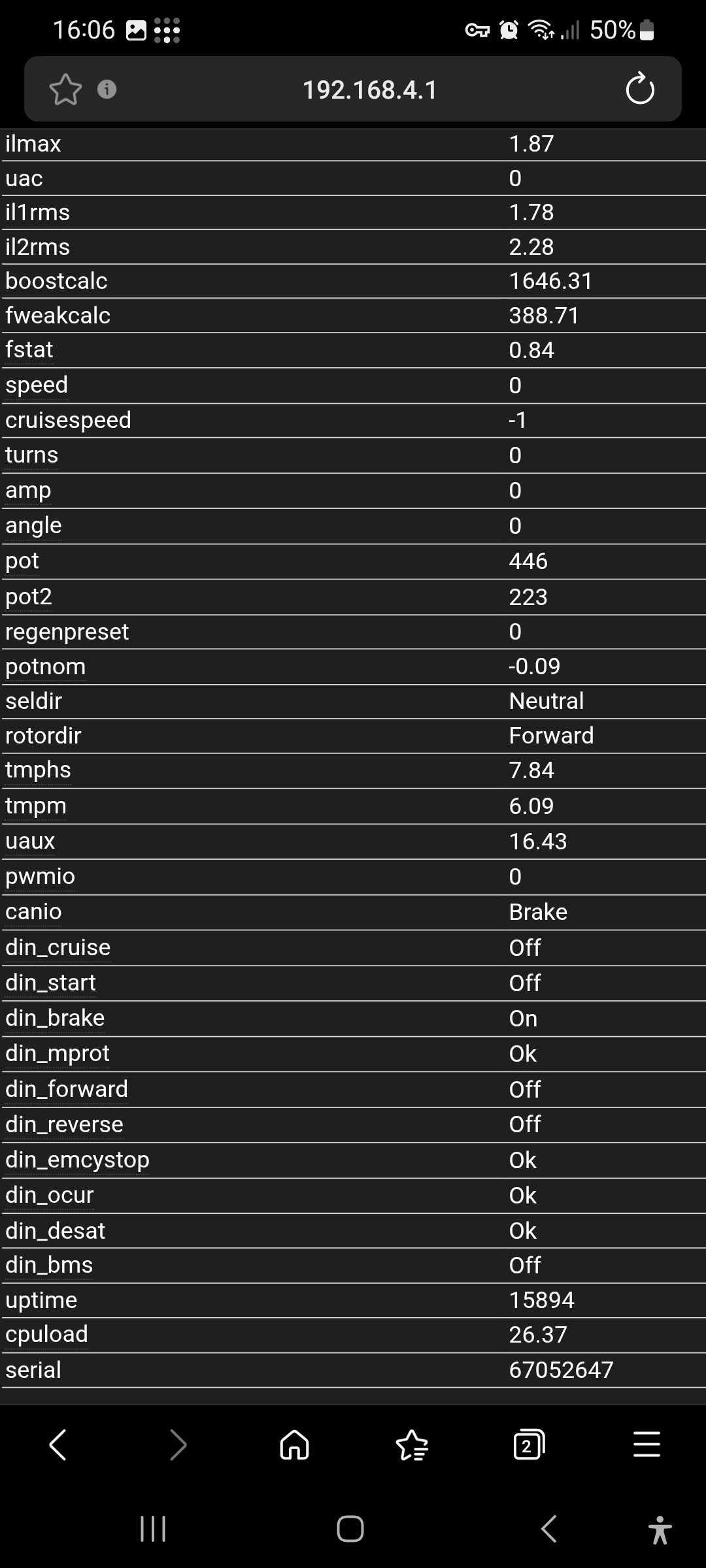

Hi, I have a problem with the Drive direction from the VCU to the LDU. The VCU clearly shows that the Drive direction is changing, but this isn't being passed to the LDU. Do I need to specify this in the canmapper? It should normally work without it. VCU version 2.30, LDU version 5.39

What is the value of canio, seldir and the respective din_ spot values?

Pot1 and Pot2 are sent normally from the VCU to the LDU, as are the brake and start signals; only the drive direction remains at 0 and does not react at all.

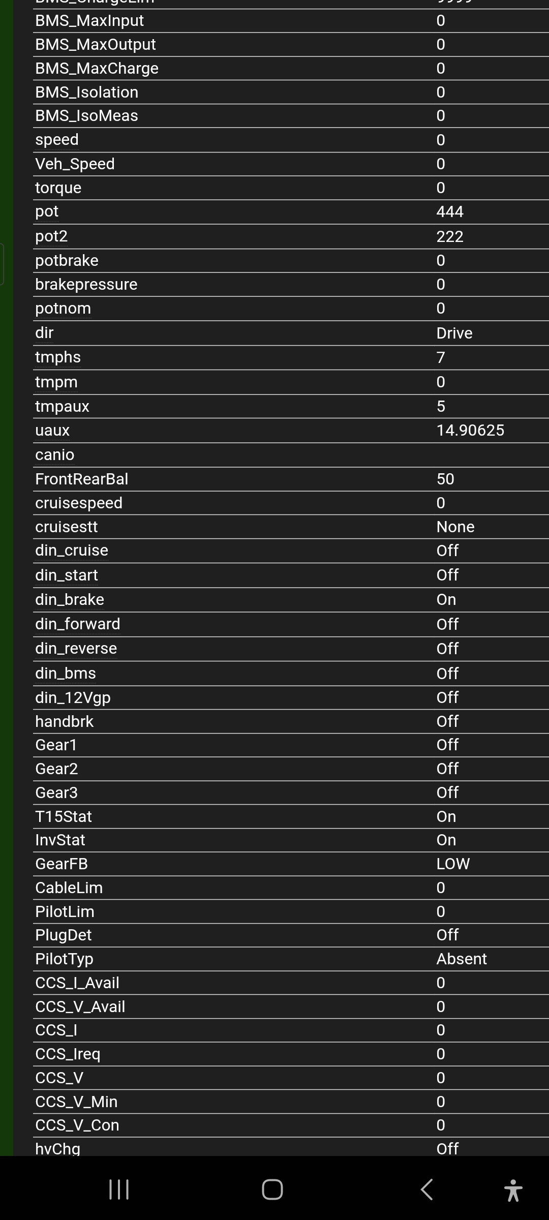

LDU VCU with the car in forward gear and the brake pedal pressed down.
- Been thanked: 1913 times
Re: Change of direction handed over to LDU?
ah!
ok, canio, which is the unprocessed value received over CAN just receives Brake. So for some reason Zombie is not turning on any direction bit.
Does it behave differently when downgrading inverter firmware?
edit: on Zombie din_forward is Off as well

I'll test it right away with version 5.35; yes, no signal is coming from the VCU via CAN for drive direction, only brake, start, and accelerator pedal are transmitted.
edit: i test it, The same applies to the downgrade; it can only be due to the VCU.

Does the gear inputs change on de vcu spot values?

Take a look at the screenshots above, and maybe read all the posts as well.
