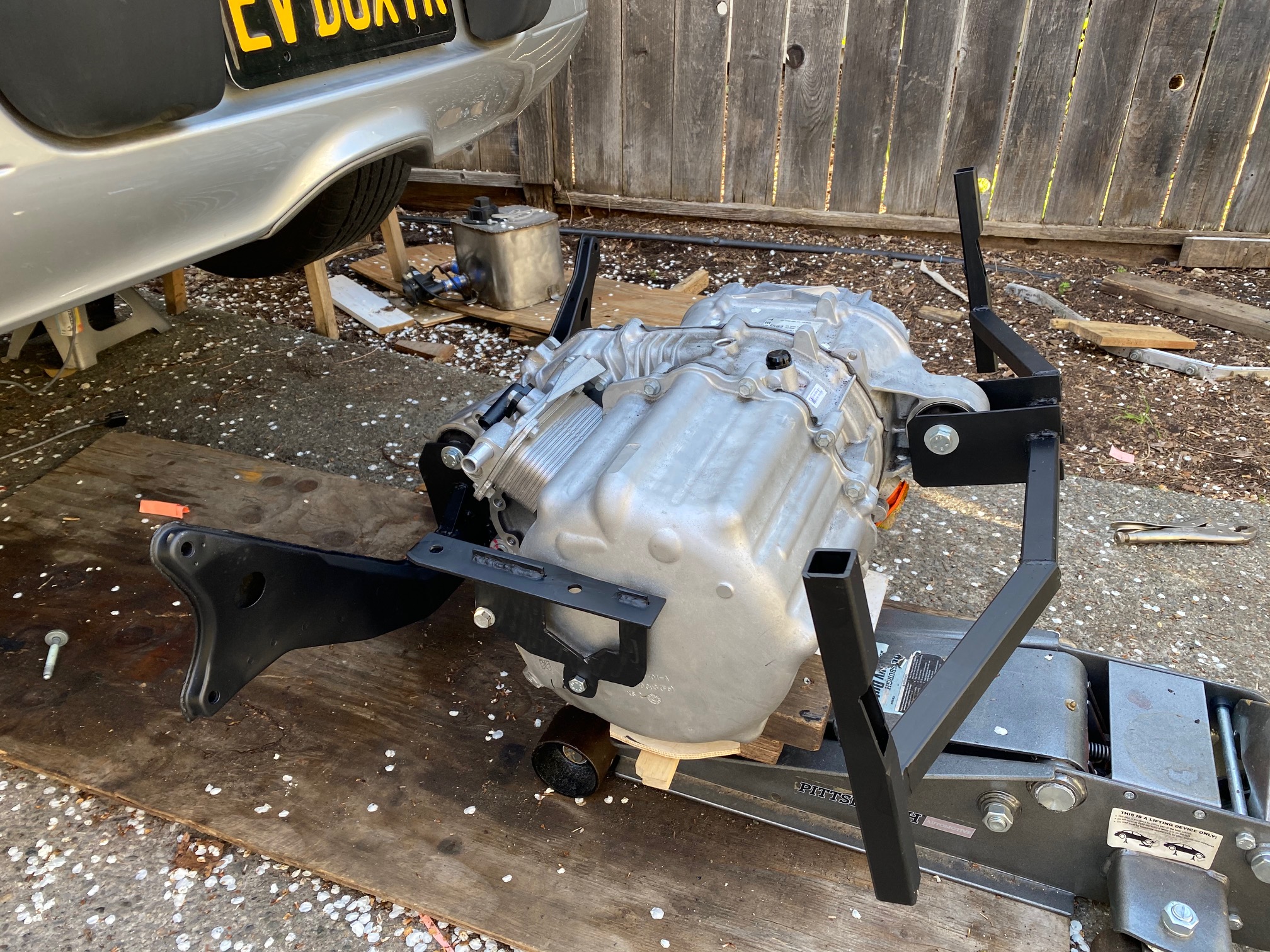

Hi all,
I thought I'd start a project thread as my car is nearing completion.
It's a 2000 Boxster S in a very nice silver color. The usual IMS bearing issue destroyed the motor so my dad and I were able to get it for $3500.
First version used a Siemens 1PV5135 of the same sort that Damien has, along with the Azure Dynamics DMOC645. The battery pack was a complete Leaf system, using the Leaf BMS and an Arduino for voltage monitoring. I also had CHAdeMO working sometimes, but didn't fully test it beyond a simple communications test.
Drivetrain is clutchless through the 6-speed manual.
Unfortunately the DMOC is a terrible inverter; it had low power limits, strange overtemperature issues, and was generally problematic. And the Leaf batteries turned out to give about half of their rated capacity, resulting in 35-mile range.
So both a new battery pack and new inverter were in order. This was before the Prius inverters were well documented, so I decided to install a Huebner inverter kit into the DMOC.
Version II is getting close to drivability. Yesterday I finished installing the batteries, 12 of the LG Chem Pacifica modules for 32Kwh and 360v. This should give a range of about 100 miles, and only 50 or so is needed for my daily commute to school (which is cancelled these days due to COVID).
Pictures are coming soon.

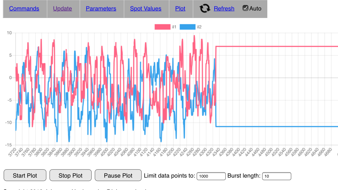

I am currently struggling with the inverter and motor.
Voltage and current sensors are working correctly; pedals are calibrated and potnom follows the pedal nicely.
The encoder also seems to work right.
However, the motor will not budge until potnom reaches 65. (I believe this is exact).
And when potnom does reach 65, the motor shakes for a second or two and then shuts off due to overcurrent.
I've been logging different variables and the 'amp' variable does not change until potnom reaches 65. 'ampmin' is set to 10, which is default.
There does not seem to be any derating happening.
I'm stumped. Any ideas?
Thanks!
-Isaac
[Parameter file is attached; firmware is 4.76]

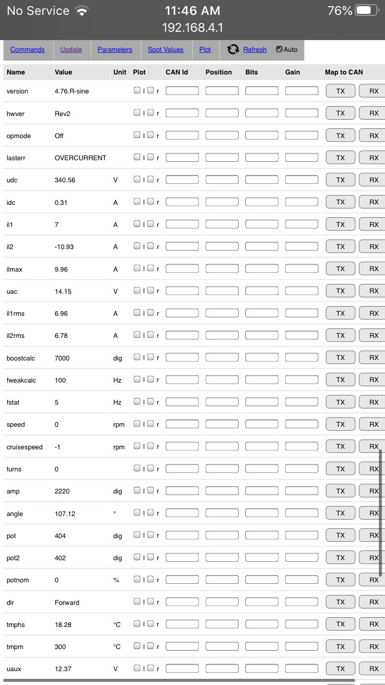

Isaac96
- Posts: 656
Re: Porsche Boxster with Siemens and DMOC
Yes the wheels are in the air.
I just reversed the encoder wires and behavior was exactly the same.
AB encoder is selected.
Turns out I was on the 4.73 sine release. Updated to 4.76 and there was no change.
I changed the slipstart setting to 10. As a result the motor turned on and hit overcurrent at 30% potnom.
I am also logging amp to see what the inverter is outputting. It stays zero until the 60% potnom, then jumps to 4000 or so when the motor does its 'turn on and die' act.
So it seems that the inverter is being prevented from outputting any current until potnom hits 60% -- and then the current gets dumped all at once! Could this be linked to derating? I have no errors besides the overcurrent. And the motor and heatsink temperatures are within the normal range.
Still stuck!

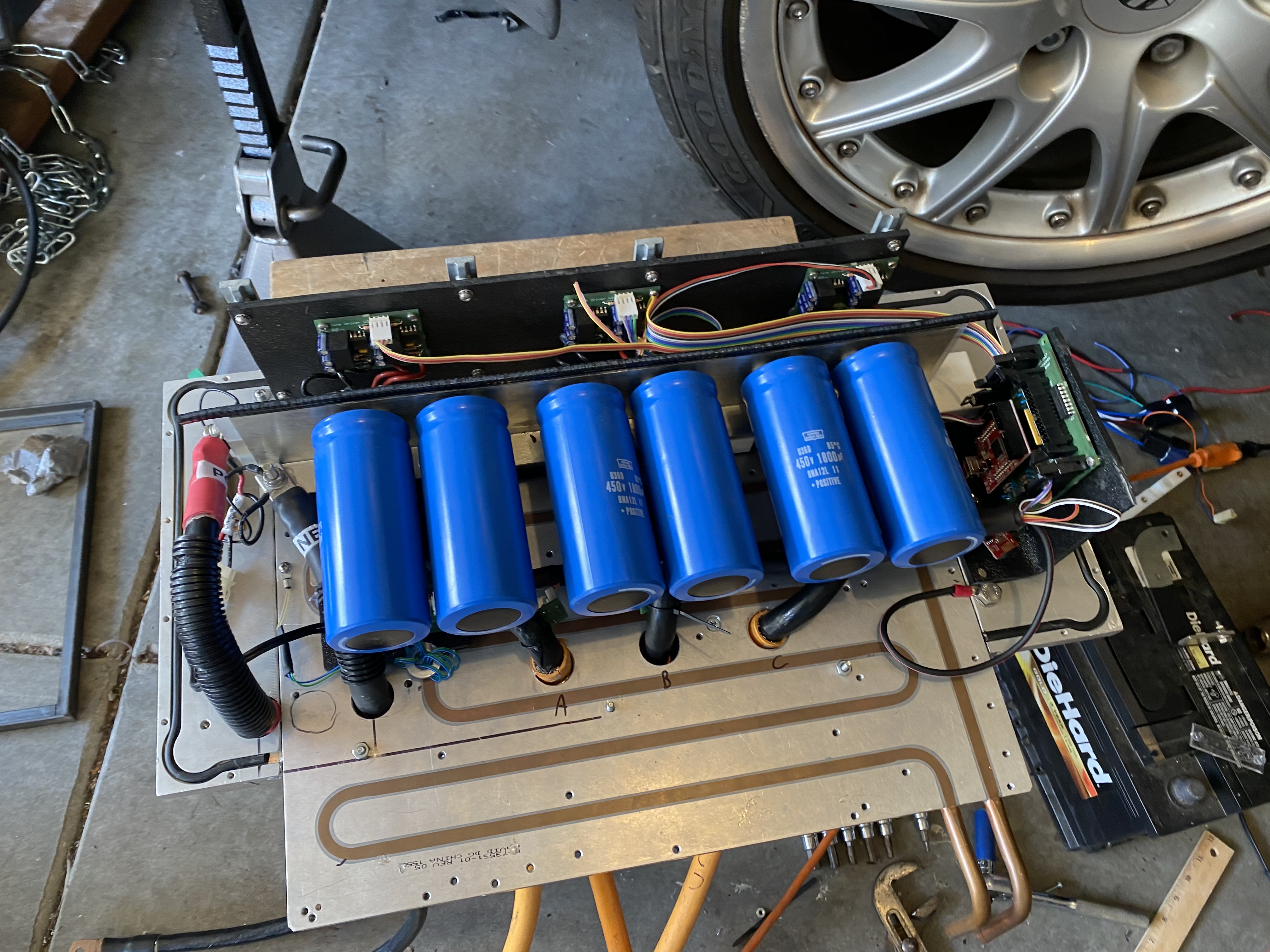

Isaac96
- Posts: 656
Good morning - stayed up late trying to get it working, still no luck.
My encoder is 64ppr.
Main bus voltage is 360v; Damien used boost of 3600 with a higher voltage. Should I just set it higher? Would that cause any problem besides maybe some inefficiency?
I will try manual mode soon when it's warmer out in the garage.
Thanks!
-Isaac

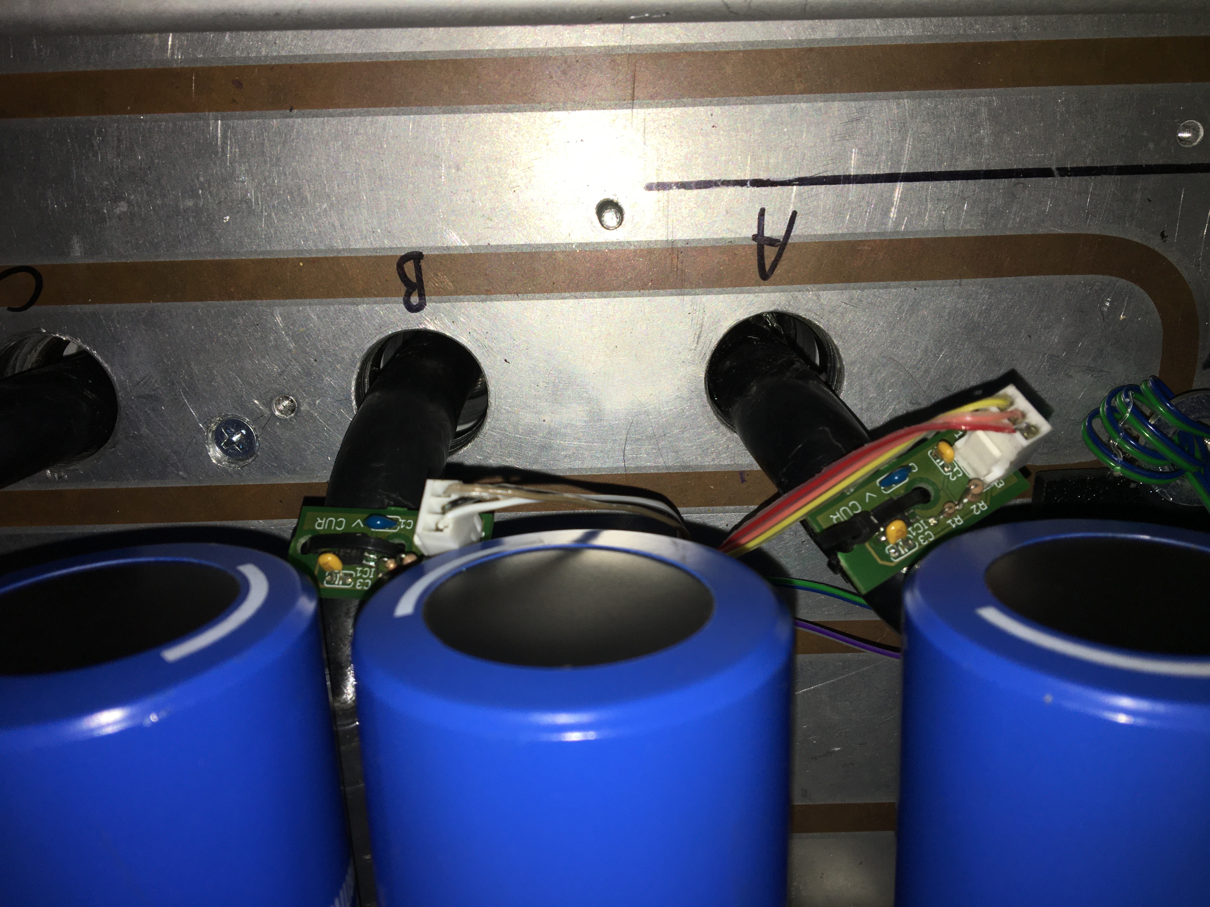

Hi
Did you calibrate current sensors? Which ones do you use?
https://openinverter.org/wiki/Schematic ... sor_boards
Hm... which board version are you using? If you have R2 board with sensor board that gathers current sensor, voltage and temperature data in one board you might have entered POSITIVE OClimit value, whereas you should be using NEGATIVE, so eg. -800A! Verify this first. I am not sure how new firmware handles this now.
WARNING! You are using seriously short deadtime. I recommend you set it to 160! I dont know what kind of drivers you use, but it is allways good to have more blank spoace between signals for testing.
Also make this parameters 200 for testing.
"iacmax": 5000,
"idcmax": 5000,
"idcmin": -5000,
"iacmax": 5000,
"idcmax": 5000,
"idcmin": -5000,
Isaac96
- Posts: 656
I just recalibrated current sensors - ended up with the same gain settings.
Will try reversing the sign on ocurlim. From previous testing I think the sign is correct already, as negative ocurlim changes the PWM output from the STM32 which drives the overcurrent comparators.
I'm using the drivers from the Rev2 kit; previously when I scoped the IGBT outputs the deadtime seemed sufficient (but I'm not much of a scope user).
Will increase deadtime and see how it does.

Can you plot measured currents and a picture of your setup? Can you measure actual phase current with a clamp meter?
Isaac96
- Posts: 656
Yup, I've got a clamp meter. I'll try to plot reported current vs actual phase current - the phase wires are a little tough to get to.
I'll have to do all this tomorrow though.
This is the inverter: It is now installed in the trunk of the car.
I can get more pics tomorrow when there is more light if that is necessary.
Thanks!
- Been thanked: 1918 times
Maybe you could rotate the sensors on the cable so they point outwards, away from the power modules. Ideally while observing their value.

I rotated the sensors and recalibrated. Gain was slightly lower. Still the same overcurrent tripping though...
I put a clamp meter on the phase wires and measured ac current. At ampnom = 25 the ac current was 3.6A. And at ampnom = 26 the overcurrent tripped.
Should I try disconnecting the sensors altogether? Or setting gain very high?
I also have some LEM HAS sensors that I sorta planned to install once I had the inverter going. Would those be more immune to noise in the signal lines?

EDIT Here is a plot of il1 and il2, as well as a screenshot of values at the point where overcurrent hit.
