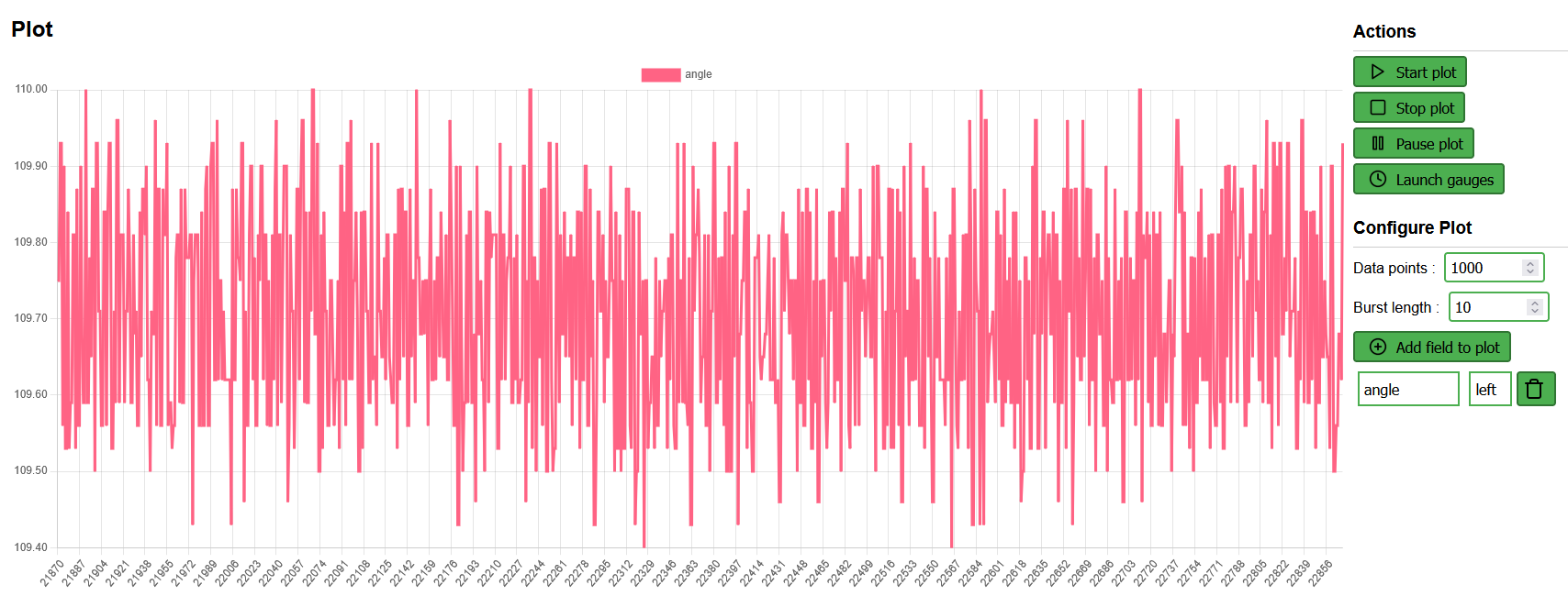

Trolling for suggestions I guess. I verified and re-verified all my wiring (resolver etc) and I can run the blinky test and motor in SINE firmware just fine, but 100% no joy with FOC. This leads me to think there is something in the resolver circuit or inverter pinswap (5 for Gen2 Prius), or.... an unholy combination of the two that is causing it not to tune, but after stepping back for a few days and re-tracing my steps, I am no further along.

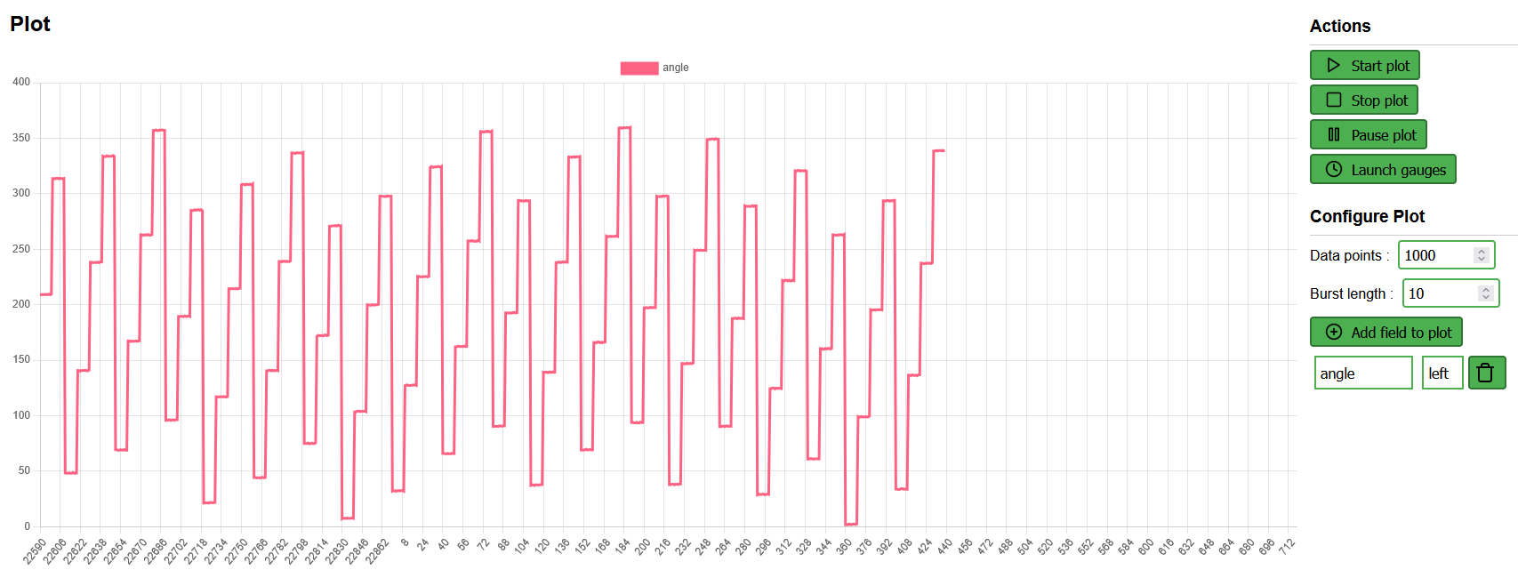

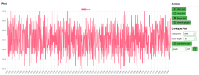

Update, I *think* I found at least part of the problem. When I checked jitter again, I found it to be nearly 360* :shock:
I then power cycled the VCU and inverter and rechecked, jitter now <1* and was like WTF!?!?!?! :? After another Run, jitter back to well over 300* and that ain't gonna work.
Any ideas on why jitter would change like that? All metal bits are earthed together, resolver wires are twisted (untwisted resulted in jitter over 5* which I fixed way back in testing).
&lt;1* jitter in Run before throttle applied
<1* jitter in Run before throttle applied
360* jitter in Run after throttle applied &amp; released
360* jitter in Run after throttle applied & released

But both plots are from 0 motor volts, the only difference is what throttle applied fist or not.

:oops: Update: A self-inflicted situation is the short answer. :oops:
How/why? Well, see when you move from one procedure to another and do not completely restart from "0", things get missed. I am betting there are a few here who have done this, damned sure I have a time or two.
So what happened? In step 4 (based on my notes) of the "FOC Tuning" video, Damien admonishes everyone to use the plot function to check for 360* of rotation and measure the resolver signal for jitter "< 5* is ok, < 2* is better). Turns out this was at least my THIRD round of attempting the tune procedure and I HAD LEFT the FWD pin PULLED HIGH! The FWD wire was hiding behind the VCU and connected to a 12v source. So when I went troubleshooting, I found the grossly excessive jitter and lost two days due to wheel spinning.
MAKE SURE none of your direction wiring is pulled high when checking your resolver signals! :oops:
To be perfectly clear, I had carefully checked the resolver signal and rotation TWICE before ever attempting to power the motor and had not changed anything in the wiring since then.
