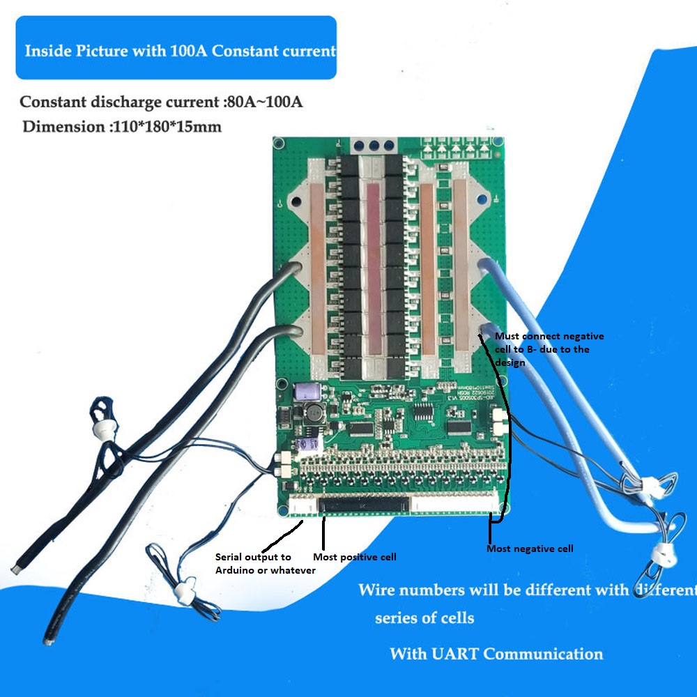

Re: About New Tesla Model 3 Battery Pack. 2170 Cell.
Here's a beautifully annotated image:
I'm in the north bay area, napa county. We could probably meet up and discuss this once the shelter in place orders are over (if they are ever over).
I can help you with hardware and software to communicate with the BMS.
What charger are you planning on using?
