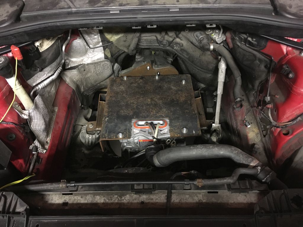

Here is first trial to made motor holder. Fits in original gas motor handle

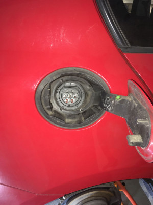

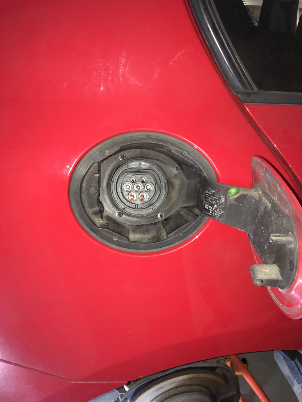

Like I said, I used V60 socket. Fits under original filling cover and have 3 color status LED - Later I want to connect them

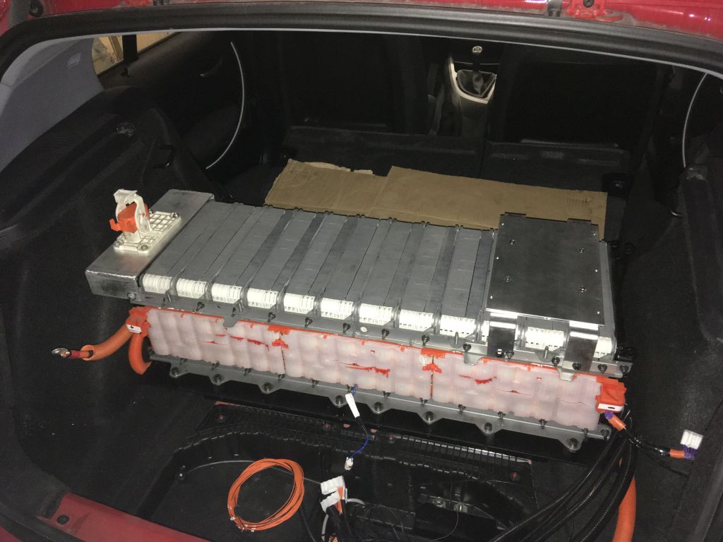

Trunk packet - 24 cells (in fact 48) - original from Leaf battery fits perfect.
On left side is fuse holder and on right side will be Orion BMS on top.

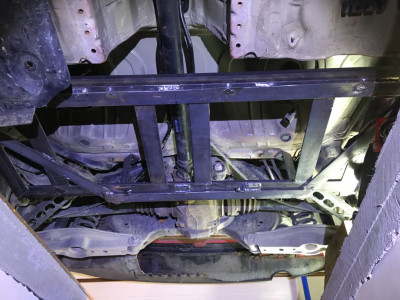

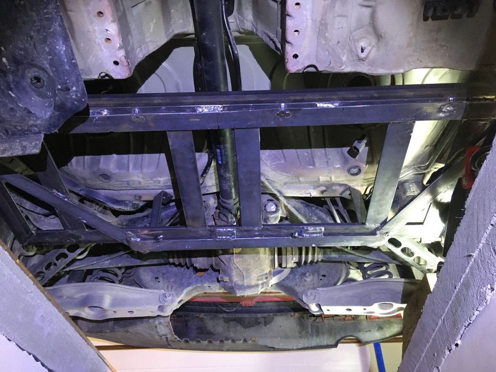

Underbody pack where was tank. Of course BMW can't do regular form, so was not so easy to discover how to put this on original bolts.

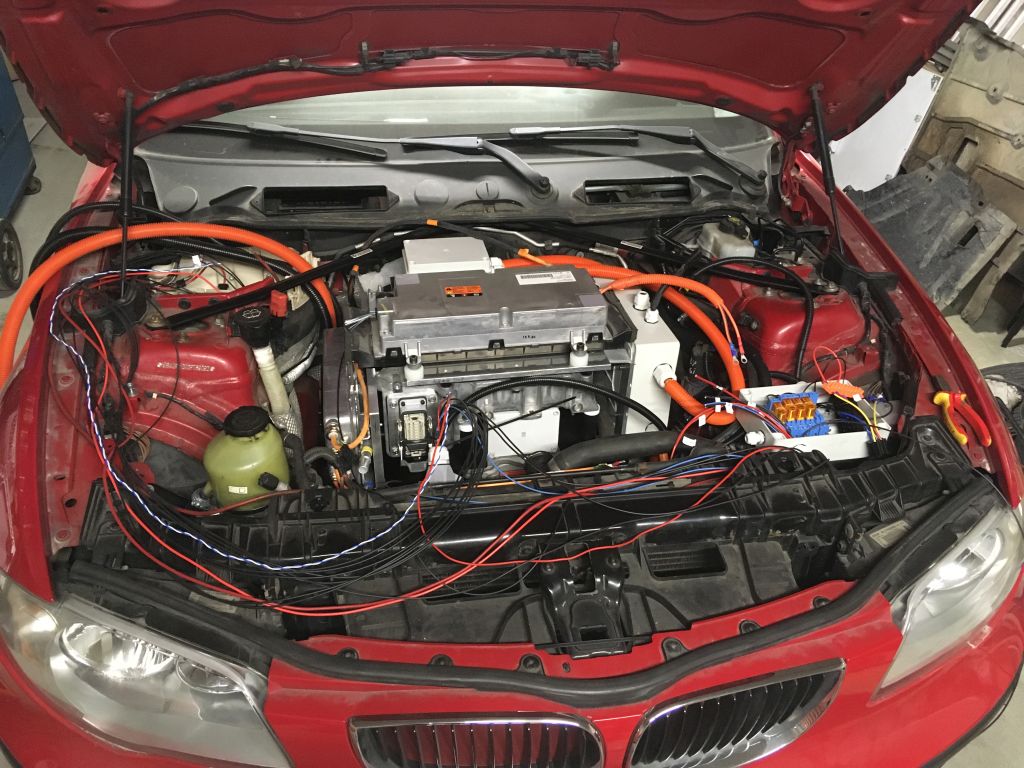

After some weeks on trials with spline, coupler, trials with parameters and CAN control, was time to do harness.
My CAN setup now is now divided:
CAN1: BMW (throttle, brake, instrument cluster, etc) -inverter
CAN2: OrionBMS, charger, DCDC
I will try to put everything in one CAN, if will be no problem with communication, I will left like this.

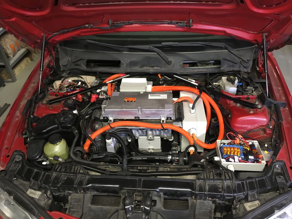

Now looks like this. Better but still needs some works, covers and DCDC cooling. I will use original motor cover, where was air intake to filter. Will be driven to DCDC, should be enough, I hope.

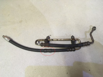

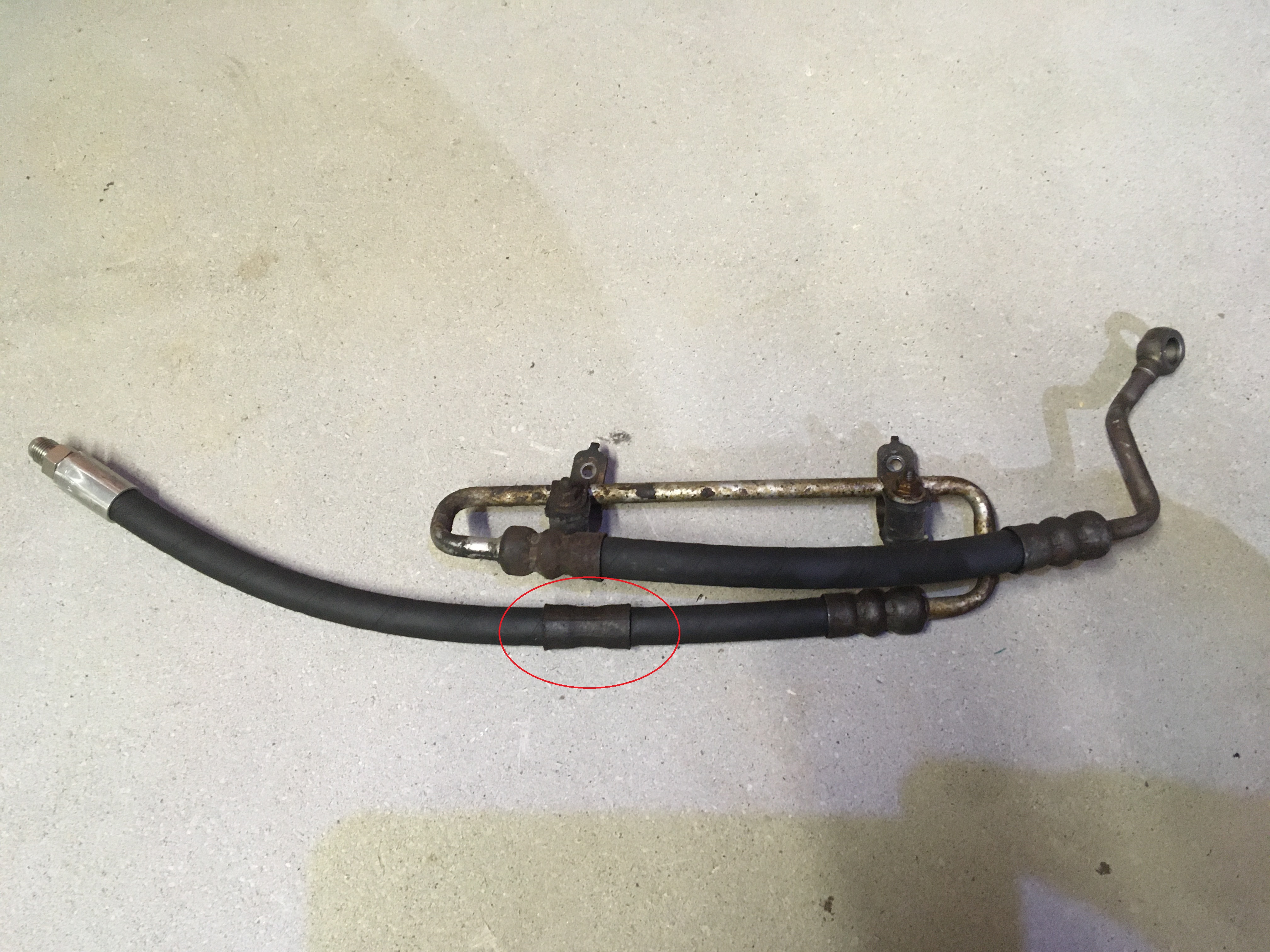

Like probably everyone here I used TRW pump. Mine was used in Opel Astra. Original powersteering in my E87 was driven by belt, so I left everything like was previously and replaced tubing for right length and connectors. I used standard hydraulic tube for max. 300 bar.
On picture below is visible tube with modified last connector. Good that guy, who crimped connector for me told me, that element selected on picture it is not normal connector, because I want to cut this :) This is one side valve and similar is on the return pipe. Without this You will feel jerking during steering.

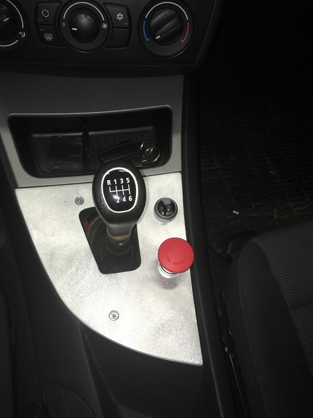

When I had a little more time to be an metal artist :) I did new cover for gear selector. Now is clear alu plate, but later I will anodize this. Small upper selector is for REV/FWD select. For now I did trial on second and third gear. On second probably I will go all the time in city and I feel that 3 will be used on highway, nothing else will be not necessary. What I tried, that on second gear and 3/4 throttle pressed I had current on DC side about 230A peak visible on Torque App with Orion BMS current sensor + OBD2 bluetooth dongle.
Can I go more?
Zapatero - this is question to You, because I want to have not worst acceleration time than You ;)
For now when I will press Emergency button 12V and DC power relay to inverter will open. I hope this solution can't damage IGBT, what do You think?

damian.lo wrote: Sun May 03, 2020 7:25 pm For now when I will press Emergency button 12V and DC power relay to inverter will open. I hope this solution can't damage IGBT, what do You think?
I've read on these forums (don't remember where) that interrupting power to the contactors can damage the IGBTs if the motor is spinning. This is because a permanent magnet motor does not require excitation current to produce power.
Could you wire the emergency stop to the EMCYSTOP input on the inverter controller? That would shut down PWM without risk of breaking IGBTs.

This wrote Arber, even was speaking with me :)
I was thinking about this - what You wrote. My emergency input is connected via interface board to Leaf inverter directly so I hadn't this pin available. I don't know what Johannes thinks about this - original inverter is somehow secured itself? What do You think?

Can you use your Emgcy button to just suspend pwm inside VCU? Is there an option?
Your DMW inspector will probably demand that a push of red button requires two separate actions to put vehicle in use again, not just one move of button.

I remember, that on Rev2 board emergency signal was available to use. In v3 board + leaf interface board there isn't this pin free for use. I have to look at schematic where Johannes connected this.
Maybe in fact better will be to leave contactor on and only shut down +12V to inverter or take off emergency signal inside of inverter. This is the worst if I'm thinking about one more time take out all of the stuff :)

I don't know if You saw how is mine DCDC under hood. Mine is transverse to the direction of travel, so possible water can't go directly to inlets. I will now let it like is, but according to Your cooling, maybe will be not necessary to put additional fans. Maybe car movement will be enough to cool it.
So, today I corrected power to inverter and tomorrow relay to cut direction lines and hope it will be for now enough.

I have to report that DCDC is getting quite hot if you dont provide cooling. Eventually it shuts itself down. I tried to mount two 12V fans to cool it down, but they only proivide some 1000RPM. I think i would need 3000rpm to adequatly cool DCDC!
Also i will rotate it so fins will face inwards from the sheet metal because they need airflow.
