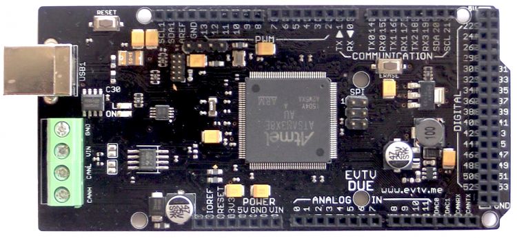

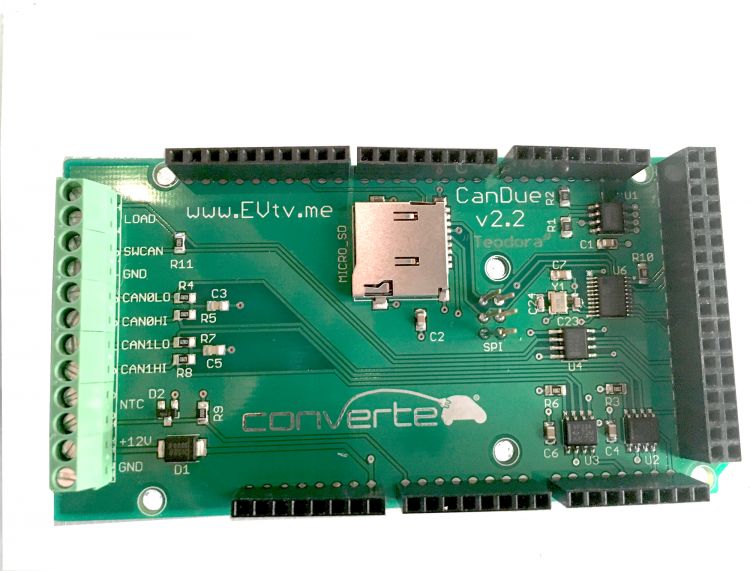

I absolutely love this thread, and just happened to get off the telephone with Richard from EVTV, we had words about their CAN Tools I specifically asked what is the difference between their EVTVDue Microcontroller and their 1 CANKIT - CANbus kit with Microcontroller and Cable and was told to sum up my questions and email them to them, and he would pass them on to their CAN expert.
Note To Self: Sum up my questions and email them to info@evtv.me, for Richard to pass them on to their CAN expert.
Why did I call them? What is it that I am trying to do? Well simply put I am trying to learn CAN. I bought a Chevy Volt first gen DC-DC Converter and want to learn how to communicate with it and eventually control it.

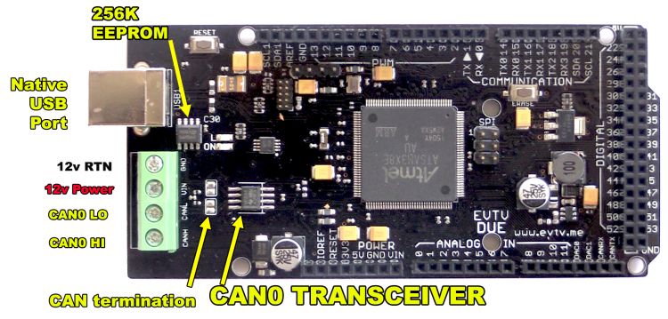

EVTVDue Microcontroller 1 CANKIT - CANbus kit with Microcontroller and Cable
Price: $99.95Price: $149.00
Manual dated: June 2015 Manual dated: September 2017
This single board replaces the fragile micro USB connectors with a single strong Mini-B printer style USB port on the native USB port to the microcontroller.
added a 2Mbit EEPROM chip providing 256 Kbytes of persistent memory to save program data or configuration details.
AND most importantly, a Texas Instruments CAN transceiver on the board to enable the CAN controller in the SAM3X microcontroller chip allowing direct CAN communications.
This card features TWO CAN channels along with the transcievers to enable them - tied to the CAN controller pins on the Due.
Additionally, it provides a Single Wire CAN channel with connections for any load resistor for the circuit.
includes a 2 Megabit EEPROM chip - 256kbytes of storage for persistent variables or pixel data.
includes a microSD card slot to hold up to 128GB of removable memory for logging data.
Convenient screw terminal connections allow you to tap into the vehicle 12v and chassis ground to power the entire rig of multicontroller and CAN bus board. It also can read and write CAN messages to your vehicle OBDII CAN bus.

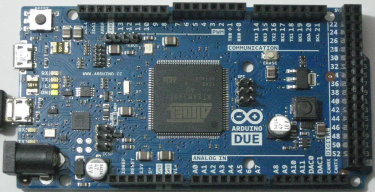

includes the generic multicontroller board itself - a clone of the Arduino Due board.
includes a single analog channel with resistor for reading Negative Temperature Coefficient NTC thermistors to calculate temperature.
