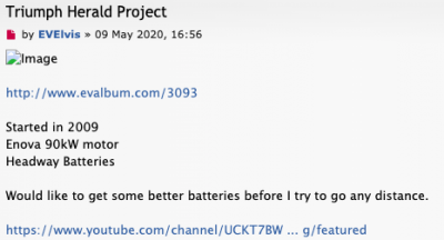

Please post your images direct to this forum and not via a third party hosting site. They often do not display correctly or get removed which breaks our forum (see screenshot).
Please also add your location so that we know where in the world you're based :)
