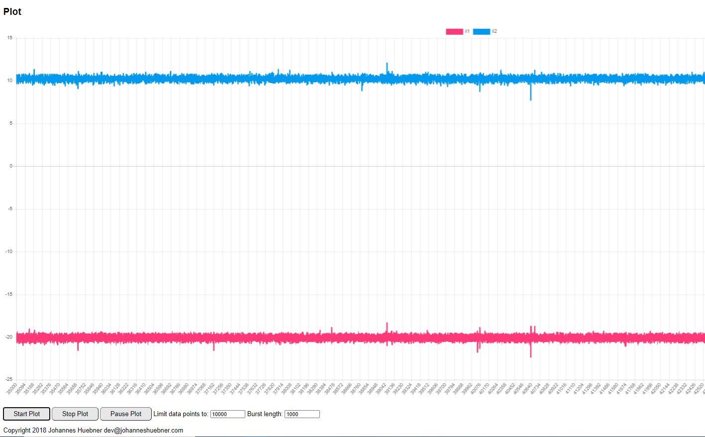

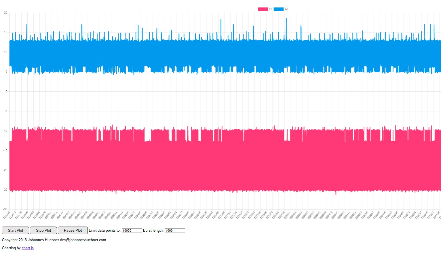

Re: Outlander front motor + Prius Gen 3 inverter
When setting up this motor I found the default value of 20000 for the current control integral gain 'curki' was far too high for this motor. With 20A of manual ID the plot shows very poor current control. It still spun fine but I could hear a white noise while the motor was running, especially noticeable at low speeds/frequency. As you would expect, this lack of control is more prominent at higher voltages (>300v).
I reduced curki to around 3000 and that improved the control greatly. Any lower didn't make a lot of difference.
I am using MG1 output so there may be a difference or reason for it there but I am also interested to see what parameters everyone else is using and to compare. My next steps will be to swap this motor over to MG2 output (and the lexus MGR to MG1) just to confirm that isnt the cause, and also do some higher speed plots. I suspect at higher speeds/frequency the integral gain will have less of an impact so it doesn't matter as much.
