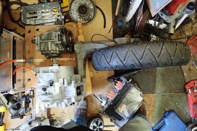

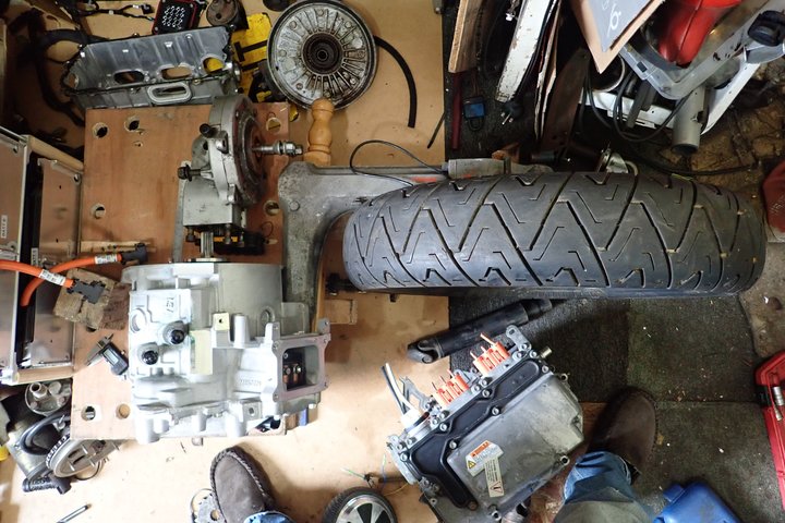

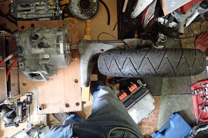

I've kind of settled on the BMW K series swing arm and beval drive as they are available in a range of ratios and are reasonably plentiful on the 2nd hand market but I'll be needing a further reduction before this.
First idea simply connecting to the drive shaft. Max reduction from available ratios is 3.36:1 which gives a max wheel speed at max rpm of about 202mph using 9000rpm as a maximum for the outlander motor. This is clearly ridiculous. Only the lowest rpm from the motor is usable and the toque to the rear wheel is heavily compromised by the high gearing.
Second idea using two final drives in succession. lowest reduction is 2.82 X 2.82 = 7.95 and a max wheel speed of about 86 mph which is lower than I'd like it, not that I'm a speed freak but being able to hit 100mph would be good plus I'm guessing having the motor near max rpm in normal use will compromise available torque as the motor will be tapering off at this speed.
Third idea is using a reduction of 1.59 from an Audi TT transfer box. 1.59 X 3.36 = 5.34 and a max wheel speed of about 130mph, which again is still a bit high but closer to what I'm aiming for.
Ideally I want a max speed to be around 100mph for best acceleration and lower gearing but not so low the torque of the motor will be tapering off as it reaches max rpm during normal road use. This I think needs a ratio of about 6:1 which I can get using a reduction of 2:1 followed by the bevel drive of the swing arm of 3:0:1
Mind you it's mostly guess work at this stage so please chip in if I've made any really bad assumptions.

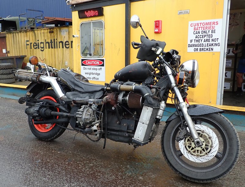

Understood about weight but the current bike has a VW 1900cc TDI engine and car gearbox in it and is a real heavy weight. I could probably use all 8 battery modules and be of comparable weight ;)

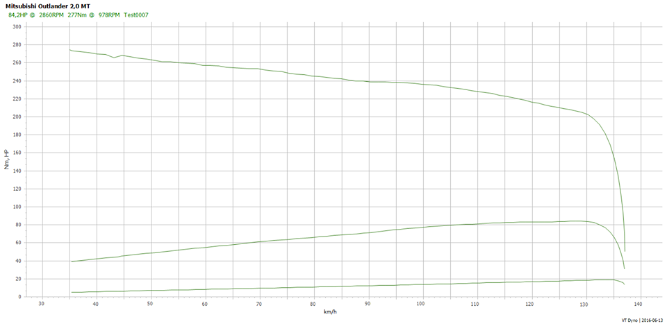

I've just had a closer look at this dyno graph tucked away in another thread here and it lists the torque as starting at 277nm and dropping to 195nm max ev speed of 135kph, 84mph. The rpm on this graph is clearly garbage and I've compensated for that using the standard issue wheel diameter and transaxle reduction gear to 277nm @ 1780rpm and 195nm @ 6870rpm. This is consistent with the max rpm of the motor of ~9000rpm and the max speed of the outlander listed as 110mph.
Not sure how seriously to take the torque readings from this source as they are selling a performance enhancing module and probably prone to exaggerating.
We need pics or something :shock:

jap wrote: Fri Jul 24, 2020 11:59 am [We need pics or something :shock:
You might need a stiff drink after seeing this ;)
I've done a talk about it at a hacker camp and recently done a walk around video if you're interested.

I think my first car was lighter 😂
