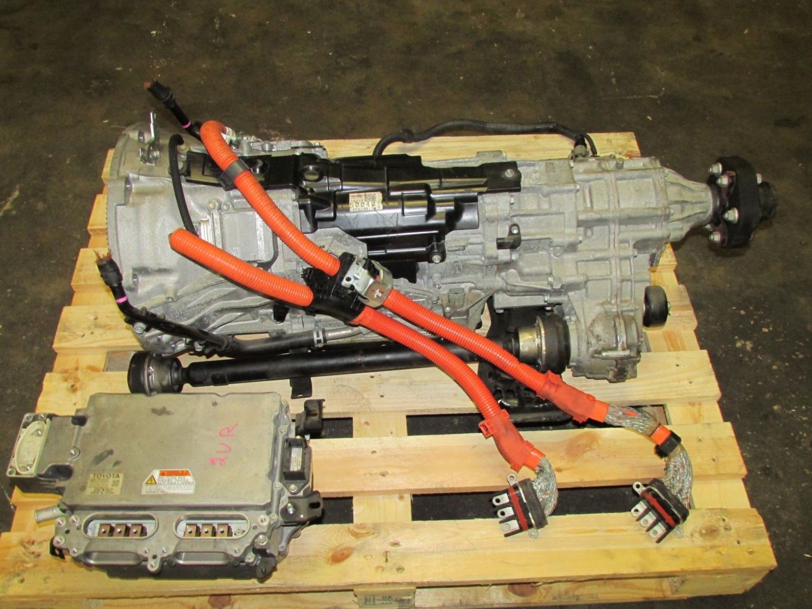

jap
Posts: 32
Joined: Fri Jun 26, 2020 5:14 pm
Re: subaru impreza wrx awd EV idea
Post by jap »
https://dalys.lt/en/autoparts/lexus/rx- ... ox/5531262
Hard to argue against that price, bet you can shave off decent amount of weight too if you know what you are doing. Add an ampera inverter, second lexus box and some BMW packs.
edit: even cheaper one: https://dalys.lt/en/autoparts/lexus/rx- ... ox/1183899

jap wrote: Sun Jul 26, 2020 10:07 pm https://dalys.lt/en/autoparts/lexus/rx- ... ox/5531262
yeah its pretty insane price wise
