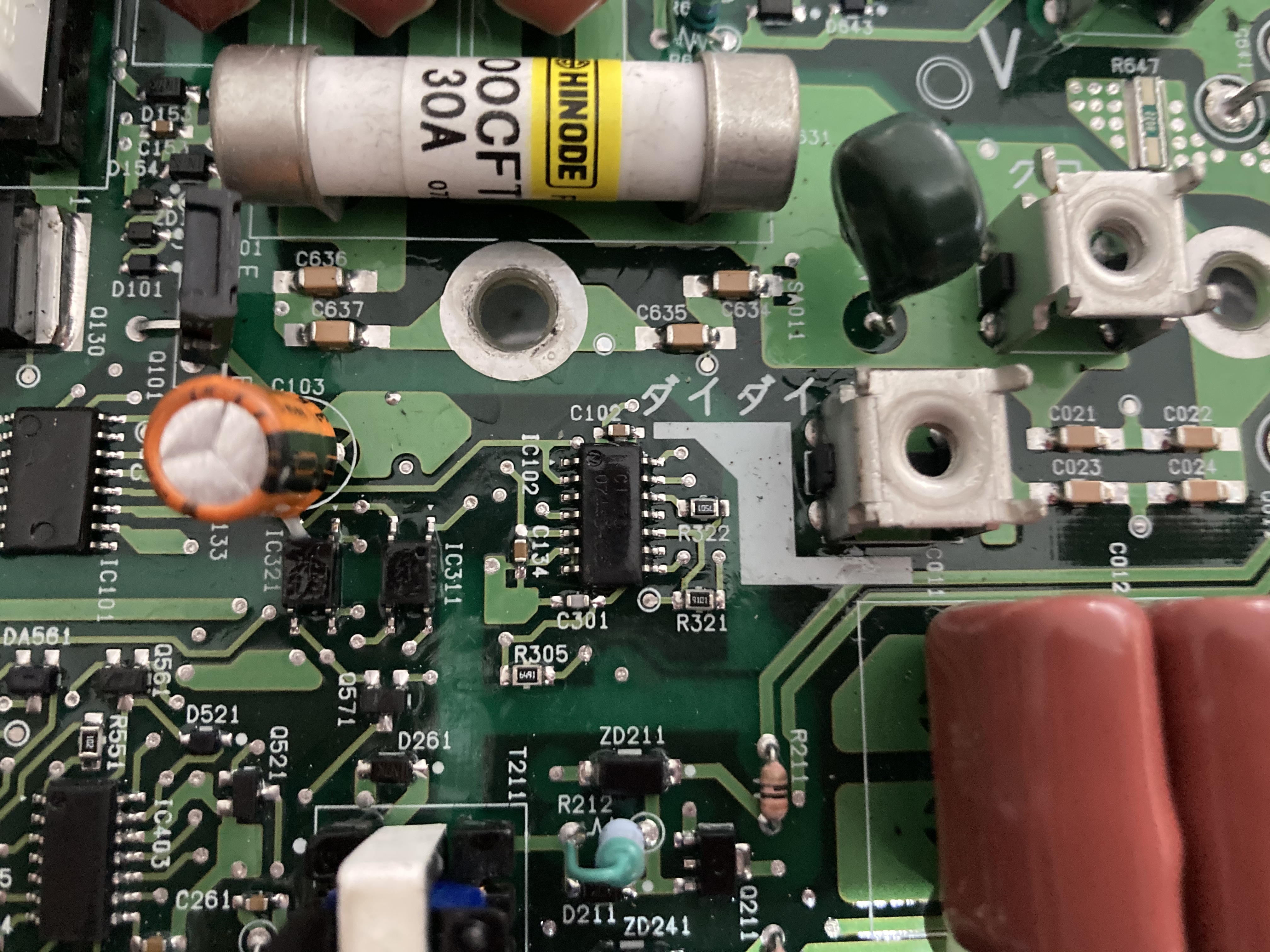

Has anyone tested the Gen2 Prius DCDC converter to see what the maximum input voltage is?
I know the Gen3 is limited to around 230V and needs a modification to some resistors to allow it to work with higher voltages.
I’ve had a look inside my Gen2 inverter today and the input fuse is rated at 600V 30A and the capacitors are rated to 400V so just wondered if anyone had tried applying 300V+ to see if it works.

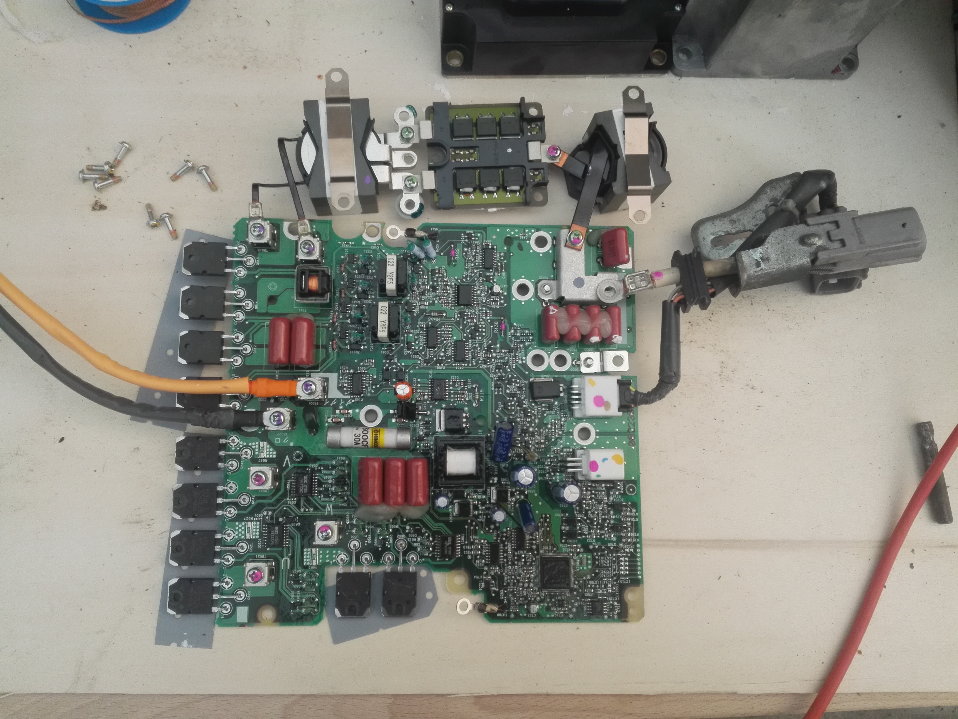

Dumb questions:
1 - Can you rip the DCDC block out of a Prius Gen2 or 3 and use it with nearly-zero modification?
I.E. People are still buying DCDC converters, should I just recommend they buy this? Even the whole inverter is still cheaper than buying a DCDC anywhere else, just as long as you're not stuck with the bulk of using the whole thing.
2 - Can you parallel the DCDC? I'm considering heating options, and, honestly, just easy and dumb solution is to use several 1000W 12v heater elements as the cabin heater. They just need more than one DCDC. Again so see above, how easy is it to just yank that part out of the inverter?
Posts: 6761
Has thanked: 383 times
Been thanked: 1580 times
Re: Prius Gen 2 DCDC Converter

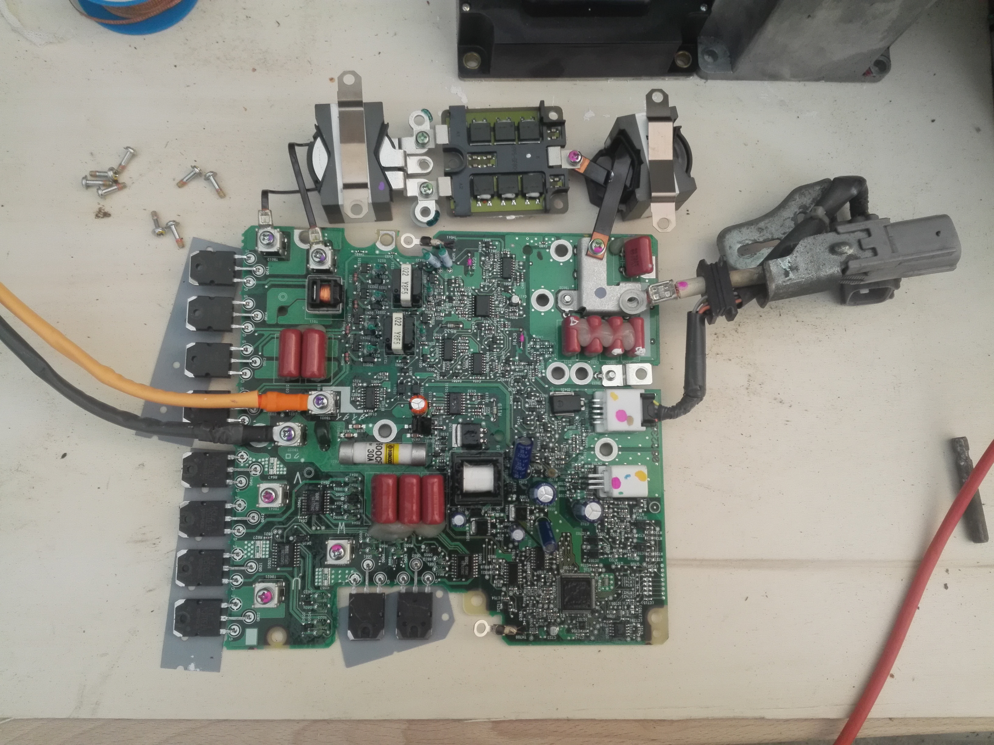

I pulled out a DC-DC converter from the bottom of a Gen2. All that matters is getting the cooling sorted. 4 TO-264 transistors want cooling, then the transformer, diode pack and output choke. Will try if I can rig something up.
Only downside regarding space requirement: you're dragging that small 3-phase inverter for A/C along which is on the same board.
Posts: 1020
Has thanked: 407 times
Been thanked: 260 times
Post by MattsAwesomeStuff »
johu wrote: Fri Apr 02, 2021 7:45 amOnly downside regarding space requirement: you're dragging that small 3-phase inverter for A/C along which is on the same board.
Not the MG1 or MG2 inverter, some tertiary inverter?
Pics would help. If not me, then, everyone else I'll be explaining it to :p

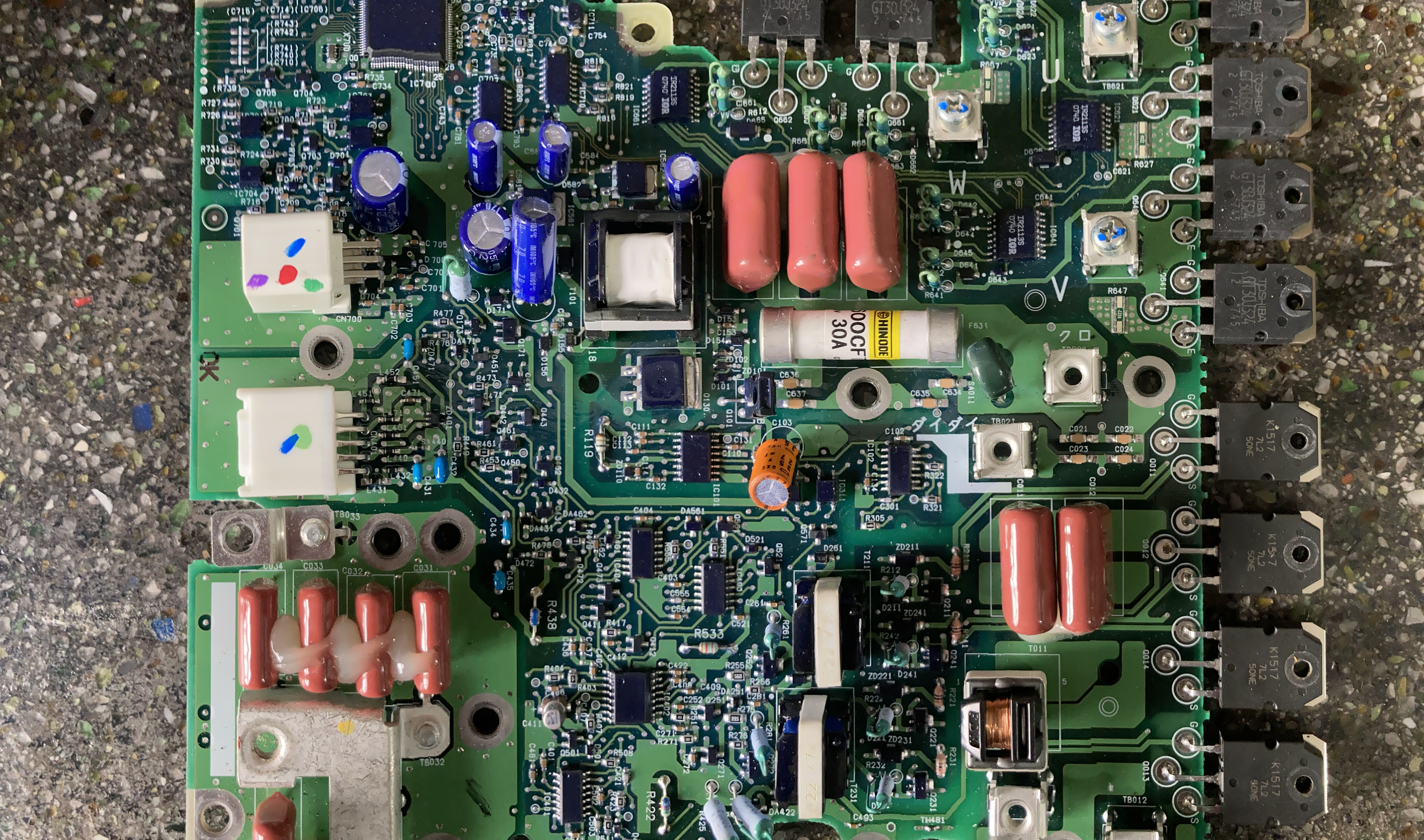

Posts: 6761

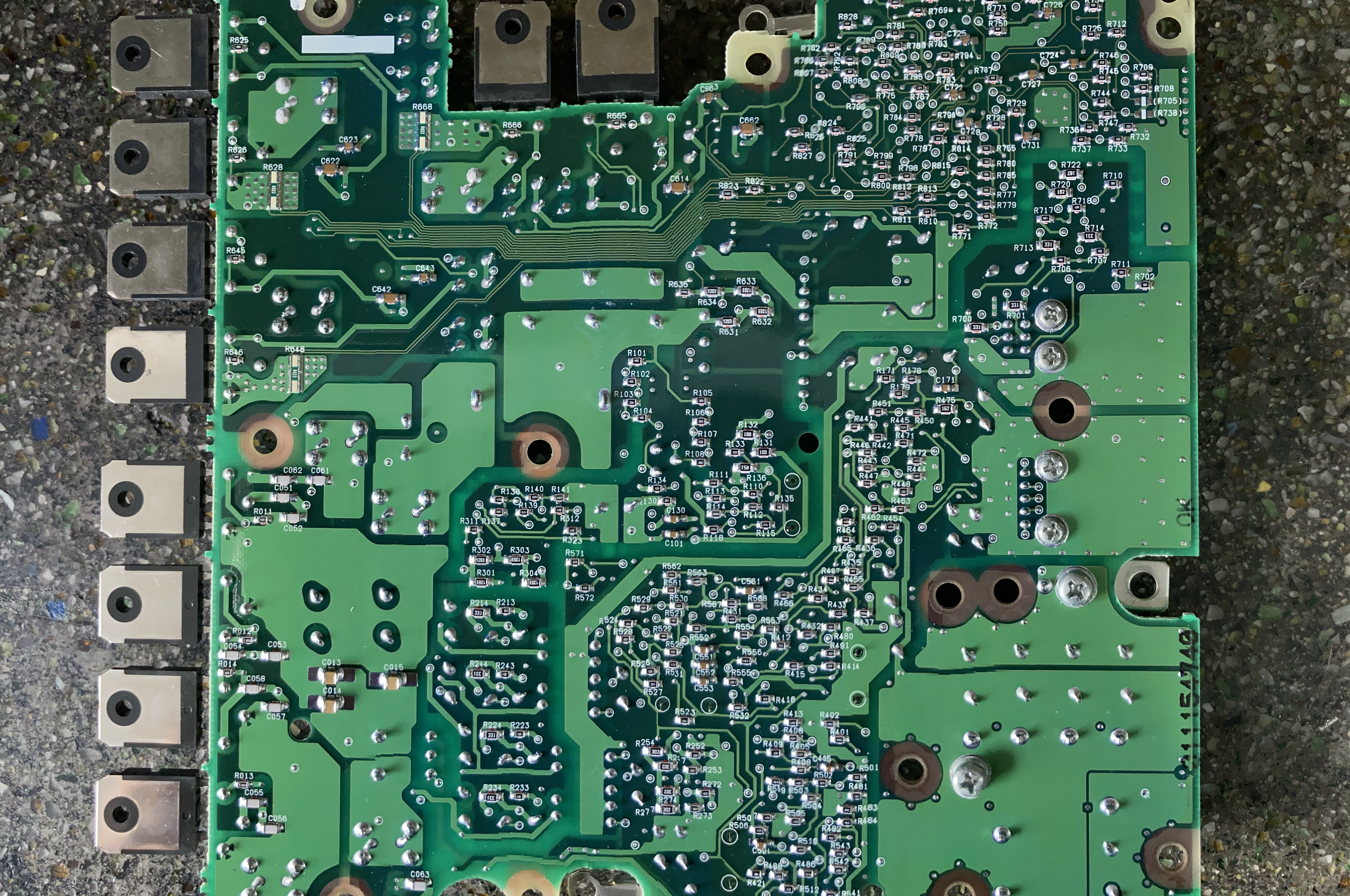

MattsAwesomeStuff wrote: Fri Apr 02, 2021 9:31 am Pics would help. If not me, then, everyone else I'll be explaining it to :p
Roughly everything above the fuse is the DC-DC converter, everything below the tertiary A/C inverter.
All components need cooling and the center tap of the transformer must be grounded.

Just looking for the v sense resistor network now, looks like it’s on the underside
Ev8
Posts: 818
Has thanked: 43 times
Been thanked: 163 times
Post by Ev8 »

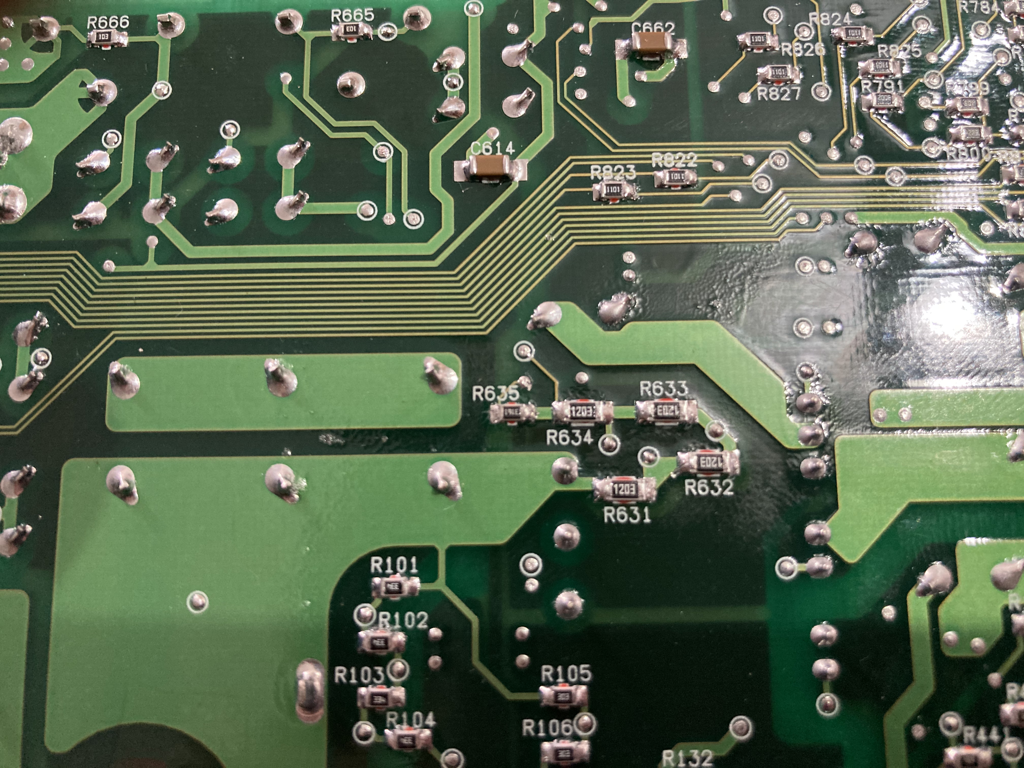

Ok I have found one voltage divider which runs off to the control chip a rear on top of the board it’s 4 120k (1203) (r631 r632 r633 r634 r634) and a 3.14k (approx can’t read code) (r635) which would give a reference voltage of about 1.5v from a 200v input so it’s believable. I don’t think I have anything to loose by trying to change the values here.
Ev8
Posts: 818
Post by Ev8 »

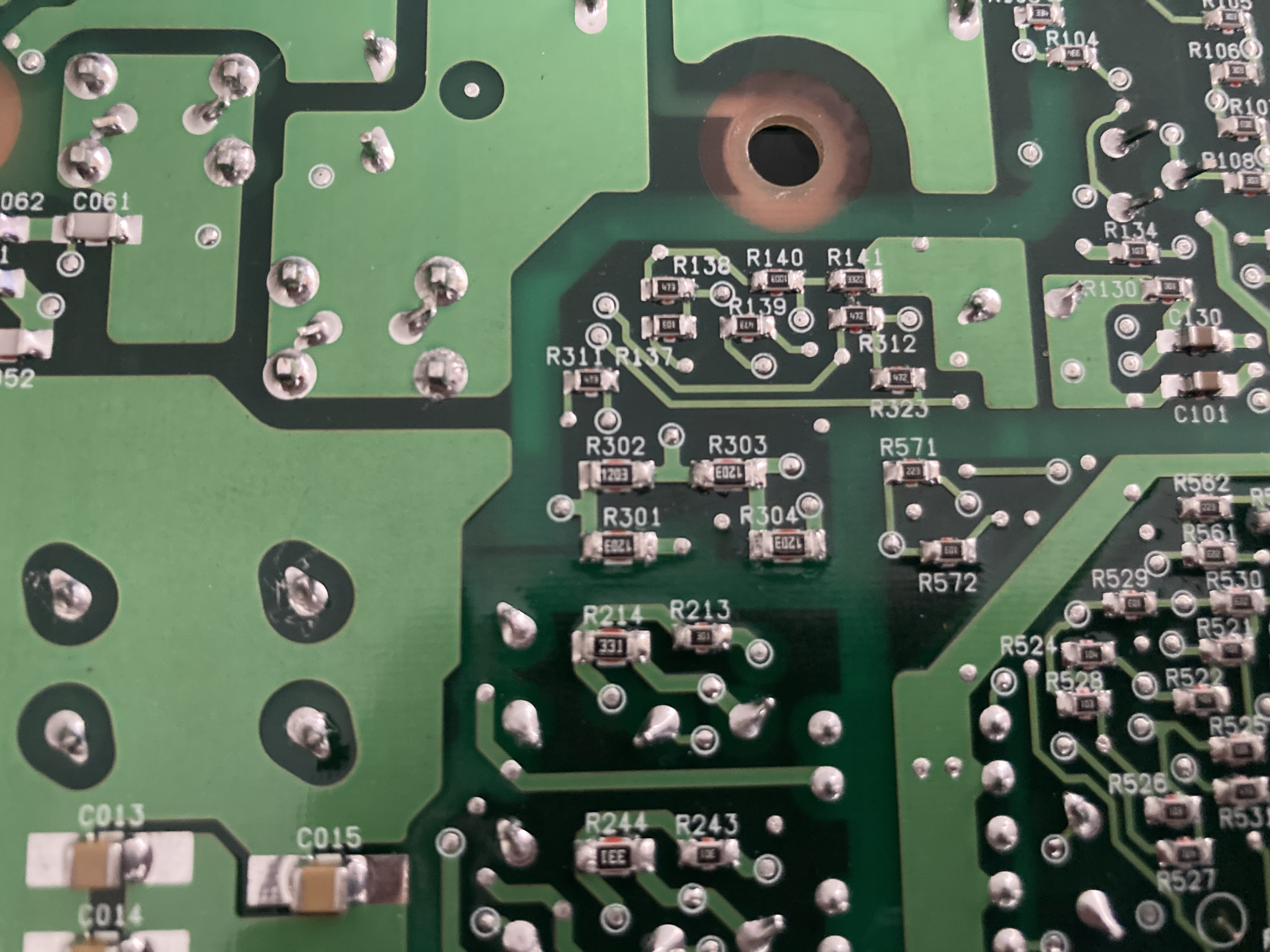

Also a second divider network here, 4 x120k (1203) on the bottom of the board (r301 r302 r303 r305) and 6.4K (approx code too small to read) on top (r305)
Posts: 6761
Nice find! Maybe one is for the threshold and one for regulation?
