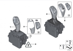

Part Numbers
| No | LHD/RHD | Description | Part Number | Vehicles Used | Status | Tested |
| 1 | RHD | Gear Selector Switch | 61 31 9296897 | F20, F21, F22, F23
F30, F31, F32, F33, F34, F36 |
Active | |
| 1 | RHD | Gear Selector Switch | 61 31 9291519 | Until 06/2013 | ||
| 1 | RHD | Gear Selector Switch | 61 31 9260969 | Until 08/2012 | ||
| 1 | RHD | Gear Selector Switch | 61 31 9253652 | Until 01/2011 | ||
| 1 | LHD | Gear Selector Switch | 61 31 9296896 | F20, F21, F22, F23
Active | |
| 1 | LHD | Gear Selector Switch | 61 31 9291517 | Until 11/2012 | ||
| 1 | LHD | Gear Selector Switch | 61 31 9260968 | Until 06/2013 | ||
| 1 | LHD | Gear Selector Switch | 61 31 9253651 | Until 01/2011 |
| 2 | RHD | Gear Selector Switch, Sport | 61 31 7950385 | Active | ||
| 2 | RHD | Gear Selector Switch, Sport | 61 31 9296899 | F20, F21, F22, F23
Until 05/2018 | X |
| 2 | RHD | Gear Selector Switch, Sport | 61 31 9291521 | Until 11/2012 | ||
| 2 | RHD | Gear Selector Switch, Sport | 61 31 9260971 | Until 07/2012 | ||
| 2 | RHD | Gear Selector Switch, Sport | 61 31 9253654 | Until 01/2011 | ||
| 2 | LHD | Gear Selector Switch, Sport | 61 31 7950384 | Active | ||
| 2 | LHD | Gear Selector Switch, Sport | 61 31 9296898 | F20, F21, F22, F23
Until 01/2019 | |
| 2 | LHD | Gear Selector Switch, Sport | 61 31 9291520 | Until 06/2013 | ||
| 2 | LHD | Gear Selector Switch, Sport | 61 31 9260970 | Until 06/2013 | ||
| 2 | LHD | Gear Selector Switch, Sport | 61 31 9253653 | Until 01/2011 |
