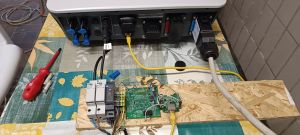

First prototype
One way to DIY a bidirectional charger is the use of a hybrid PV inverter with high voltage battery input. The advantage is that these are mass-produced (thus cheap) and conform to the various legal requirements. The inverter then handles power transfer and optionally smart functions such as zero grid import/export and we only need to supply the surrounding logic and electrics.

This component list is just an example that has proven to work. It is preliminary and has not been tested with OEM cars yet, so it will likely be extended. As always, you are working with high voltage and especially grid voltage. Make sure you are qualified otherwise ask for help.
Item Approximate cost Link/Source Remarks
Sungrow SH5.0RT (or more powerful variant) 850€ Sungrow Pick an inverter that is supported by Battery Emulator
CCS Connector 90€ AliExpress Plain connector without cable
BeagleBone Green 45€ Mouser
FoccciCape 250€ OI shop RS485, CAN comm, 2x relay driver, CCS
Flexible cable, 4 or 5 pole 4€/m Local hardware store Size according to charging current. 5x2.5mm² used for the 5 kW inverter
For DC+, DC-, PE, CP and PP. PP can optionally be terminated in the plug, then you just need 4 poles
2 Fuse blocks 6€ each Mouser
2 25A fuses 8€ each Mouser 400V AC rated from your local hardware store suffices as it's 2 in series
12V 2A DIN rail supply 18€ Mouser
DIN rail cabinet 20€ Local hardware store
MC4 connector set 5€
5V to 400V step up converter 10€ ebay Only needed for OEM cars
The CCS connectors + and - is connected to the inverter input via the fuse blocks. I did not deploy additional contactors but rely on the ones that are already in the car and the inverter. The PLC modems output transformer is connected to PE and CP via a capacitor and a resistor, more details in uhis github.
The BeagleBone is connected to the PLC modem and the inverter Ethernet port, so you will need a small network switch, also for the uplink to your home network. In addition the CAN outputs of the COMPCE cape connects to the inverters battery CAN (pins 3 and 4 on the Sungrow).
More info on the software setup in the development threads linked above, uhis github and Johannes' github.
This setup can also be used with CHAdeMO cars in which case the powerline modem can be omitted.
