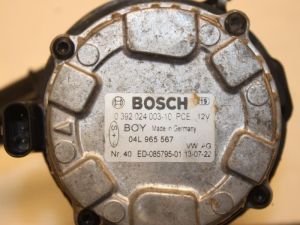

Important Note on Bosch vs VW pumps

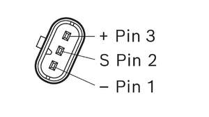

Although both companies use pumps from the "PCE"-series, a closer look at the pump connector reveals an important difference: Bosch pumps have the key nearer to the centre (pin 2) and have the pinout 1 (gnd), 2 (signal), 3 (12V). By contrast, VW pumps have the key closer to the leftmost pin (pin 1) and have the pinout 1 (gnd), 2 (12V), 3 (signal). Also note that, although both brands have "Bosch" on the label, the VW-branded ones also have a "VW-AG" marking.

VW 04L 965 567 pump. Note the pinout and the position of the key vs the Bosch-branded pump.

Pinout
Bosch-branded PCE pump pinout (**not for VW**)

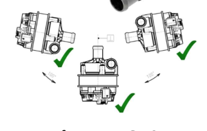

Mounting
One application (i.e. Cascadia Motion) simply uses a massive (as in 80mm diameter) "p clamp" to secure the pump. For those looking for something more secure/OE: Bosch PCE Coolant Pump Bracket.
