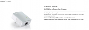

Charging via CCS DC Fast Charge requires Powerline Communication (PLC). The TP-Link TL-PA4010 (discontinued, but widely available used) is an inexpensive home PLC unit that is designed to use a residence's mains wiring (power lines) as a communication medium for ethernet. It can be repurposed to be used as a CCS EV Communications Controller (EVCC)[1]. In its new role, it communicates via PLC over the CP line to the EVSE. It can be reliable when powered by a range of low DC voltages, 12v down to under 5v. Additional resources have been compiled by uhi22[2].
TL-PA4010
TP-Link TL-PA4010 ("AV500") PLC Ethernet adapter.
The TL-PA4010 utilizes the Qualcomm Atheros QCA7420 PLC comm IC. Examples can be purchased via eBay etc. for well under USD$20 (Apr2023). Variants include a single-PCB version, and a version with a mains pass-through which uses two PCBs. Both variants utilize the same PLC IC, the AR7420, and both adapt well for CCS.
