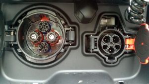

Chademo uses a separate socket to the ac charging port. This is found on Nissan Leaf.
The port on the left is the Chademo port on a Nissan Leaf. This is probably the cheapest standard to get DC rapid charging in your conversion.
There are multiple options for a Chademo controller.

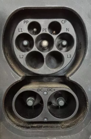

CCS combines the AC charging port with 2 additional pins for DC charging and comes in 2 different socket type, type 1 more common in USA and the type 2 more common in Europe.
The port above is a type 2 CCS socket, for AC charging the normal AC type 2 connector fits in to the top part and the bottom usually has an additional cover for the pins.

Pinout
Quick reference of the CCS2 pinout. Looking at the car:
   PP  CP
 L1  PE  N
   L2  L3
  DC-  DC+
As a rule of thumb, CP is on the same side as DC+. PP is the pin that the car supplies about 4.5 V, and on that side is DC-.
