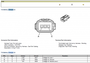

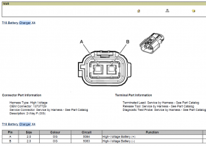

This unit is CAN controlled also. It is actually two chargers in one box. One module charges 12V battery up to 30A worth. Second module is HV charger and it can operate from 200V up to 420Vdc. Usually it provides 8A for charging the main battery.

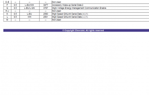

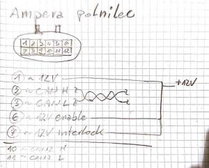

First we need to connect to 12V battery. Second connector provides control voltage and interlock in case of EVSE malfunction. Note charger has two CAN bus lines. We only utilise the first one as seen from the sketch. Drawn is connector from charger side.
The Lear operates CAN at 500Kbps.

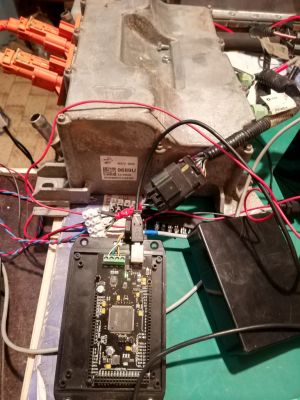

Select which of the charger modules you wish to operate. Only one msg is sent for heartbeat, do not send all three messages!
Address DLC Data0 Data1 Data2 Data3
0x30E     1     0x01                                                Turn on aux12vdc
0x30E     1     0x02                                                Turn on HV Charging
0x30E     1     0x03                                                Turn on aux12vdc and turn on HV Charging
This message is sent at 30ms interval
Then send command line.
0x304     4       0x40   0xA0   0x03   0x20           Charge at 8amps to 400.0vdc
This is sent at 500ms interval

Charger really needs liquid cooling as it gets hot quickly when charging at 8A.
