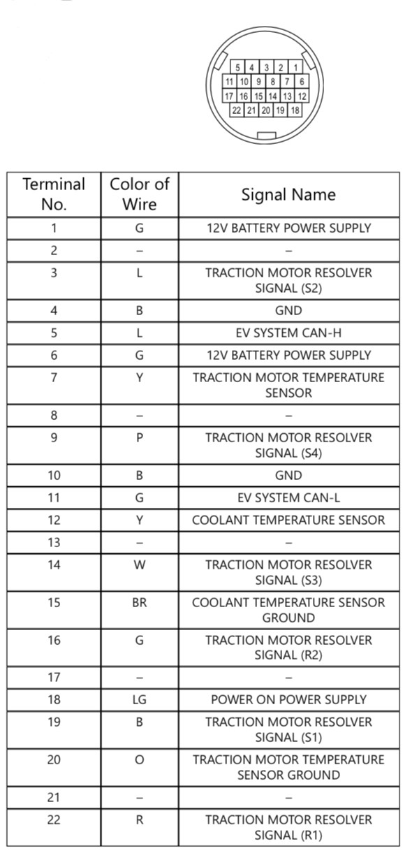

The pinout of the gen 3 nissan leaf inverter connector
