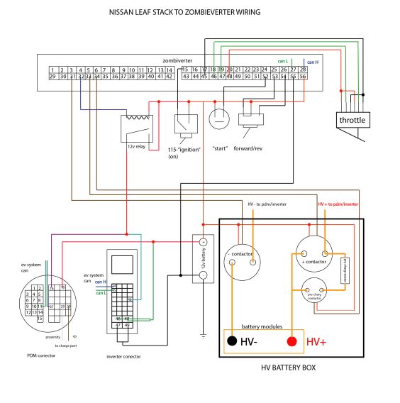

Wiring
Wiring the zombiverter to the leaf harness

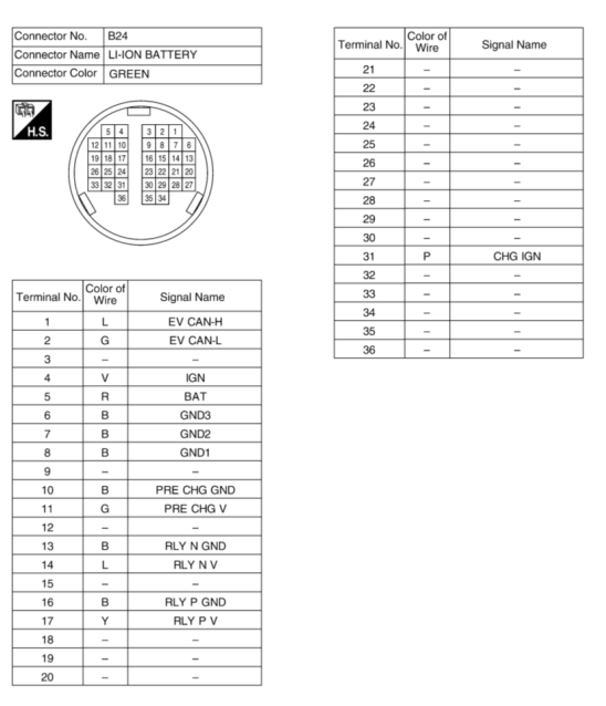

Description Zombieverter Pin PDM pin inverter pin inverter gen3 pin battery pin
+12V Permanent 12v+ 56 18 46, 48 1, 6 5, 11, 14, 17
Gnd permanent 12v - 55 pdm case 47, 49 4, 10 6, 7, 8
Fwd signal Forward 54
Rev signal Reverse 53
momentary 12V Start signal 52
Brake signal Brake Input 49
+5V Throttle 48
Throttle signal 1 Throttle signal 1 47
Throttle signal 2 Throttle signal 2 46
Throttle Gnd Throttle Gnd 45
Precharge Contactor LS Switch Negative lead from precharge contactor 34 10
Main Contactor LS Switch Negative lead from main contactor 33 16
enable relay switches enable relay 32 16 42 18 31
Neg Contactor LS Switch Negative lead from negative contactor 31 13
CANEXTH Can 1 High 28 27 14 5 1
CANEXTL Can 1 Low 27 11 15 11 2
T15 Ignition 12V in 15 4
proximity pilot pp for charge port 29
control pilot cp for charge port 30

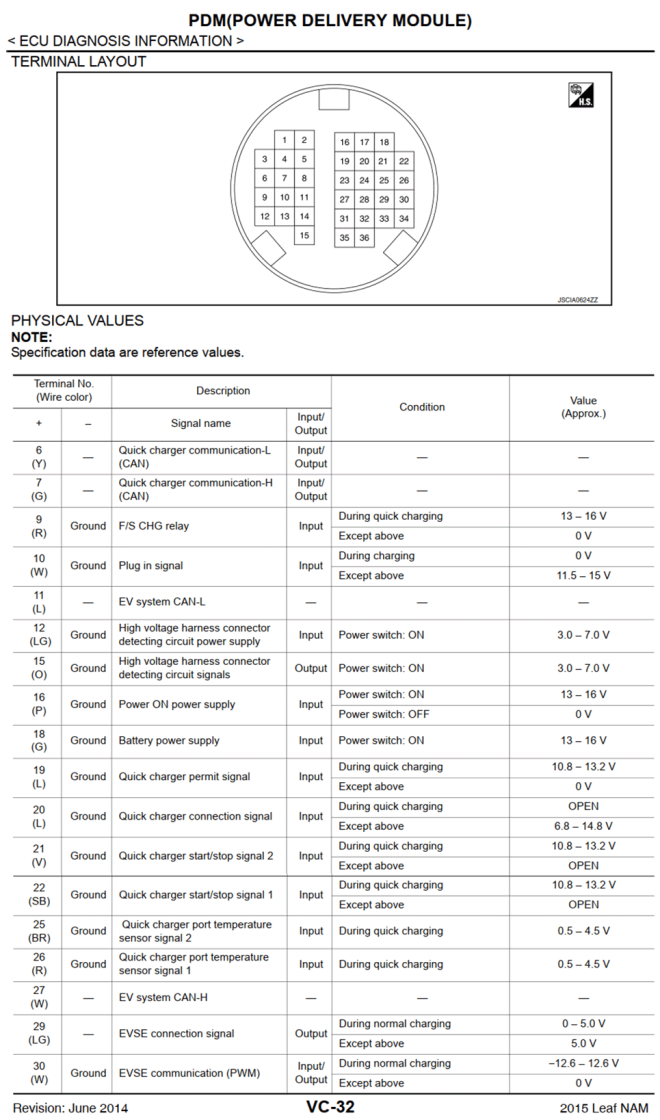

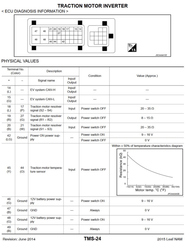

Leaf Inverter terminal layout and physical values for signals

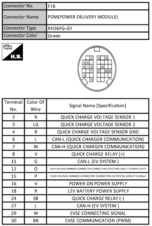

Leaf PDM connector pinout and physical values. This seems to apply to 2013-2017 Leaf. Check what you have before blindly making any connections.

Chademo to Zombiverter:
Nissan Leaf gen 3 to Zombie wiring diagram
