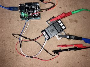

First of all, set up your Arduino Uno and CAN bus shield.
Once the data is coming in over CAN, we can write a simple program to read the current value from the IVT-S.
There could be a lot of messages coming back on the CAN bus, so we specify a "mask" and "filter" for the CAN message IDs we are interested in. CAN bus message IDs are 11 bytes long, so we will specify a mask of 0x7ff (which is 11111111111 in binary). Using an MCP2515-based shield, we can set up to six different filter IDs. According to the Isabellenhütte IVT-S data sheet, the message ID of the "Current" reading from an IVT-S is 0x521, so we will specify that as the filter.
Once those parameters are set, the data should come in over CAN bus every 20ms at 1Mb/s.
The tricky part is that the current measurement comes from the the IVT-S as a buffer of four byte values in big endian order. We have to re-assemble these bytes to get the numerical current value (in mA). Once that's done, we get nice, readable numerical values on the serial console.
Here's the code:
