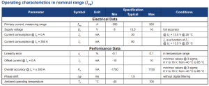

LEM CAB300 C/SP2 Current sensor
Outlander current sensor
CAB300-C SP2 characteristics

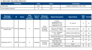

Current sensor CAN report
CAN protocol CAN bus report is fixed at 500kbps
To start or stop communication it uses ID 0x6F0 in notextended(standard) frame - single signal.
Signal is 8 byte long byte1 value 0x28 will stop CAN and 0x29 will start communication.
Current report is in ID 0x3C2 in standard frame 8 bytes
zero center at 80000000H = 0mA
1mA = 80000001H
-1mA = 7FFFFFFFH
byte0 = error indication (0 - normal, 1 - error)
byte7 to byte1 is the value to calculate

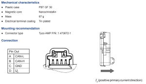

CAB300 connector, which is CAB500 connector as well:
4P Female P/N 1473672-1
Pins Female Crimp 1123343-1
