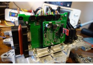

open inverter replacement mother board kit. Assembled and installed in a gen 2 nissan leaf inverter
The Nissan Leaf gen 2 board is a replacement mother board for the gen 2 leaf inverters. it utilizes a adapter board to fit a rev 3 openinverter board in into the leaf inverter.

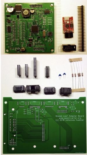

The Kit
Gen2 leaf inverter mother board replacement kit. Including revv3 open inverter brain board
The kit comprises of:
  • openinverter rev3 board pre programmed with leaf motor tune
  • Esp8266 wifi board
  • adapter board
  • various connectors
  • a handful of some basic components
The kit is designed to drop in place of the original Nissan logic board. The adapter board is designed to re-use the large proprietary connector that is mounted on the original logic board.

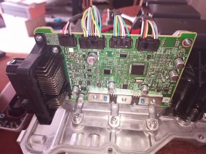

Nissan Board Removal
Nissan board, yet to be removed. The large connector on the left must be salvaged and re-used.
OEM Nissan logic board, yet to be removed. The large connector on the left must be salvaged and re-used. 3 allen head bolts can be see in bottom half of photo

  • removing the mother board
the oem mother board is easly distinguished as it has the large proprietary connector attached. It is on it's own aluminum bracket attached to the case by 3 allen head bolts.
  1. disconnect the plugs from the four connectors at the top of the board.
  2. remove the allen bolts to free the bracket and board.
  3. remove the screws holding the board to the bracket Nissan uses some very strong thread lock so be prepared for some of the screw heads to shear.*carefully heating the screw will help break down the thread lock

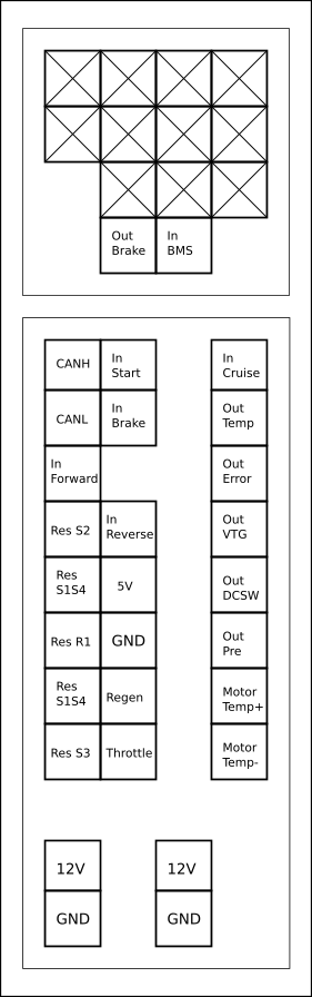

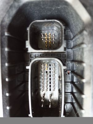

Nissan Proprietary connector as seen from outside the housing.
Pin function descriptions, pins as seen from outside the housing
Proprietary connector pin function descriptions, pins as seen from outside the housing.

Kit Build
  1. Solder the components to the board as per the instructions.
  2. The large proprietary connector must be salvaged from the original Nissan logic board. as it is not available on the open market. once salvaged, solder it onto the adapter board.
  3. plug in the rev 3 board and wifi adapter.
  4. clean up the wiring harness
  5. connect 12v to power up the board and test that it is working. login to the wifi interface.
  6. Use fresh screws to attach the board to the carrier and bolt it back in place using the allen head screws.
  7. connect the gate drivers to the adapter board
  8. see rev3 board page
Proprietary Connector
Not all pins of the connector are available. The top group are blanked off, so the brake and BMS signals are not available.
The resolver and CAN bus signals remain on the same pins as used by Nissan. If other signals are required then they must be added to the female connector.

Leaf OEM pre-wired connections
if using the oem leaf connector, the following connections are already populated:
  • resolver
  • motor temp
  • power
  • main contactor
  • can high/low
Diagram found here: http://productions.8dromeda.net/c55-leaf-inverter-protocol.html
| 47   46   21 20 19 18 17 16 15 14 |  |       x  x |
|           29 28 27 26 25  x 23 22 |  |  6 x  x  x |
| 49   48    x  x  x  x  x  x  x  x |  | 10 x  x  x |
|           45 44 43 42 41 40 39 38 |  |    x  x  x |
- 6 = OUT_BRAKE
- 10 = IN_BMS
- 14 = CANH *
- 15 = CANL *
- 16 = IN_FORWARD
- 17 = RES_S2 *
- 18 = RES_S4 *
- 19 = RES_R1 *
- 20 = RES_S1 *
- 21 = RES_S3 *
- 22 = IN_START
- 23 = IN_BRAKE
- 25 = IN_REVERSE
- 26 = 5V
- 27 = RES_R2 (GND) *
- 28 = THROTTLE2
- 29 = THROTTLE1
- 38 = IN_CRUISE
- 39 = OUT_PWM
- 40 = OUT_ERR
- 41 = OUT_OVTG
- 42 = OUT_DCSW * (! 12V input on original harness, make sure not to connect to 12V but to DC switch!)
- 43 = OUT_PRE
- 44 = MTEMP1 *
- 45 = MTEMP2 *
- 46 = 12V *
- 47 = GND *
- 48 = 12V *
- 49 = GND *
Only pins with * are populated on the OEM wire harness
