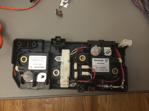

The contactor box after being opened
These contactor boxes are great because they are an all-in-one package that comes pre-wired and can handle a relatively large amount of power. You don't have to do any fancy CAN framing or specific sequencing, just provide 12v at a specified location and you're good to go.
The contactors and relay are controlled by means of 6 pins in a connector on the corner of the unit (top right in the picture to the right). Each component is controlled by two pins. One pin permanently grounded. If you provide 12V+ to the other pin, the relevant component will be activated until you remove 12v+.
Note - because these contactors are rated for 500V/200A, they might not be suitable for high performance applications. Make sure to check what your expected current loads will be!

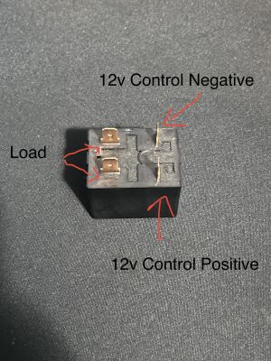

The precharge relay (Panasonic AEV6501C) doesn't have a datasheet anywhere, but it's fine for at least 15 amps for short periods and 400 volts.

Wiring
A labeled picture of the precharge relay.
