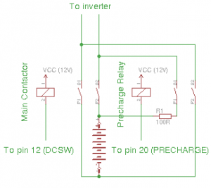

Connecting Precharge and Main Contactor
Contactor connection
Connect the precharge relay and the main contactor as depicted in the diagram. It is recommended to disconnect both battery poles. The inverter controls the two contactors by means of the DC bus voltage. When udc < udcsw then the precharge relay is closed, the main contactor is inhibited. When udc > udcsw the main contactor is closed as soon has the start signal (pin 7) goes high. The precharge relay is opened at the same time. udcsw should be set to about 80% of your nominal pack voltage. So if the latter is 360V set udcsw to 300V by typing
set udcsw 300
