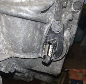

MG1 Resolver and Temperature Sensor
PIN Label Descriptoin Factory Wire Color
1 (upper right) GRF EXC Pink
2 GSN SIN Black
3 GCS COS Gray
4 (upper left) GMT Temp Black
5 (lower right) GRG EXCG Brown
6 GSNG SING Purple
7 GCSG COSG Green
8 (lower left) GMTG Temp Ground Red

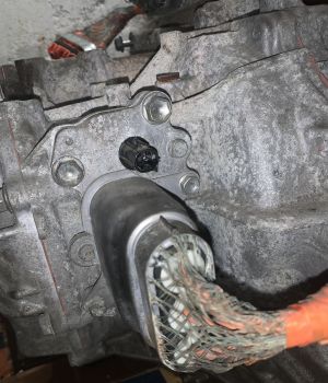

MG2 Resolver
PIN Label Description Factory Wire Color
1 (top) MSN SINE Blue
2 MCS COS White
3 MRF Exciter Brown
4 MSNG SINE Ground Red
5 MCSG COS Ground Yellow
6 (bottom) MRFG Exciter Ground Green

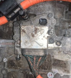

MG2 Temperature Sensor
1 MMTG Temp Sensor Ground Black
2 MMT Temp Sensor Red
