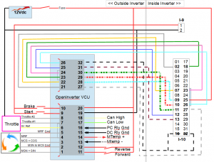

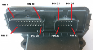

Pin Mapping - Note : Smaller 12-pin socket is the interface to the inverter & 20-pin to the motor

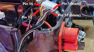

32 Pin Main white connector Gen 2 Inverter emplacement
20 - Pin socket
Pin#01 - ENC_B/S3
Pin#02 - S1S4
Pin#03 - ENC_A/S2
Pin#04 - R1
Pin#05 - R2
Pin#06 - 5V
Pin#07 - THROTTLE 1
Pin#08 - THROTTLE 2
VCU to Prius Gen2 wiring v1.1
Pin#09 - START_IN (12V) Push button type switch - not a permanent 12v input
Pin#10 - BRAKE_IN (12V) Push button type switch - not a permanent 12v input
Adapter Board Pin out locations
Pin#11 - FORWARD_IN (12V) (1, 2 or 3 way switch) Do not connect permanently - selected AFTER START
Pin#12 - REVERSE_IN (12V) (1, 2 or 3 way switch) Do not connect permanently - selected AFTER START
Pin#13 - Motor Temp -
Pin#14 - Motor Temp +
Pin#15 - DC (HV) Switch Control (Ground signal)
Pin#16 - Pre-ChARGE Control (Ground signal)
Pin#17 - CAN L
Pin#18 - CAN H
Pin#19 - Ground
Pin#20 - 12V "Ignition"
12 - Pin socket ( starts at pin number #21) - Corresponding pin on Main White 32 pin Inverter connector is in brackets.
Pin#21 - GIVA (2)
Pin#22 - MIVA (7)
Pin#23 - GIWA (18)
Pin#24 - MIWA (23)
Pin#25 - VH (12)
Pin#26 - MIVT (26)
Pin#27 - MFIV (27)
Pin#28 - MUU (9)
Pin#29 - MVU (10)
Pin#30 - MWU (11)
Pin#31 - CPWM (13)
Pin#32 - GINV/GCNV (16/32)
Connect MSDN Pin#25 in inverter (not 25 on controller) permanently to 12V to enable the MG2 Inverter (can be tied to same 12v source as "I9")
Connect CPWM to 12V via a 470 Ohm resistor to enable the Buck/Boost convert if using the DC/DC converter or charge mode.
Connect the 2-pole white power connector ("I9") inside inverter to 12V and Ground to power up inverter electronics.
Make sure to connect Pin #32 and #16 GINV/GCNV to vehicle ground.

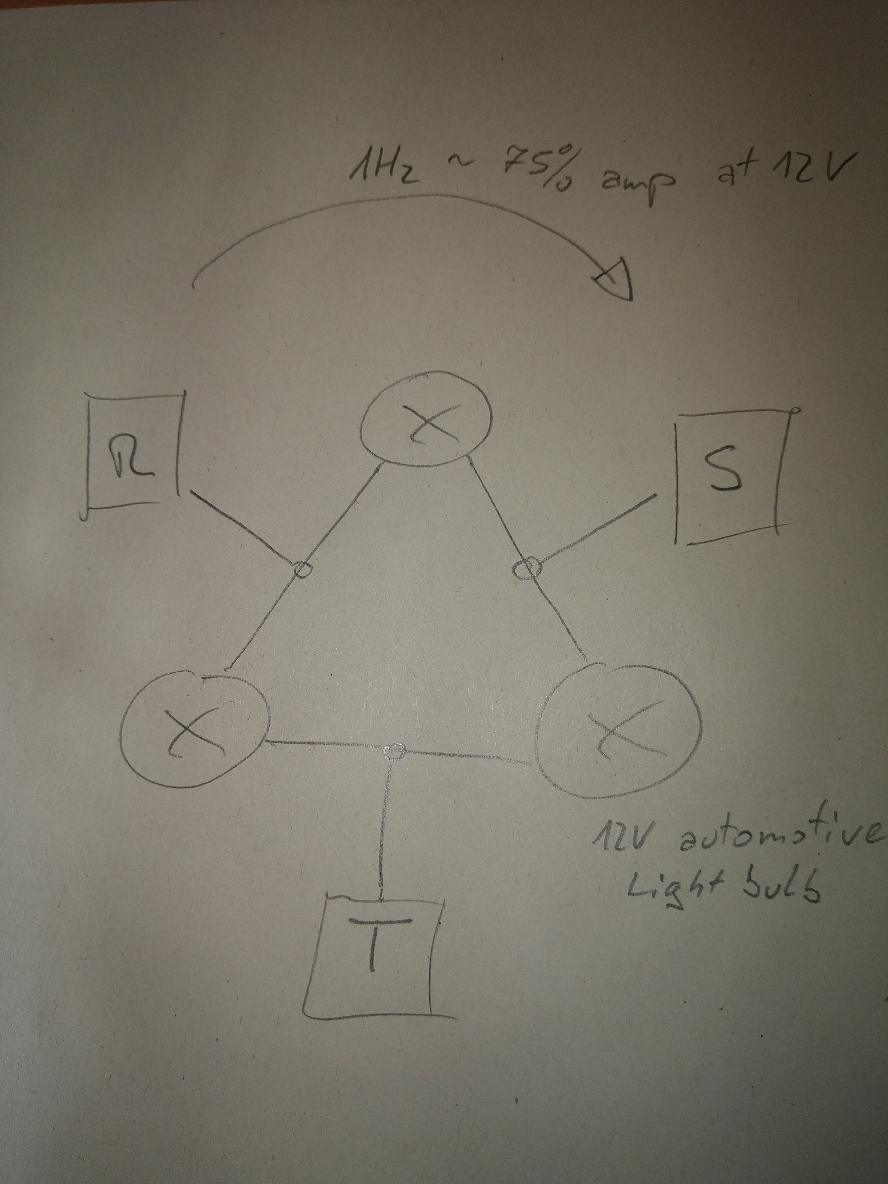

Step 8 : Connect 21 watt light bulbs in Delta connection to the 3 PWM outputs in Inverter (no motor) - https://openinverter.org/forum/download/file.php?id=4273&mode=view
Step 9 : Web Interface Basic parameters ( stm32_sine. bin) set up - to confirm PWM outputs : Full boost (curki= 20000 min) with 12v supply, default forward, ampnom @ 70%, and fslipspnt @1 Hz. Select - "Start Inverter in Manual Mode" Confirm flashing lights.
Step 10 : Connect motor phase wires to inverter PWM outputs. Repeat Step 9 and change "fslipspnt" by 1 unit at a time, until motor spins smoothly. (I noticed Light bulb resistor on HV line lights up when no spinning) along with high current values. Once you have the motor spinning, continue to increase the "fslipspnt" value whilst monitoring the current (ampmeter on PWM output wire) You will also notice the light bulb starting to fade untill there is no more light. Optimal motor spinning in Open Loop Mode ! (these values are related to a 12 volt HV supply - re using these parameters is still to be verified at greater supply voltages)
