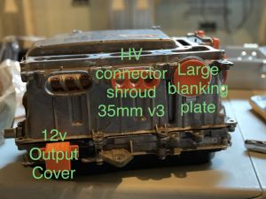

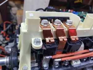

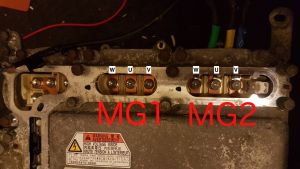

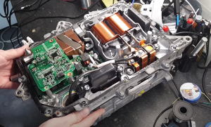

The Gen3 Prius (2010-2015 model years) has a variety of useful components inside the inverter package:
  • 2 high power inverters, for the 2 motors MG1 (starter) capable of handling 250 amps, and MG2 (drive motor) capable of handling 350 amps.
  • A DC-DC converter to provide 12v power supply to the automotive systems and accessories.
  • A boost module to boost the 200v battery pack up to 500v, which looks to be able to function as a battery charger (wish list for future development)
  • See this video for a explanation of the How the Prius Gen3 Hybrid Drivetrain Works: https://www.youtube.com/watch?v=PIYNAroYEk0
  • See this video for a thorough disassembly and explanation of the Gen2 Inverter and Converter HV System Design: https://www.youtube.com/watch?v=Y7Vm-C4MsW8
  • See these videos for a teardown, disassembly and explanation of the Gen3 Inverter: https://www.youtube.com/watch?v=Pw3JqkI6VO4 (Teardown) https://youtu.be/QBoRSXIwZQs (Regarding p0a94 error code for DC-DC Converter Performance)

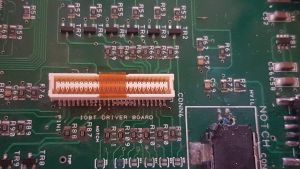

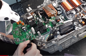

The control board is a physical replacement for the OEM Prius Gen3 inverter logic board inside the inverter. Remove the old one and replace it with the new one.

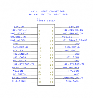

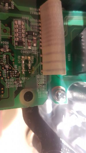

Inverter Model Numbers
Inverter No Car model(s) Logic Board No Power Board No Compatible 50 pin connector PCB size Confirmed works with board Link

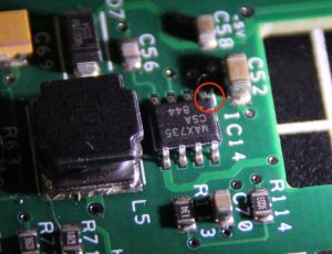

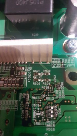

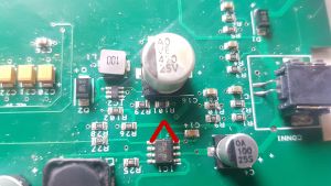

LDO strengthening
The stock 3V3 LDO (3.3V linear voltage regulator) does not provide sufficient current for both the STM32(s) and wifi module(s). Therefor the wifi module needs a distinct regulator.
TODO: does this also affect the latest revision boards?

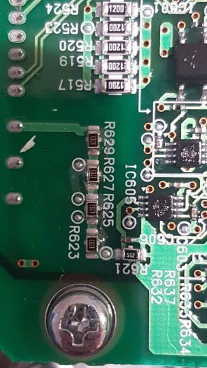

Early Board Correction, pre July 2020
The first batch of JLCPCB boards shipped have an incorrect resistor value that needs to be changed over. Boards shipped after Jun 26, 2020 will not need to do this.
Resistor labeled R101 (labeled '1002') needs swapping for a 8k2 (0805 package) resistor.

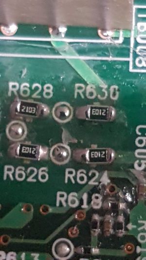

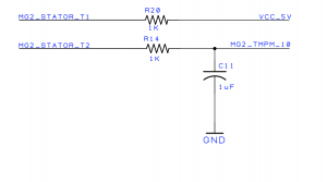

Motor Temperature Sensor correction.
Boards currently have an error with the temperature sensor circuit. R14 is supposed to be in parallel with C11 to form the voltage divider. One workaround would be to put a 1k resistor from one of the pads to ground. this can be done externally if you'd rather not modify the board, put a 1k ohm resistor from MG2_STATOR_T2 to a ground pin. Then connector the temperature sensor from MG2_STATOR_T1 to MG2_STATOR_T2 as normal.
This is a current issue on the boards. A new revision is not yet available.

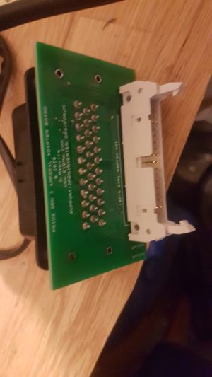

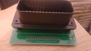

Soldering The Breakout Board

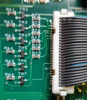

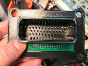

Solder the Ampseal socket to the the breakout board, the silk-screen indicates side and orientation fitment.
Next flip it over and solder the 34 way IDC locking header on, notch upwards as show.
Note: Some versions of the breakout board have and error in the silk-screen that indicate orientation incorrectly, with the notch towards the bottom.

The main board is mostly pretty easy to solder, the one exception is the 50 way white connector. I found that putting flux on the pads and dragging solder across them, placing the connector in place and then placing the iron on the pins was the easiest.
Also easiest is to start with this connector, whilst the most complicated, starting with an unpopulated board allows easier access to it as the following connectors are largely around this one.

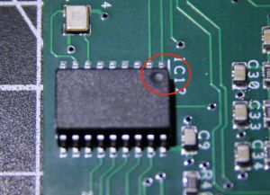

Depending on the kit and time you received it due to chip shortages, you might have IC12 and IC14 unpopulated and need to solder them on.
Each chip's 'pin one' has a small notch to indicate it and this matches the line and IC12 /IC14 silk screen on the board.
Again these are easier to get out of the way before the connectors are positioned.

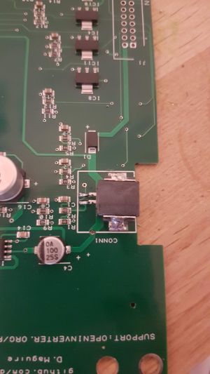

Next up I did conn 1, it can only go one way, and is a piece of cake after the 50 way connector.
And Conn8, again easy.

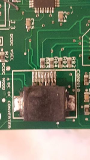

Next the DCDC convert connector, again only fits one way.

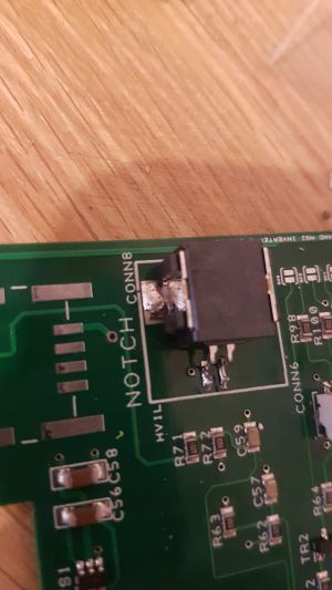

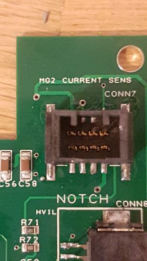

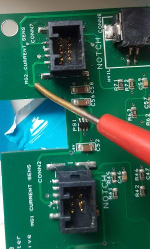

MG1 and MG2 Current sensor Connectors, both these are the same, the tabs on both MG1 and MG2 are at the top.

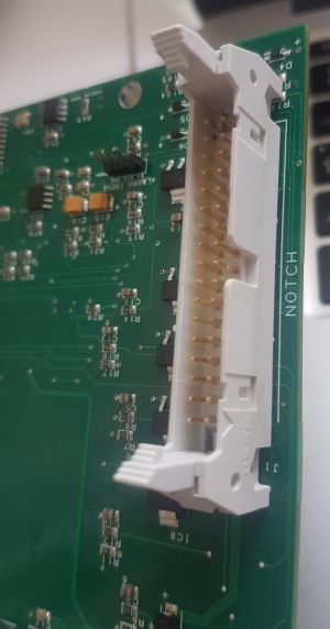

Ignore the 'Notch' on the board it needs to face outwards to the edge of the board, you'll also need to turn the sensor cables 180 deg to fit when installing the board.

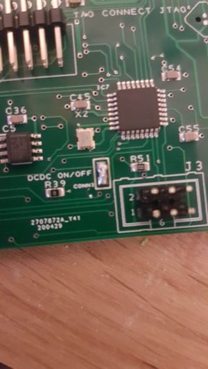

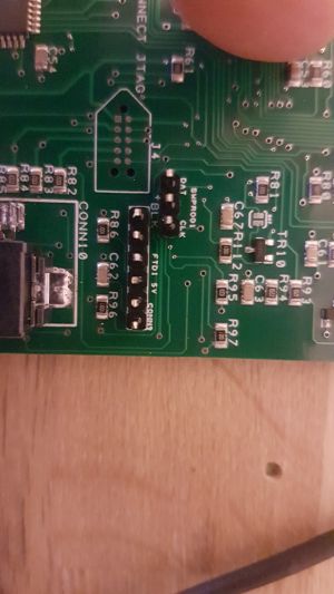

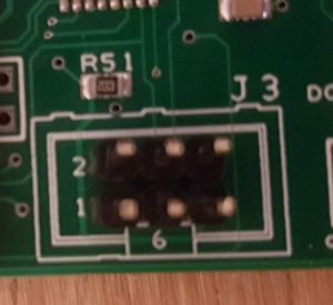

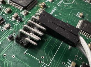

Cut 2 lengths of 3 pins from the header pin strips for the ISP header for programming the Atmega328P that will be used ton control the buck-boost converter.
To enable the DCDC converter for I've bridged over the 2 pin holes, but you can add a switch or something here, or leave it open if you're not using the DCDC to keep the 12v battery charged.
See note above for V1C and V1D boards

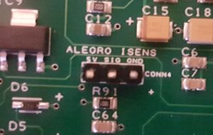

Pin header for Alegro current sensor, currently no software exists to control the buck boost, hopefully in the future this will be able to be used as a charger, this pin header is for the possible addition of a current sensor to facilitate.
Three options exist on the board for flashing the firmware to the STM32.
If you plan on programming your board with a TC2050 JTAG [1] then obviously skip the next step.
Solder a 3 pin headers for single wire program interface, or a 6 pin header for FTDI interface.
The photo below shows both headers populated, however you don't necessarily need both.

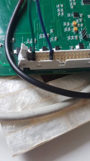

Last up is the 34-way ICD interlock connector for the breakout board. Notch outward.

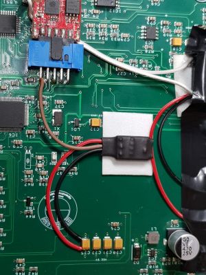

Powering up
Now it's time to power up the board with 12v and test.
Green wire is +12v (pin 1) and blue 0v (pin 11)
NOTE: When Idle, board consumes about 1.7 - 1.8A of current. When PWM starts, current consumption goes up to ~2A.

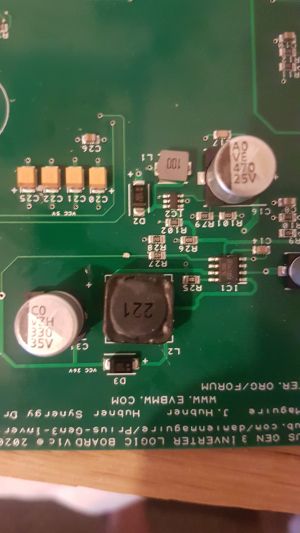

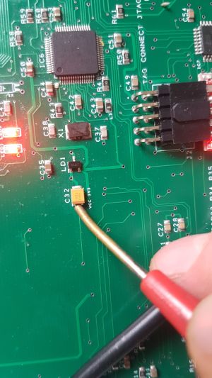

Checking voltages

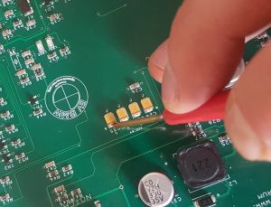

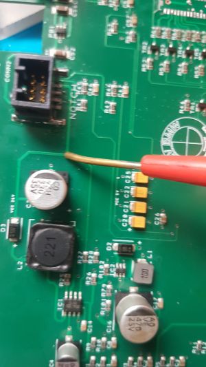

Check for ~3.3v here on C32
Check for ~5v here on C21/C20/C22/C25
Check for -5v here on the little via next to CONN7 or right next to CONN2 there's a via with -5V under it.
Finally the 26v

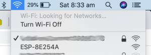

Wifi Module Firmware
The WiFi module supplied as part of a kit will have the default SSID of inverter and a password of inverter123
My wifi module came with the firmware already installed, but if yours didn't follow the outline steps below. You will need a 3.3v USB to Serial adaptor.

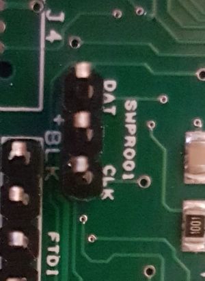

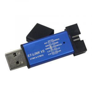

Below are instructions for using the single wire programming interface with the USB STLink V2[2].
Connect the 3 wire pin headers to the programming device.
The pin labeled DAT on the board should connect to SWDIO
The middle pin of the 3 pins on the board should go to GND on the STLink V2
The pin labeled CLK on the board should connect to SWCLK
You will also need to hook up power to the board. You can connect the 5V output of the STLink to the 5V pin of the FTDI header. This is the third pin from the left, where pin 1 is just below the letters BLK on the board.

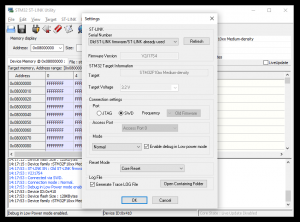

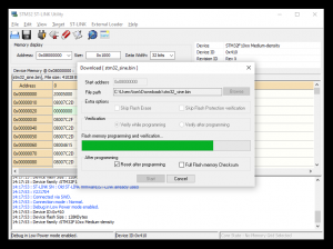

For Windows
Grab the custom bootloader (the .bin file) from https://github.com/jsphuebner/tumanako-inverter-fw-bootloader/releases
Install the ST Link software from here: https://www.st.com/content/st_com/en/products/development-tools/software-development-tools/stm32-software-development-tools/stm32-programmers/stsw-link004.html
Run the software then select Target>Connect and then Target>Settings to check that your USB device is connected and that the settings look as follows:
Select File>Open and choose the bootloader from its download location. Then select Target>Program & Verify and you should see this:

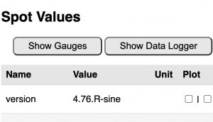

Once the bootloader has been programmed the main firmware can be uploaded and upgraded via the web interface.
The main firmware can be found here: https://github.com/jsphuebner/stm32-sine/releases
A wifi network should be visible with the name "inverter" connect to it with password "inverter123"
Once connected open a browser and navigate to http://192.168.4.1 and find the update section, upload the firmware.
Once this has completed you can verify by scrolling to the Spot Values section and you'll see the software version

Using a scope, look for a PWM signal on MG2 A/B/C Hi/Low on the 50 pin connector. R74 through R79 can be used as test points for the PWM signal - these are located next to the 50 pin connector as shown in the image below.
Partial shot of the 50 pin connector showing the location of the resistors which can be used as test points to check for the PWM signal on MG2 A/B/C Hi / Low.

As per the assembly instructions above this needs to be enabled via the jumper on the control board.

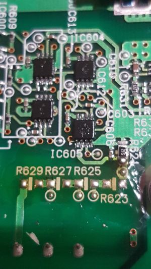

Modifying the DC DC converter resistors
The DC DC converter in unmodified state will startup at a little over 100v and shut down at around 240v, to use it with a higher voltage it needs to be modified by changing some smd resistors.
See https://www.youtube.com/watch?v=Nu5_OBOPk4s&t=2s

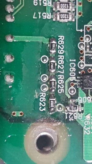

You'll need to remove the bottom cover of the inverter to expose the DC DC converter control board.
We need to replace 4 resistors on the top side of the board, these are R629, R627, R625, R623, currently 120k ohm, these will need replacing with 210k ohm
(1%, 0.5W, 0805, Manufacturer part#: ERJP06F2103V Farnell #: 2326773 )
These are the 4 resistors on the top.
And Replace
There's also 4 resistors to replace on the bottom, these are R630, R628, R626, R624, these also need to be 210k ohm.
The bottom resistors are up next to the flexible cable, on the underside of the board, to access them, unscrew the 4 screws holding the board in place, unplug the black connector carefully lift the board upwards.
Bare in mind the flexible cable is still attached and is soldered directly to the board. Flip it over.
Bottom side replaced. You can now place the board back in place, screw the 4 screws in and don't forget the black plug.
Replace the bottom metal cover.

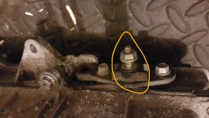

The 12v battery positive connects to this post, it'll output ~14v when the DC-DC is running to keep the battery charged, the negative terminal of the battery should be connected to the case of the inverter.

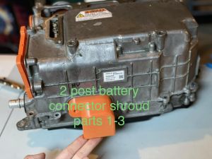

High Voltage Battery Connection
The HV battery connection is below, DO NOT directly connect the battery here. It needs to be connected via contactors and a pre-charge resistor. This connection point by-passes the buck/boost converter.

Motor Connection
If you are only using MG2 to power a motor, and not paralleling MG1 and MG2, connect your 3 phase wires from the motor to the outer 3 terminals.
Some versions of this inverter have the U-V-W labels for the three phase wires stamped into the case and some do not. These are shown below in case you have a version of the inverter without them and need to connect to a motor other than the originial prius transaxle.
Parallel MG1 and MG2 on a single motor
MG1 and MG2 can be used in parallel for more power, to do so there's some solder jumpers on the board to use. Jumpers SJ1 to SJ6 need soldering across the little gap between them.
You then need to connect MG1 phase 1 to MG2 phase 1 and so on. This needs to be done before the the current sensors so that all the current goes through MG2 current sensors on the phase bars, otherwise the software cannot measure the current correctly.
IDC Connector
If you are not using the AMPSeal daughterboard, you can connect directly to the 34 pin IDC connector on the EVBMW board.
Connections are as follows:
Pin Number Label Description
1 12V_IN Provide with +12V supply from battery or power supply for testing
2 12V_IN Provide with +12V supply from battery or power supply for testing
3 MG2_FORW_IN Active high signal at 12V (switches at >7V) to tell the inverter which way to spin the motor. Take positive feed from 12V battery or supply and wire through a three position switch, with the switched connections running to forward and reverse.
4 MG2_REVER_IN Active high signal at 12V (switches at >7V) to tell the inverter which way to spin the motor. Take positive feed from 12V battery or supply and wire through a three position switch, with the switched connections running to forward and reverse.
5 MG2_START Active high signal at 12V (switches at >7V) to start the inverter and move it from pre-charge to run mode. Typically connected to the momentary 'START' position of your ignition switch.
6 MG2_BRAKE_ON Active high signal at 12V (switches at >7V) to inform the inverter that the car is under braking. Typically takes a feed from the brake switch that also turns on brake lights etc.
7 CRUISE_IN Active high signal at 12V (switches at >7V) to turn on cruise control mode. This sets the current motor speed as the set point for cruise control. Cruise control is disabled by a signal from the brake switch.
8 VCC_5V +5V supply for temperature and throttle sensors
9 MG2_ACCEL 5V analogue input from first channel of throttle sensor. These typically take a 5V supply and ground and return to this pin a variable voltage that indicates throttle position.
10 MG2_BRAKE_TRANS 5V analogue input from second channel of throttle sensor. These typically take a 5V supply and ground and return to this pin a variable voltage that indicates throttle position.
11 GND Common ground for 12V supply or 5V return.
12 GND Common ground for 12V supply or 5V return
13 CAN_EXT_H CANBus digital communication connection for remote interface with inverter
14 CAN_EXT_L CANBus digital communication connection for remote interface with inverter
15 VCC_5V +5V supply for temperature and throttle sensors
16 MG2_ENC_1 Can be either digital input for encoder (in which case, connect the relevant encoder output here and provide the device with 5V and ground), or one of the two connections for the SIN winding if you are using a resolver for motor position.
17 MG2_ENC_2 Can be either digital input for encoder (in which case, connect the relevant encoder output here and provide the device with 5V and ground), or one of the two connections for the COS winding if you are using a resolver for motor position.
18 GND Common ground for 12V supply or 5V return
19 MG2_COSA Connect SIN winding of motor resolver here and to Encoder Channel A
20 MG2_SINA Connect COS winding of motor resolver here and to Encoder Channel B
21 MG2_EXCA Connect exciter winding of motor resolver here and to ground
22 GND Common ground for 12V supply or 5V return
23 MG2_STATOR_T1 5V output for the motor temperature sensor. These are typically variable resistance devices. Connect one side of the sensor here.
24 MG2_STATOR_T2 Input from motor temperature sensor. Connect the other side of the sensor here. (Note the board correction above. Do not connect if it hasn't been addressed by a new revision or work around)
25 MAIN_CON Open Collector (Will switch the ground side from disconnected to ground).
Connect one side of the contactor coil to +12v and the other to this pin. Your contactor will need either a built in economiser or additional circuit. MAX 2 amp.
26 PRECHG_RLY Open Collector (Will switch the ground side from disconnected to ground).
27 AC_CON Open Collector (Will switch the ground side from disconnected to ground).
28 HV_CON ?
29 AC_PRECH Open Collector (Will switch the ground side from disconnected to ground).
30 GND Common ground for 12V supply or 5V return
31 EVSE_PROX
32 CONTROL_PILOT
33 CHG_CANH CANBus digital communication connection for remote interface with charger
34 CHG_CANL CANBus digital communication connection for remote interface with charger
Ampseal Socket & Plug
There are multiple part numbers for the large 35 way Ampseal through hole socket, with small mating differences, be sure to get a matching pair.
TE connectivity 776164-1 (female) and 776163-1 / 776231-1 are a matched pairs[3]. 776231-1 is the vertical header he uses in the video.
AMPSeal socket (male) in 3D printed surround with pins marked
The AMPSeal connector is wired as follows:

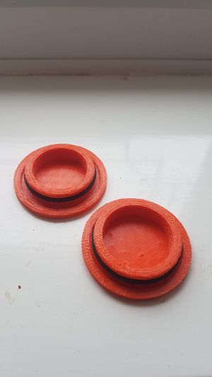

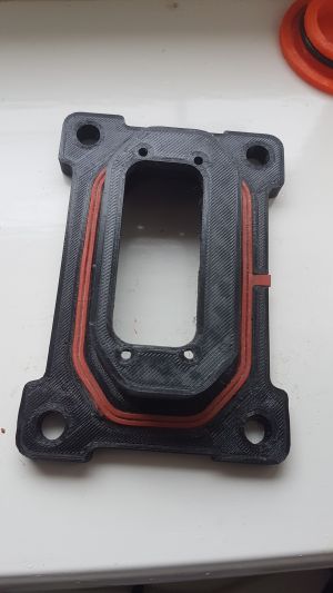

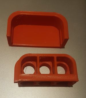

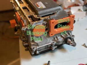

3D Printed Parts
User bobby_come_lately has created a fair few 3D printable parts for use with the inverter. They can be downloaded https://github.com/jamiejones85/Gen3PriusInverter3DParts
More information on these parts can be found in this forum post https://openinverter.org/forum/viewtopic.php?t=836
3D Printed Part Locations
Left side
Right side
Front
