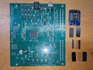

Zombieverter Parts

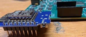

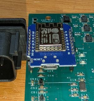

You need to solder the pin header to the Wifi board, and the smaller pin socket to the Zombieverter board. Since they both fit loosely, it's is best to plug the pin header into the pin socket, then set the stacks into the holes on the board, and set the wifi unit on top - getting all the pins into the holes. This will be wobbly and won't sit up straight on it's own. I set a block to the side that both the boards would touch, holding them upright. I then carefully soldered the pins on the wifi unit. The reason you have everything plugged together is to make sure that the pins will perfectly line up with the sockets.
Shows which connector is soldered to which board.
Propping up the wifi on the loose connectors.

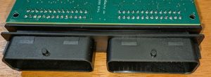

Then turn the Board over, and solder the socket pins to the Zombieverter. Keep the Wifi board plugged in to be sure the sockets stay aligned properly! You'll need to find something to prop up the other side of the Zombieverter board so that it's level. The next step is to solder the big multi-pin connector that hooks to everything else. I bought the Enclosure Kit, which comes with the connectors. Since the connector fits tightly to the board, you just need to carefully sqeeze the board down over the pins, and make sure it's pressed down for the full length of the connector. Then you can just solder all the pins.
Large connector soldered to board
