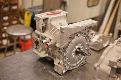

EM61
EM61 Dimensions
em61 motor tear down
The em61 motor was used in the first generation nissan leaf. It's a stand alone ipmsm motor, with a theoretical peak power output of a 250kw+.
Regarded as nissans "r&d" motor, being the presents of stronger rare earth magnets. resulting in a slightly higher torque output efficiency than the gen2 em57 motor.
In the stock OEM leaf, the motor was battery and inverter limited to 80kw and made 280Nm of peak torque.
The EM61 made its debut in 2010. It was used only in the first generation Nissan Leaf (ZE0 2010-2012).
