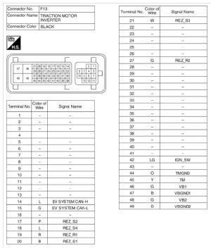

setting up a leaf stack with the zombiverter VCU
the full leaf stack ( motor/inverter, pdm (charger, dcdc, hvjb)) can be controlled with the zombieverter VCU
all you need is 12v and CANbus
wiring
wiring the zombiverter to the leaf harness
the motor/inverter and PDM each use there own canbus
wire canbus1 to the motor/inverter
wire canbus2 to the pdm
leaf inverter connector pinout
then select them accordingly in the zombiverter web interface
pinout of the pdm
zombiverter pinout
em57 resolver pinout
