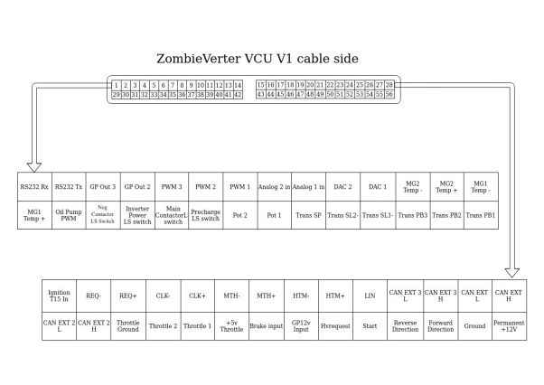

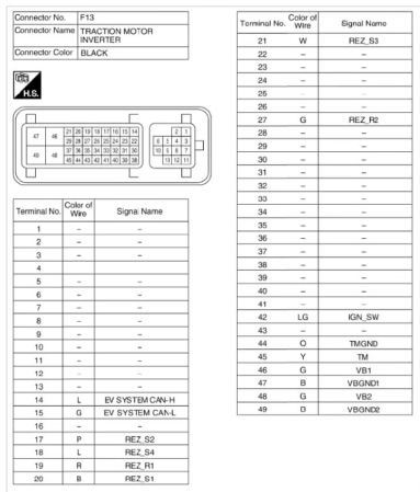

inverter to zombie wiring:
EV SYSTEM CAN-H (pin14)  to  CAN EXT H (pin 28)
EV SYSTEM CAN-L (pin15)  to  CAN EXT L (pin 27)
PDM to zombie wiring:
CAN H (ev system) pin 27 to CAN EXT 2 H
CAN L (ev system) pin 11  to CAN EXT 2 L
[[File:ZombieVerter VCU V1 cable side pinout2.jpg|thumb|zombiverter pinout|left|602x602px]]

[[File:Leaf inverter pinout.jpg|thumb|leaf inverter connector pinout|449x449px]]

setting up a leaf stack with the zombiverter VCU
the full leaf stack ( motor/inverter, pdm (charger, dcdc, hvjb)) can be controlled with the zombieverter VCU
all you need is 12v and CANbus
wiring
wiring the zombiverter to the leaf harness
the motor/inverter and PDM each use there own canbus
inverter to zombie wiring: EV SYSTEM CAN-H (pin14) to CAN EXT H (pin 28)
zombiverter pinout
