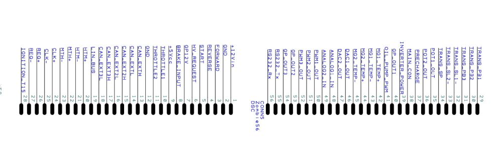

Setting up a leaf stack with the zombiverter VCU
The full leaf stack ( motor/inverter, pdm (charger, dcdc, hvjb)) can be controlled with the zombieverter VCU.
All you need is 12v+, enable, and CANbus.
As of software release V2.20A, the IVT shunt used for UDC data is no longer required for precharge.
The leaf Inverter itself can supply UDC data for precharge (set the Shunt Type = 0)
Wiring
Wiring the zombiverter to the leaf harness
INVERTER to zombie wiring:
EV SYSTEM CAN-H (pin14) to CAN EXT H (pin 28)
EV SYSTEM CAN-L (pin15) to CAN EXT L (pin 27)
PDM to zombie wiring:
CAN H (ev system) pin 27 to CAN EXT H (pin 28)
CAN L (ev system) pin 11 to CAN EXT L (pin27)
EVSE CONNECTING SIGNAL pin 29 to
EVSE COMMUNICATION (PWM) pin 30 to
Pinout
Description | Zombieverter Pin | PDM pin | inverter pin | |
+12V | Permanent 12v+ | 56 | 18 | 46, 48 |
Gnd | permanent 12v - | 55 | pdm case | 47, 49 |
Fwd signal | Forward | 54 | ||
Rev signal | Reverse | 53 | ||
momentary 12V | Start signal | 52 | ||
Brake signal | Brake Input | 49 | ||
+5V | Throttle | 48 | ||
Throttle signal 1 | Throttle signal 1 | 47 | ||
Throttle signal 2 | Throttle signal 2 | 46 | ||
Throttle Gnd | Throttle Gnd | 45 | ||
Precharge Contactor LS Switch | Negative lead from precharge contactor | 34 | ||
Main Contactor LS Switch | Negative lead from main contactor | 33 | ||
enable relay | switches enable relay | 32 | 16 | 42 |
Neg Contactor LS Switch | Negative lead from negative contactor | 31 | ||
CANEXTH | Can 1 High | 28 | 27 | 14 |
CANEXTL | Can 1 Low | 27 | 11 | 15 |
T15 | Ignition 12V in | 15 | ||
proximity pilot | pp for charge port | 29 | ||
control pilot | cp for charge port | 30 |
Chademo to Zombiverter:
chademo connector:
HV contactor coil + pin 2 to GP 12v input
HV contactor coil - pin 10
pin 1 to ground
CAN H pin 8 to CAN EXT 3 H
CAN L pin 9 to CAN EXT 3 L
pin 4 to GP out 3
