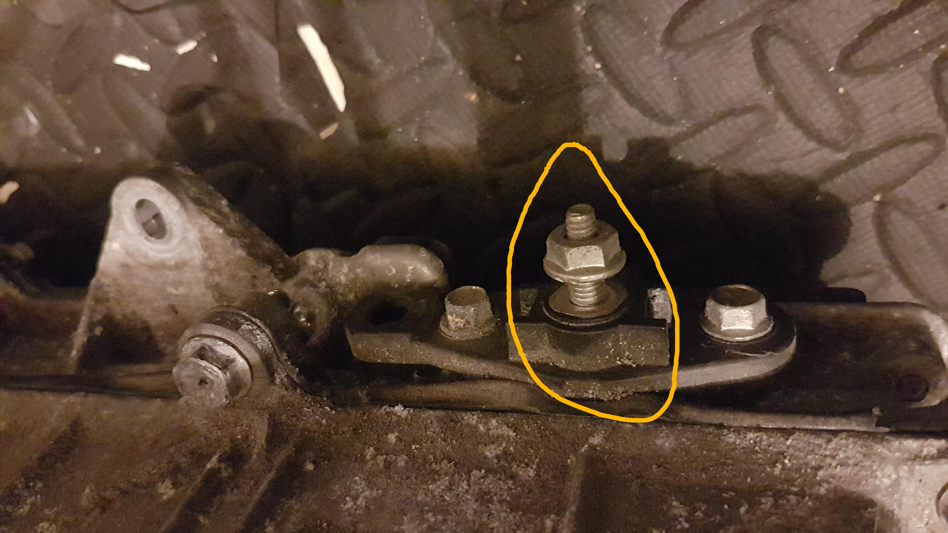

12v Battery Connection
<figure-inline class="mw-default-size">20200705 190706.jpg</figure-inline>
