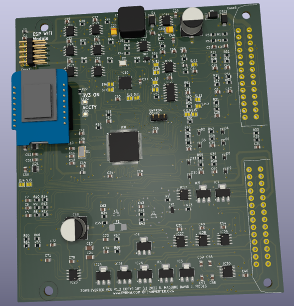

[[File:Zombie model.png|thumb|614x614px|ZombieVerter VCU board (NOTE: V1.2 is preproduction, V1.a is the current latest hardware revision)]]

==Hardware==
[[File:Zombv1boardb.jpg|thumb|alt=|Location of remaining parts]]
So you've ordered your kit, first things first, watch the following two videos to assemble it.
Due to chip shortages (written summer 2021) the board isn't fully assembled so you will need to do some soldering, or take it to a local phone repair shop (or similar) who'll find soldering at this scale like playing with Duplo (Legos to you Yanks).
{| class="wikitable"
|+Parts to be fitted to ZombieVerter VCU
!Name
!Part Numer
!Alternative Part Number
|CONN1
|IC10
|MCP25625T
|IC14
|TJA1020
|MCP2004
|IC19
|NCV7356
|IC20
|TJA1055T
| IC21, IC22
|AD5160
|IC27, IC28, IC29
|FAN3122
NOTE : R50 will need to be changed to 1k and C45 to 1n in order for LIN to work properly. This will be amended on further builds. So if you have a board ordered before 14/03/24 this change is required.

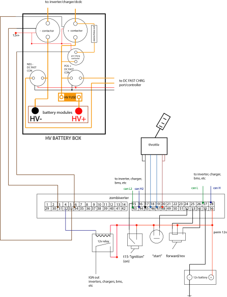

== Wiring ==
[[File:ZombieVerter VCU V1 cable side pinout2.jpg|thumb|alt=|VCU pinout diagram |513x513px]]Each device requires different wiring setups, settings and power requirements.
00:01:02
<nowiki>*</nowiki>cross referencing OEM wiring diagrams is highly recommended

=== Power wiring ===
The ZombieVerter requires a permanent 12V supply. This is so it can manage charging, timers, and monitor systems when the car is at rest.
And quite a few if not all of the electric drive components so this guy kind of acts as an interpreter it will take in things like our ignition switch throttle pedal various communication from the car spit out what the drivetrain may need and do the reverse as well to keep both the car and the uh drivetrain components
The average power draw, at idle, is 150 mA.
00:02:06
* Pin 55 to 12V- ground
* Pin 56 to 12V+ positive
Happy now the aim of this particular design is to take away the programming element that is quite daunting to some people including me and make it a simple menu driven system that can be accessed over what wi-fi just using a web browser based upon the open inverter system so if you want some more information on this i do have another video
The ZombieVerter controls power/"ignition" signals to other devices (inverters, chargers, and DCDC converters), powering those devices when required. This is done by triggering an external 12V relay. '''''ZombieVerter controls the external relay using low-side switching'', meaning that it pulls the ground pin of the relay to ground.'''
00:02:43
* [[File:Gernice-zombie.png|thumb|583x583px|general zombie and battery box wiring]]Pin 32 to ground pin on a 12V relay
* Relay positive pin to 12V+
* One of the relays switch pin to 12V+
Uh that gives a lot more detail on the kind of overview so i will link that in the description also but today what we're going to do is we're going to focus on the physical assembly uh that is required on the board so first thing how do we get one well currently there are two ways uh the first is that you can purchase this board
This effectively provides a switched 12V supply, controlled by the ZombieVerter.

=== Contactor wiring ===
The Zombieveter manages the Negative, Positive and PreCharge contactors in an EV conversion.
Euros a month tier to access those design files as of now once you would then have those files you can of course cancel that patreon membership and go ahead and get boards made by any of the uh pcb makers like pcbway or jlc pcb and there'll be links in the description to both of those companies also so um once you then have the board as we see here
This is done based off a series of voltage measurements (UDC), this voltage value (UDC) can be supplied from a variety of sources:
00:04:27
* ISA IVT shunt
* Nissan leaf inverter
* BMW S-BOX
* etc.
First thing that you can spot is that there are some components missing that is because due to the i guess the chip shortage stuff there's a few of the components on here that are not available from the board builders so what are those components would be the first thing that we need to work out so um
''Without a proper UDC measurement, the ZombieVerter '''will fail precharge and never go into run mode.'''''
00:04:59
Starting from the top here you'll see ic 19 it's a little eight pin soic uh packet this is this guy here ic 19 is an ncv 7356 single wire can transceiver one of the protocols that we support here at least in hardware so far is single wire can this can be useful
'''The contactor control pins on the ZombieVerter are ''low-side switching'', meaning that they pull to ground.'''
00:05:38
The positive leads from the contactors need to be connected to 12V+ and the ground leads to:
For such things as the chevy volt heater cabin heater that is which i actually have installed in my e46 touring and we will be using this very board in that vehicle the next device then that you will see is ic10 which is this qfp part which is an mcp25625 so this guy is a is a spi can controller and transceiver because we have three can with three can channels on this board
* Pin 31 for the negative contactor
* Pin 33 for the positive contactor
* Pin 34 for the pre-charge contactor
=== Throttle pedal wiring ===
The ZombieVerter supports dual-channel throttle. This redundancy is for safety in case one channel fails or drops out. It's highly recommended to use dual-channel throttle. Single-channel is an option.
00:06:25
Connect the following to the ZombieVerter pins:
Finally then we have these um guys here ic5 say 7 ic577c 24 25 26 1 and 3 and those are these ncv 8402 kind of load driver mosfets so before we can do anything with the board we need to fit these components now as i say if you do purchase the board from me you will receive these parts in
* Pin 45 to throttle grounds
* Pin 46 to throttle channel 2
* Pin 47 to throttle channel 1
* Pin 48 to throttle positives
00:07:02
=== Start, Run, and Direction wiring ===
The ZombieVerter requires 2 inputs to get into "drive" mode. '''These pins need to be ''pulled high'' (connected to 12V +)'''
Your kit along with a wi-fi module and adapter header which we will show you later on but for now we need to go ahead and fit these components so you might say to me at this point well do i really need to fit these and the the answer is it depends what you plan to do i'll be 99 certain you would need to fit the the
* Pin 15 to "on" switched input (key switched to "on")
* Pin 52 to "start" momentary input  (momentary key switched "ignition")
00:07:37
==== Forward and Reverse ====
Ncv8402s because they're used for things like controlling contactors and so forth so you will definitely more than likely anyway need to fit these parts the ic10 and ic19 will depend if you intend to use the third can channel or and or if you intend to use single wire can but just for the sake of completeness here with this
* Pin 53 reverse
* Pin 54 forward
00:08:05
==== Brake signal ====
Uh video we'll go ahead and fit those components anyway so nothing to do what to do it as they say and we'll be showing you the enclosure system uh later on in the video also i'm going to make some space now here and we'll get straight into it apologies for the background noise it is feeding time for the boards after minutes so they're
* Pin 49 need to be ''pulled high'' (connected to 12V +) when brake is pressed

'''[https://youtu.be/oPb4vMO17B4?t=227s 03:47]''' VCU, wiring harness, 12V battery, ISA shunt, contactors<br />
'''[https://youtu.be/oPb4vMO17B4?t=426s 07:06]''' 12V battery - negative to chassis ground with fuse, and ground to VCU pin 55<br />
'''[https://youtu.be/oPb4vMO17B4?t=472s 07:52]''' 12V battery - positive to PDM positive terminal and distribution block<br />
'''[https://youtu.be/oPb4vMO17B4?t=522s 08:42]''' 12V battery - permanent fused +12v from PDM positive terminal to inverter and PDM<br />
'''[https://youtu.be/oPb4vMO17B4?t=554s 09:14]''' 12V battery - permanent fused +12v to vcu, relay controlled by VCU for switched +12v to inverter and PDM<br />
'''[https://youtu.be/oPb4vMO17B4?t=641s 10:41]''' 12V battery - permanent fused +12v to contactor coil positives<br />
'''[https://youtu.be/oPb4vMO17B4?t=657s 10:57]''' 12V battery - permanent fused +12v to switch to provide things like T15 on signal to VCU<br />
'''[https://youtu.be/oPb4vMO17B4?t=762s 12:42]''' Other end of permanent 12v feed to inverter and PDM connections<br />
'''[https://youtu.be/oPb4vMO17B4?t=803s 13:23]''' Other end of switched +12v feed to inverter and PDM connections<br />
'''[https://youtu.be/oPb4vMO17B4?t=816s 13:36]''' Other end of switched 12v ground connection<br />
'''[https://youtu.be/oPb4vMO17B4?t=838s 13:52]''' Twisted pair wires from EV CAN CAN EXT 2 High (pin 28) and CAN EXT 2 Low (pin 27) to inverter<br />
'''[https://youtu.be/oPb4vMO17B4?t=946s 15:46]''' To use the PDM for charging, wire control pilot (CP) and plug present (PP) from PDM to charge socket<br />
'''[https://youtu.be/oPb4vMO17B4?t=989s 16:29]''' High voltage setup and controlling it with the VCU<br />
'''[https://youtu.be/oPb4vMO17B4?t=1028s 17:08]''' Positive and precharge contactors (only 2 for the test rig - usually would have a negative contactor as well)<br />
'''[https://youtu.be/oPb4vMO17B4?t=1060s 17:40]''' High voltage positive and negative junction. The ISA shunt connected between negative and PDM to distribute high voltage negative to the components<br />
'''[https://youtu.be/oPb4vMO17B4?t=1093s 18:13]''' V1 ISA shunt connection to PDM after the contactors/precharge system to monitor high voltage applied to the drivetrain<br />
'''[https://youtu.be/oPb4vMO17B4?t=1131s 18:51]''' Contactor control using negative side connections via VCU (very brief description)<br />

'''[https://youtu.be/oPb4vMO17B4?t=1545s 25:45]''' Control switches. +12v, forward input, terminal 15 input, start input, high voltage request input. <br />
'''[https://youtu.be/oPb4vMO17B4?t=1584s 26:24]''' Step 1 is close switch providing +12v to the forward input and T15 connections to enable "ignition on" mode<br />
'''[https://youtu.be/oPb4vMO17B4?t=1605s 26:45]''' Step 2 is toggle start input to activate precharge, closing of main contactor, and inverter main relay (assuming all conditions are met)<br />

Enclosure and we have our connector attached as per our wiring pin descriptions from the last video we come down here to this bundle then it explodes out into this bit of a mess job here but in reality if we take this slow and steady uh we take each wire individually it's it's actually not that difficult at all here we've just got a 12 volt battery which is a normal car battery that
00:04:27
Supplies low voltage power to our systems here and of course to our vcu got some more wires and stuff going on here at the back this is where we connect into our nissan leaf wiring and i'll go through all that with you uh shortly and here we have our isa shunt now this one looks a little different to the one we showed you in the last video it's a slightly older model but
00:04:59
Works the exact same way and down here then we have some contactors uh for controlling the high voltage you can see here that i've got got a white which would be our high voltage battery positive and a black which would be our high voltage battery negative so a bit of high voltage wiring going on and a bit of low voltage wiring going on
00:05:26
And we connect in there to our vcu so let's start uh with our 12 volt battery here as we would in a traditional i suppose wiring diagram for a car and we'll break it down as easily as i can for you one of the things folks always ask me about is to have a wiring diagram for this or a wiring diagram for that and that
00:05:55
The answer to that is no i do not because there's two reasons for that one is i can't do everything because if i do one wiring diagram and i want three more and it just tends to snowball a little bit and the second thing is i'm absolutely crap at drawing and i did actually try this with some of the tesla stuff to draw diagrams and then i tried to get a few uh professional people to
00:06:27
Convert those squiggles into actual you know electrical drawings for me but that didn't work out either it ended up costing me quite a bit of money so unfortunately folks that is not my forte so we're going to have to go with what i can do here and that is to describe to you this setup um and it's actually once we get into it you'll see that it's uh it's actually a lot simpler than something that you would do even with
00:06:59
The likes of a standalone ecu for an internal combustion engine alrighty so here we are most basic place to start is our 12 volt battery negative terminal as in any system this battery negative terminal i just have it connected via a fuse to this cable and it's going to chassis or ground or just bolted on to any convenient part of our
00:07:35
System here i then have this black wire here which is again just attached to a chassis ground here and this is our ground connection to our vcu coming across here we have our 12 volt battery positive and this wire is a ticker wire again the same as this one be a main feed we come up onto our pdm this is our pdm
00:08:07
Battery positive and so this is our 12-volt battery positive and anything on the casing is our 12-volt battery ground here you'll see i've got two fuse holders which just uh pop the cover off that just little standard i think five amp just blade fuses in them a lot of this is just for convenience here on the testing rig
00:08:35
So one of these has a little multi-block on it and it goes off to various places and i'll explain that in a minute we'll take the simpler one first this one i just has a single wire and i'll bring you around the side in a sec but where this single wire goes is this just supplies permanent 12 volt power both to our pdm and to our inverter so this fuse here just curls around with a bit
00:09:06
Of wire and gives a 12 volt positive feed inverter and pdm simple as that this wire here breaks off into a little junction block so let's take each one of these individually this one here is our 12 volt positive feed to our vcu so we just come from the battery through a little fuse this gives our vcu permanent uh 12 volt power this wire here
00:09:44
Goes down to just a standard four pin automotive relay and this relay is controlled by the vcu and it lets it switch on and off the switched 12 volt feed to again our inverter and pdm so when we're waking up our system be it for charging or for driving the vcu through a low side switch on the coil here can energize this relay and apply the switched power to our inverter and pdm
00:10:25
Those are the only power feeds that we need for our system here so we take one more wire sorry two more wires off this this wire here is going around the back and is supplying our contactor positive feed so the 12 volt permanent dc supply to our contactor coil
00:10:54
Positives and finally this guy here goes up to a switch that you will just see crudely screwed onto the corner of the bench here and we use that first for supplying our digital 12 volt signals to the vcu so things like terminal 15 on so our ignition switch on and our start signal so our momentary switch to the start signal and i'll run through
00:11:27
That again in a bit more detail but these are our basic 12-volt feeds here from our battery to our pdm and via just one standard four pin relay for the switched feeds and just via a fuse for the permanent feeds and folks that is that is as complex
00:11:53
As we get here with a system like this in terms of just supplying power to it the vcu via the white wire here controls the low side of the relay coil so what i'm going to do next i'm going to switch the camera around and we'll bring you around this side here and show you uh where for example our 12-volt permanent feed and our 12-volt switched feed from the relay enter we show you where we connect the can bus to

Inverter and pdm with our vcu alrighty so next thing we need to look at is our whole high voltage setup and how we control that with our vcu now this is not intended to be any kind of an educational segment for people on how to handle hive voltage because i ain't going to touch that but what we will do
00:16:53
Is show you for our very basic test rig here how the um how the uh how we do it here now as you'll see here we've got these two black devices here these are our contactors normally in a high voltage system like this we would have three of them we'd have one on our net negative side one on our positive side and one for
00:17:23
Pre-charge now in the case of my simplistic little test rig here i'm just using two a main positive contactor and a pre-charged contactor and that's because this is only a temporary set up here so if we look up here on the bench we have our high voltage battery positive and our high voltage battery negative
00:17:49
We have our isa shunt connected here to the high voltage battery negative then we come out of this with a cable that we bring to our pdm and that basically distributes high voltage negative to our charger inverter dc dc and whatever it is that we would be using this little wire here which comes out of the the v1 monitoring connection on our um
00:18:22
Isa shunt and that connects into pdm to the battery positive after the pre-charging system so we connect our monitoring tab after our contactors and pre-charge so that this guy is monitoring the high voltage that we're applying to our i guess drive train uh would be the would be the uh the shortened term so contactor control
00:18:53
Is entirely via our vcu and what we do is again let me just leave it here a little bit and you'll see i have a red wire that i spoke about earlier this is just bringing permanent 12 volts from our fuse from our 12 volt battery positive into the coil positive terminals of our two contactors and the two black wires then which you'll see here are being switched via
00:19:24
Direct relevant pins on the vcu so it being uh pre-charge low side switch and main contactor low side switch that's why we have a permanent 12 volts on our coil positives and we switch on the blacks or negative side of our coils we just have a crude little set up here then with our pre-charge and our main contactors just using a heater element here for that purpose and finally we come out of this wire
00:19:59
Here which is our high voltage positive after our pre-charging and contactors and go into our pdm so what i'll do is i'll pop the cover off the pdm here and you can have a look in here and it'll hopefully make a little bit more sense of where we're connecting things i'm not going to go into a huge amount of detail on this because like i said that is a topic entirely by itself uh one thing i will just note with a
00:20:29
Little four core wire here going into our isa shunt so just to remind folks the isa shunt is our battery monitoring system and it basically informs the vcu about voltage current temperature amp hours kilowatt hours and all that good stuff and it does that via can so all we need to do we've got a red and a black wire here which is a permanent 12-volt supply and we have a green and a yellow wire
00:21:02
Which is our can high and can low and we connect those to the relevant uh can external too low and can external two high pins of our vcu and indeed they simply then come back down so we're linking our can here uh from our drivetrain with our can from our shunt so literally that is it uh from a
00:21:33
Wiring up of a drivetrain and our shunt here so i'll go ahead and pop the lid off the pdm and we'll show you where the wires connect here just to kind of familiarize volks a little bit more with that and finally then we'll show you where our charging socket connects up all right just pop the lid off the uh pdm here there we go okay
00:22:09
So let's get you in a little bit neater here you'll hopefully be able to see some of the wiring so you'll see here that i've marked these two copper terminals that are red and a blue i put a plus and a minus there beside them those are our main high voltage battery connection terminals
00:22:31
So this is where we come in after our contactors with our pre-charge in our main contactor this is our battery negative which would normally be going to a battery negative contactor and then heading off towards our battery you'll notice that there's two wires on the positive the reason for that is one of them brings in our
00:22:58
High voltage positive and the other one is our little monitoring wire here from our isa shunt so super simple i'm going to talk to a little bit about how we connect up ac charging to the pdm as well just because we're here it'd be a shame not to so i just got a piece of tree core cable here this is a single phase six kilowatt charger so green and yellow earth are ground brown is our live or hot and blue is our
00:23:31

Now here we go sorry about that folks gome just reappeared now what is this well these are just light switches like you'd have in a domestic house so turn the light on turn the light off i'm just using them in this case to control some of our digital signals to our vcu got a red wire here just a 12 volt
00:26:03
Battery positive i've got some wires here from our vcu of our forward input i have our terminal 15 input i have our start input and have our high voltage request input so in this case when we turn on the fourth switch we just apply 12 volts to our forward input and to our terminal 15 input thus telling our vcu that we would like
00:26:36
The motor to turn forward we are on an ignition on position now so we're getting ready to crank up and finally in our second little switch here thank you gom normally what i do with this is just give it a flick which should be akin to giving it a flick of a start um momentary terminal at that point assuming conditions are met the vcu will initiate pre-charge
00:27:07
If pre-charge is successful we'll close the main contactor turn on our inverter relay and we're ready to go for a drive again when we come back home switch off turn our key off and the system shuts down and in order to tell the vcu how much torque that we would like from our motor we of course need a throttle pedal this is a
00:27:36
Throttle pedal from kind of mid-2000s bmw it's on various models this is the one that i generally use because you know kind of cheap easy to get at my local scrap yard and they fit most of the cars that i'm working with so this is the two channel hall effect pedal it has a five volts ground and two signal channels
00:28:03
That we connect to our vcu so when we push our pedal up and down we get two uh variable voltages generated by the pedal which our vcu can then interpret as a driver torque request we'll turn that into the relevant can messages and transmit them to our inverter and uh with whatever kind of throttle ramps and limits that we will have set
00:28:38
In the vcu also the vcu will detect things like if we're parked and we want to do something like charge the car then when we insert our charging plug like so it would assuming conditions are met so we're not in drive mode etc
00:29:06
Initiate pre-charge pre-charge is successful bring up the power to the pdm lock out the inverter from drive mode and commence charging based upon a combination of the parameters that it gets from our charging cable and those set within the vcu okay so we've got ourselves a throttle pedal we have that connected to our vcu

'''Pin Out Diagram'''
[[Leaf stack with zombiverter]][[File:ZombieVerter VCU V1 cable side pinout2.jpg|thumb|alt=|VCU pinout diagram |none]]
[[File:Zomb-con-et2.png|none|thumb|List of connections to system components (GS450 application)]]
[[File:Zombi-leaf-wiring1.png|left|thumb|416x416px|leaf stack to zombie]]
Introduction
An open-source EV conversion VCU (vehicle control unit) for controlling salvaged EV components!
Modern EV conversion projects often look to reuse salvaged parts from wrecked vehicles, such as the motors, batteries and chargers.
The issue is that each of these components and manufacturers, use different methods of control and communication.
Developing controllers for these devices is complex, and time consuming and often require very dedicated communication protocols. Instead of making custom boards for every part that's been decoded, why not just make a general purpose VCU (vehicle control unit) with a verity of different types of inputs and outputs?
Introducing: the "ZombieVerter" VCU - a general purpose EV conversion VCU.
With a large array of inputs/outputs, control logic, and a web interface for configuration and data logging. The ZombieVerter is a powerful, flexible and customizable VCU well suited for EV conversions.
It's also an open source project!
Features
Hardware:
  • On-board WiFi
  • 3x high side PWM drivers
  • 5x low side outputs
  • 3x input pins (pull to ground only)
  • 3x CANbus interfaces
  • LIN bus
  • sync serial interface
  • OBD-II interface
  • etc.

Power wiring
  • Pin 55 to 12V- ground
  • Pin 56 to 12V+ positive
The ZombieVerter controls power/"ignition" signals to other devices (inverters, chargers, and DCDC converters), powering those devices when required. This is done by triggering an external 12V relay. ZombieVerter controls the external relay using low-side switching, meaning that it pulls the ground pin of the relay to ground.
  • general zombie and battery box wiring
  • Relay positive pin to 12V+
  • One of the relays switch pin to 12V+
Used to switch "enable" mode to devices via:
  • Leaf inverter enable pin

Contactor wiring
  • ISA IVT shunt
  • Nissan leaf inverter
  • BMW S-BOX
  • etc.
Without a proper UDC measurement, the ZombieVerter will fail precharge and never go into run mode.
The contactor control pins on the ZombieVerter are low-side switching, meaning that they pull to ground.
  • Pin 31 for the negative contactor
  • Pin 33 for the positive contactor
  • Pin 34 for the pre-charge contactor
  • Pin 45 to throttle grounds
  • Pin 46 to throttle channel 2
  • Pin 47 to throttle channel 1
  • Pin 48 to throttle positives
The ZombieVerter requires 2 inputs to get into "drive" mode. These pins need to be pulled high (connected to 12V +)
  • Pin 15 to "on" switched input (key switched to "on")
  • Pin 52 to "start" momentary input (momentary key switched "ignition")
Forward and Reverse
  • Pin 53 reverse
  • Pin 54 forward
Brake signal
  • Pin 49 need to be pulled high (connected to 12V +) when brake is pressed
