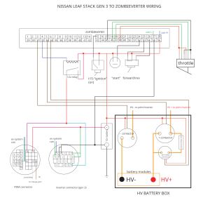

Setting up a leaf stack with the zombiverter VCU
The full leaf stack ( motor/inverter, pdm (charger, dcdc, hvjb)) can be controlled with the zombieverter VCU.
All you need is 12v+, enable, and CANbus. Note: You still need the OEM connection between the Inverter and Motor Temperature sensors and Resolver for things to function.
As of software release V2.20A, the IVT shunt used for UDC data is no longer required for precharge.
The leaf Inverter itself can supply UDC data for precharge (set the Shunt Type = 0)
the PDM is not needed for UDC data.
The leaf motor and inverter do not require the PDM to run with the zombieverter, or for UDC measurements.
Wiring
Wiring the zombiverter to the leaf harness
Pinout

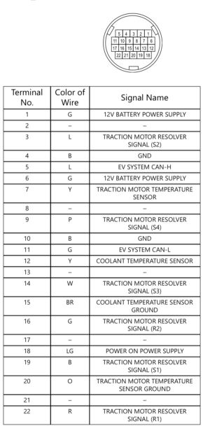

Description Zombieverter Pin PDM pin inverter pin inverter gen3 pin battery pin
+12V Permanent 12v+ 56 18 46, 48 1, 6 5, 11, 14, 17
Gnd permanent 12v - 55 pdm case 47, 49 4, 10 6, 7, 8
Fwd signal Forward 54
Rev signal Reverse 53
momentary 12V Start signal 52
Brake signal Brake Input 49
+5V Throttle 48
Throttle signal 1 Throttle signal 1 47
Throttle signal 2 Throttle signal 2 46
Throttle Gnd Throttle Gnd 45
Precharge Contactor LS Switch Negative lead from precharge contactor 34 10
Main Contactor LS Switch Negative lead from main contactor 33 16
enable relay switches enable relay 32 16 42 18 31
Neg Contactor LS Switch Negative lead from negative contactor 31 13
CANEXTH Can 1 High 28 27 14 5 1
CANEXTL Can 1 Low 27 11 15 11 2
T15 Ignition 12V in 15 4
proximity pilot pp for charge port 29
control pilot cp for charge port 30
Leaf Inverter terminal layout and physical values for signals
Leaf PDM connector pinout and physical values. This seems to apply to 2013-2017 Leaf. Check what you have before blindly making any connections.
Gen3 Nissan leaf inverter pinout
Chademo to Zombiverter:
Nissan Leaf gen 3 to Zombie wiring diagram
Details can be found on a dedicated page.
chademo connector:
HV contactor coil + pin 2 to GP 12v input
HV contactor coil - pin 10
pin 1 to ground
CAN H pin 8 to CAN EXT 3 H
CAN L pin 9 to CAN EXT 3 L
pin 4 to GP out
