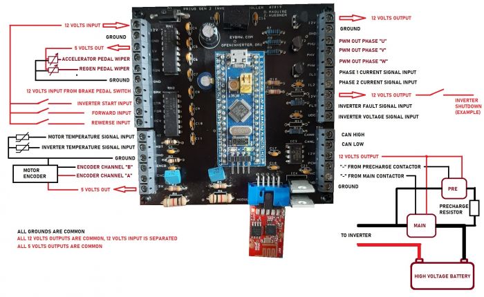

[[File:Prius | [[File:Prius Gen 2 logic board(BluePill-based).jpg|alt=|thumb|700x700px|Prius Control Board - Wiring Map (click to see fullsize details)]] | ||
'''Control Board Pin mapping:''' | '''Control Board Pin mapping:''' | ||

As designed by Damien Maguire, the open source hardware for the control board can be purchased as blank, unpopulated boards on his website: Prius Gen2 Logic Board on EVBMW's Webshop
How To Use
The Prius Gen2 Board is suitable to control any (please add: motor types here) motors.
Note: There is a mistake in the printing on the v1 circuit board. The parts labelled T1, T2, and T3 - which are the small black transistors in the upper right of the board - are all drawn backwards to how they need to be inserted. These parts should be installed with the flat side of the component facing the opposite direction as the printing shows. The flat side should be to the right.
Schematics, Bill of Materials, and other documentation are available on Damien's Project Github (note: flesh out bill of materials here, or post changes to Damien to update his documentation directly?)
The control board utilizes the Blue Pill (link?) micro controller, and takes advantage of the OpenInverter.org software (link?) for control. It is also connected from the outside via the main (32 pin white) OEM connector - try to retrieve this connector and part of wiring loom when sourcing your inverter. Picture of connector further down in wiki.
The control board design incorporates the use of the existing inverter Current Sensors - if FOC option is to be used (Gen 2 Transaxle MG2), bandwidth should be a multiple of control loop frequency which is 8.8kHz. (link to how to modify original setup?)
Functionality of the existing resolver is integrated as well.
Assembly notes? Blue Pill programming notes or just links to Blue Pill section?
Try to get all the wiring harness bits that plug into the inverter when you purchase it. Else, the 32-pin connector inside the inverter part number is: 1318747-1, and the pins to wire it are: 1123343-1

Wire Connections
| Pin # | Designation | Description |
| TB1-1 | 12v-in | Primary 12v supply from ignition on |
| TB1-2 | GND | Primary ground connection to 12v negative. All grounds are common |
| TB1-3 | 5v VCC | 5V supply from board for use with throttle pot or hall pedal |
| TB1-4 | Throttle In | 0-5v variable voltage input from throttle pedal or pot |
| TB1-5 | Regen In | 0-5v variable voltage input. Can be used as second throttle channel or control regen from a brake pressure sensor |
| TB1-6 | GND | |
| TB1-7 | Brake In | 12v digital input from brake light switch. |
| TB1-8 | Start In | 12v digital input from "Start" position on a traditional ignition switch. Momentary action push button can be used. |
| TB1-9 | For In | 12v digital input commands motor to run in forward direction |
| TB1-10 | Rev In | 12v digital input commands motor to run in reverse direction |
| TB3-1 | +12v VCC | 12v output to inverter IGCT terminal (Not on the 32-pin connector, the red wire on the 2-pin connector next to it). |
| TB3-2 | GND | Common ground, but used to connect to inverter GND terminal (Not on the 32-pin connector, the black wire on 2-pin connector next to it). |
| TB3-3 | Phase U |
Phase U output. Connect to Inverter MUU terminal for MG2 inverter drive or GUU for MG1 inverter drive |
| TB3-4 | Phase Y | Phase V output. Connect to Inverter MVU terminal for MG2 inverter drive or GVU for MG1 inverter drive |
| TB3-5 | Phase W | Phase W output. Connect to Inverter MWU terminal for MG2 inverter drive or GWU for MG1 inverter drive |
| TB3-6 | Current U | Phase currents from inverter. Requires external divider circuit. Not required to run motor or inverter. |
| TB3-7 | Current Y | Phase currents from inverter. Requires external divider circuit. Not required to run motor or inverter. |
| TB3-8 | MG2 Enable | Connect to Inverter MSDN to run MG2 inverter or GSDN to run MG1 inverter |
| TB3-9 | MG2 Fault | Connect to MFIV for MG2 or GFIV for MG1 |
| TB3-10 | DC Bus | Connect to inverter VH to measure DC link voltage |
| TB2-1 | +5V VCC | 5v output to encoder for induction motor |
| TB2-2 | ENCA In | Encoder input A |
| TB2-3 | ENCB In | Encoder input B |
| TB2-4 | GND | Encoder ground |
| TB2-5 | HS Temp | Heatsink temp sensor input |
| TB2-6 | MOT Temp | Motor temp sensor input |
| TB4-1 | GND | Common ground |
| TB4-2 | Main Con | Main HV contactor control low side switch |
| TB4-3 | Precharge | HV precharge contactor control low side switch |
| TB4-4 | +12 V VCC | Spare 12v output |
| TB4-5 | CAN L | Can bus low signal |
| TB4-6 | CAN H | Can bus high signal |
