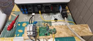

First prototype
One way to DIY an bidirectional charger is the use of a hybrid PV inverter with high voltage battery input. The advantage is that these are mass-produced (thus cheap) and conform to the various legal requirements. The inverter then handles power transfer and optionally smart functions such as zero grid import/export and we only need to supply the surrounding logic and electrics.

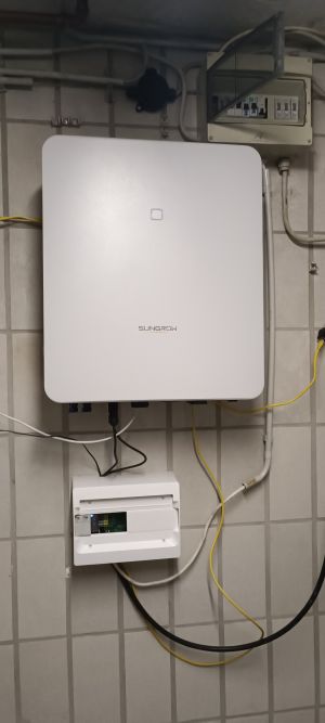

Second version
This component list is just an example that has proven to work. It is preliminary and has not been tested with OEM cars yet, so it will likely be extended. As always, you are working with high voltage and especially grid voltage. Make sure you are qualified otherwise ask for help.
