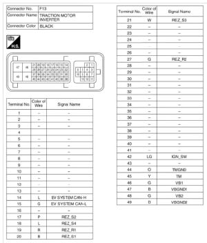

zombiverter pinout
leaf inverter connector pinout
