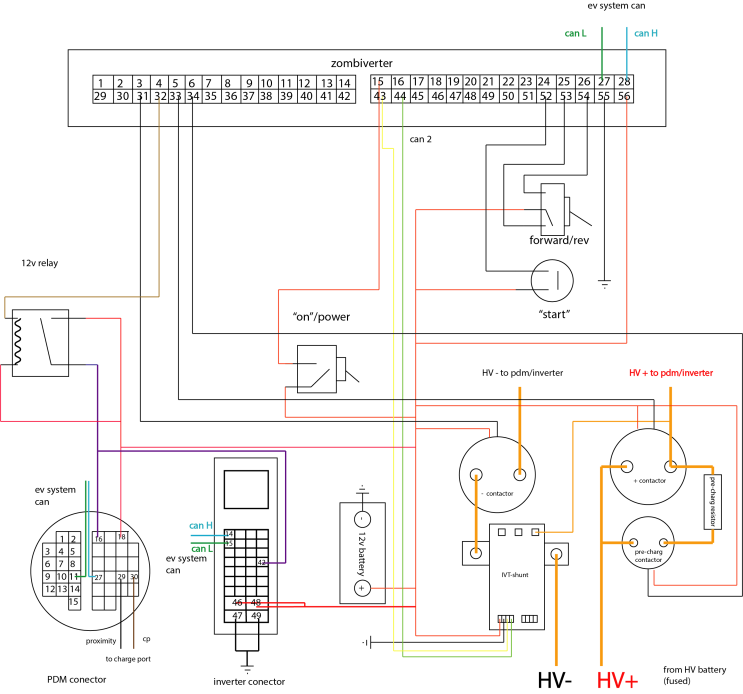

setting up a leaf stack with the zombiverter VCU
the full leaf stack ( motor/inverter, pdm (charger, dcdc, hvjb)) can be controlled with the zombieverter VCU
all you need is 12v and CANbus
wiring
wiring the zombiverter to the leaf harness
the motor/inverter and PDM each use there own canbus. they both can be used independent of one another with the zombieverter.
INVERTER to zombie wiring:
EV SYSTEM CAN-H (pin14) to CAN EXT H (pin 28)
EV SYSTEM CAN-L (pin15) to CAN EXT L (pin 27)
PDM to zombie wiring:
CAN H (ev system) pin 27 to CAN EXT 2 H
CAN L (ev system) pin 11 to CAN EXT 2 L
EVSE CONNECTING SIGNAL pin 29 to
EVSE COMMUNICATION (PWM) pin 30 to

control:
+12v to permanent 12v pin56
ground to ground pin 55
forward switch to forward direction pin 54
rev to rev direction pin53
momentary 12v to start pin 52
hv request turns on hv system with out drivetrain pin51
gp 12v input
brake input braked peddle switch (enables regen, throttle cut out) pin 49
throttle 1 pin 48
throttle 2 pin 47
throttle ground pin 46
ignition t15 pin 15
pot 1 pin 36 fuel gauge driver 0-5kohms
pot 2 pin 35
precharge switch (low side, switching ground) pin 34
main contactor pin 33
inverter power relay for 12v power to inverter pin 32
gp out 1 (general purpose out) can be used to switch the negative contactor pin 31
pdm pin 16 and inverter pin 42 to 12v relay- which is the switch via the low side (-) from pin32 on the zombie
