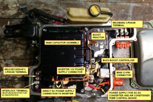

Prius Inverter
Prius Gen 2 Inverter Montage
Internal look at the Prius Gen2 Inverter

The Gen2 Prius (2004-2009 model years) has a variety of useful components inside the inverter package:
  • 2 high power inverters, for the 2 motors MG1 (starter) capable of handling 250 amps, and MG2 (drive motor) capable of handling 350 amps.
  • A DC-DC converter to provide 12v power supply to the automotive systems and accessories.
  • A boost module to boost the 200v battery pack up to 500v, which looks to be able to function as a battery charger (wish list for future development)

Prius gen 2 inverter lower casing internals
The control board utilizes the Blue Pill (link?) microcontroller, and takes advantage of the OpenInverter.org software (link?) for control. It is also connected from the outside via the main (32 pin white) OEM connecter - try to retrieve this connecter and part of wiring loom when sourcing your inverter. Picture of connecter further down in wiki.

Try to get all the wiring harness bits that plug into the inverter when you purchase it. Else, the 32-pin connector inside the inverter part number is: 1318747-1, and the pins to wire it are: 1123343-1
