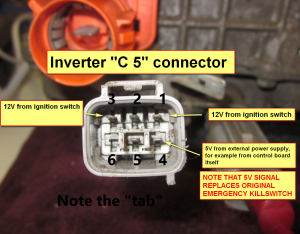

The DC-DC charging connections on the Gen2 Prius Inverter are on the rear, they are "C5" (6 pin gray) & "C6" (1 large pin gray).
Here is what is needed for the Gen2 Inverter DC-DC to work...12v on pins #1 & #3, 5v on pin #4 of connector "C5" (gray one) and the case grounded. It is not required to have a load applied to the large gray 12v connector (C6) to obtain an output.
