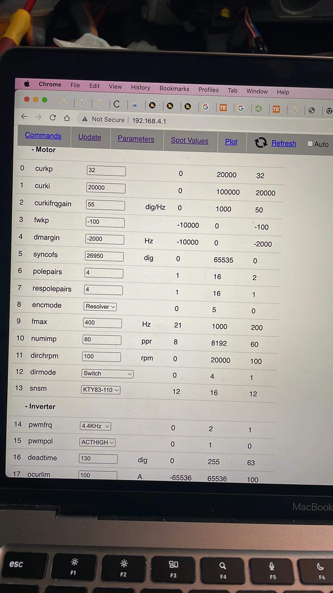

I have throtcur at 4.5, my params are here https://openinverter.org/parameters/view.html?id=30 and once moving I've had phase currents of 450 amps with logs I've taken previously. I do have MG1 and MG2 paralleled though
what's the battery amps? Did you check anything with a clamp meter? I'm ...

Gen 3 prius inverter only 245 amps
Gen 3 prius inverter and em61 motor connected to a hydraulic pump. replacing a 50hp 2700 rpm diesel engine.
im only getting 245 apms on the phase wires and rpm drops to 1300.

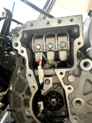

I’m trying to find the oem uvw wires. I know we can make up whatever we want. I’m looking through the oem service manual and can’t locate a diagram.

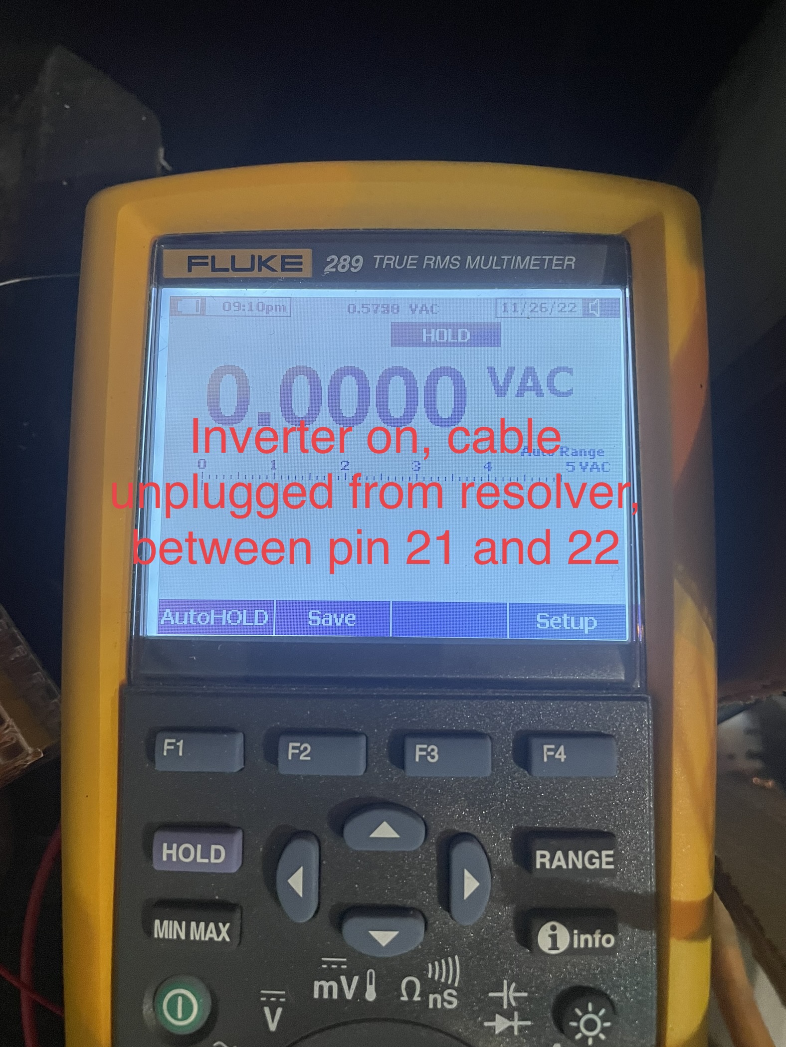

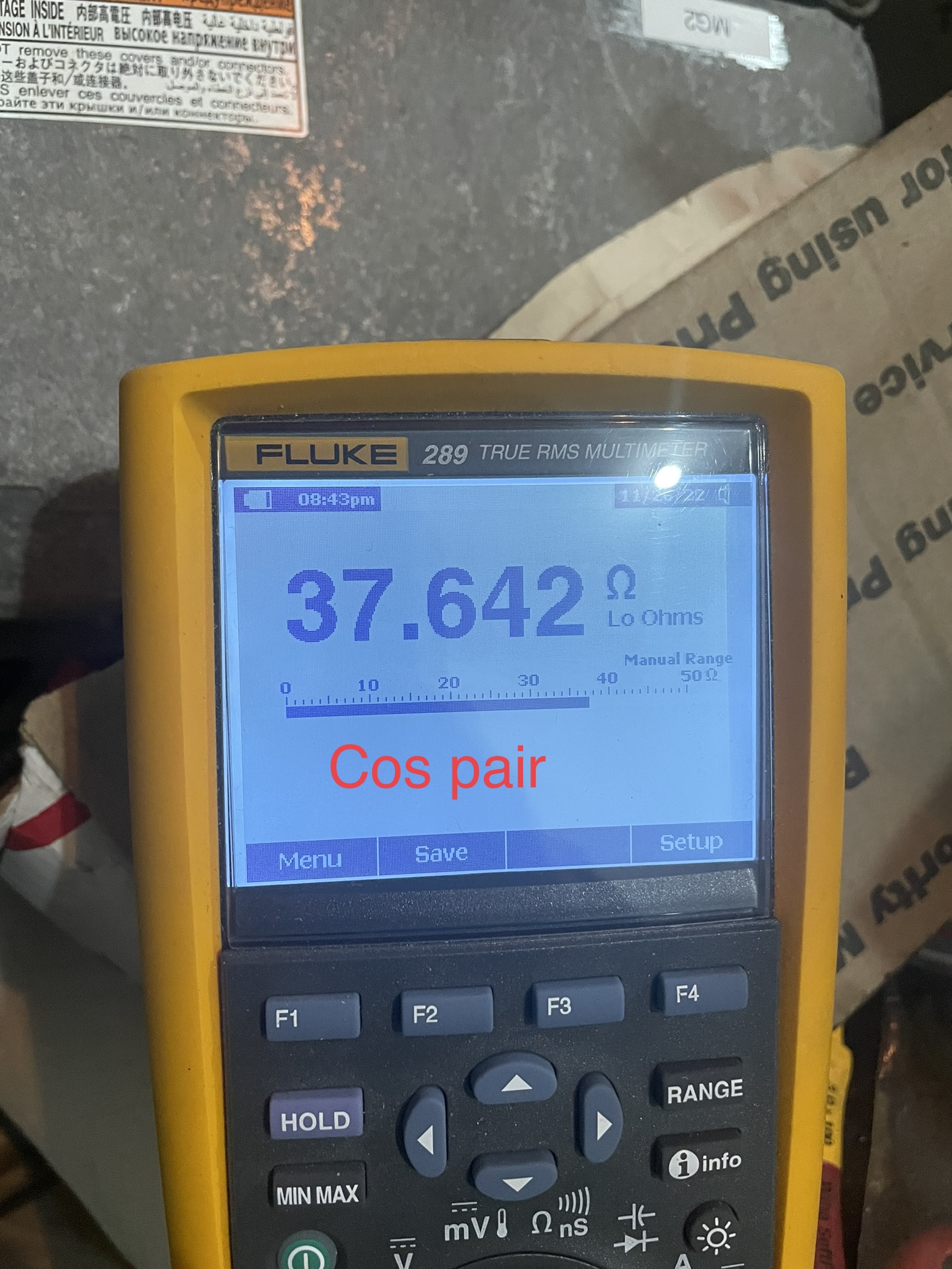

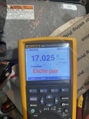

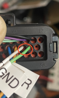

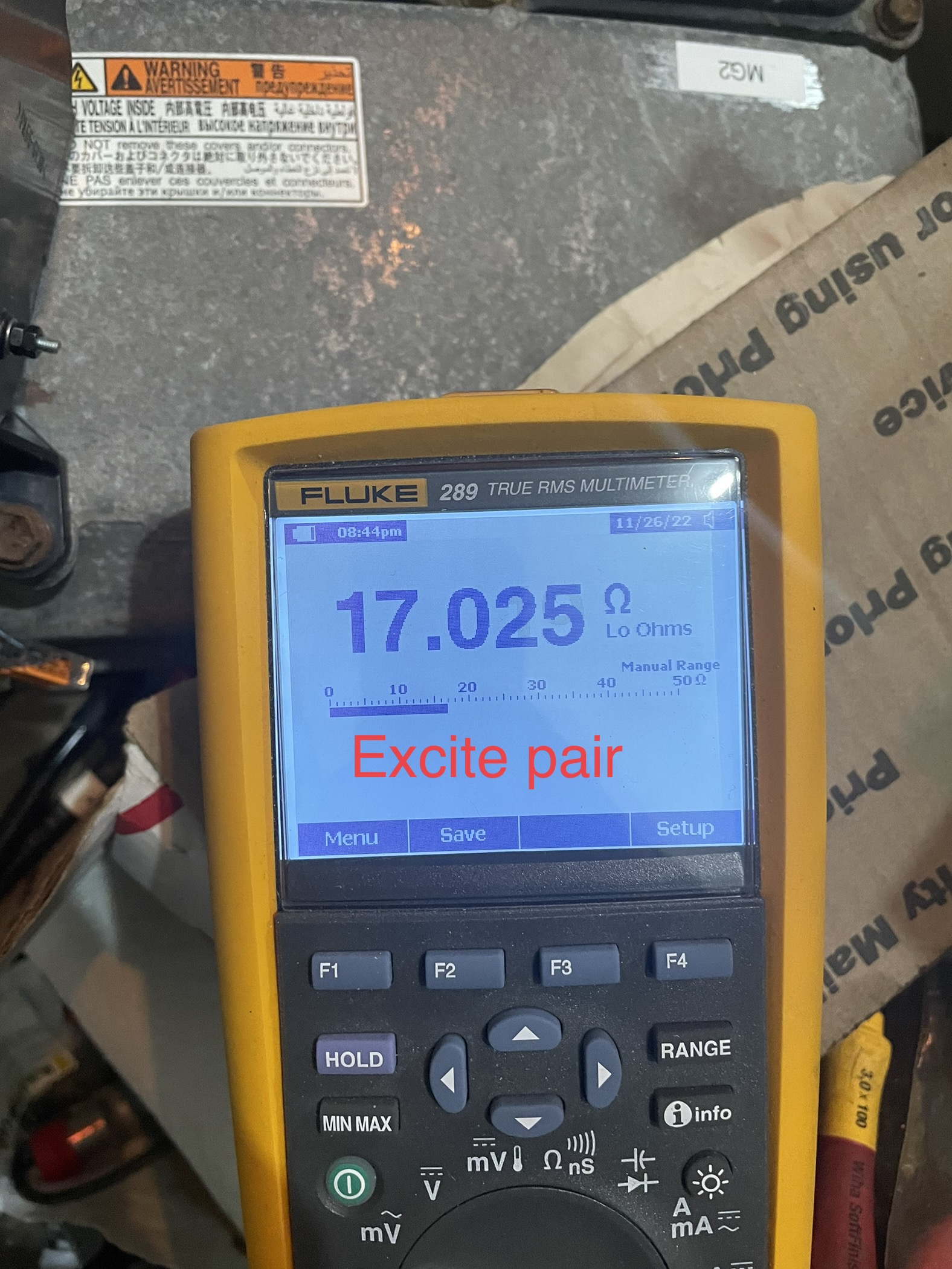

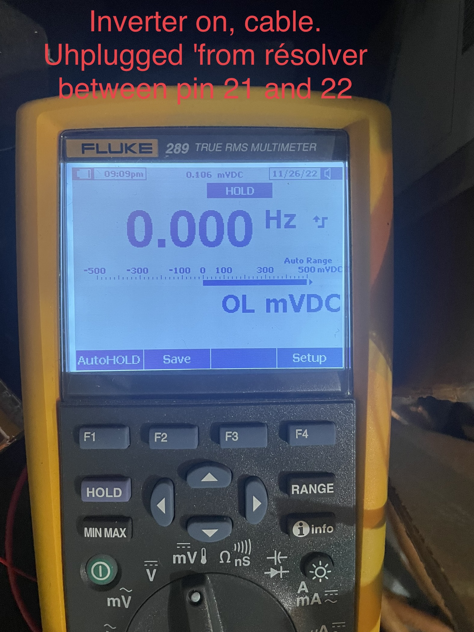

Update: got confused because idc ribbon cable and ampseal pinout are same half the time, well with resolver its all mixed up. Must be on the ampseal pinout. Also could not find this online anywhere, the open inverter excitation frequency is 4.4khz and the voltage is 3.2 volts AC no load (without ...

I think I burned out my resolver excite. Getting nothing on amp seal pin 21 and 22

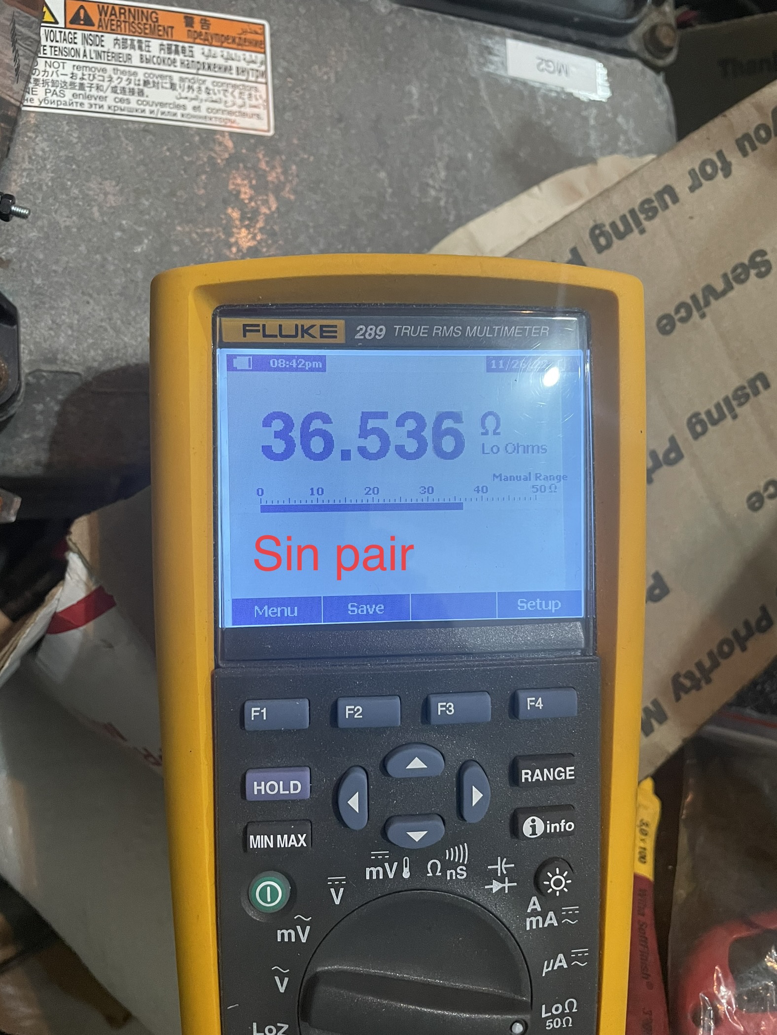

Is this normal em61 resolver ohms?
