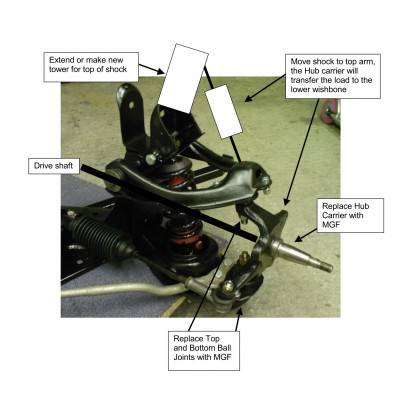

Front Hub Changes

Re: Hyper car hybrid
A doc showing how to convert the MGF/MGTF to 5x4.5"

The classic MGF has an upper and lower load bearing ball joint.
You will need to take the ball joints out of your upper and lower arms.
Then weld on thick washers on their on the top arm place to make ~10mm then use a taper reamer to take the MGF/MGTF upper ball joint.
The lower ball joint is a bolt ...
