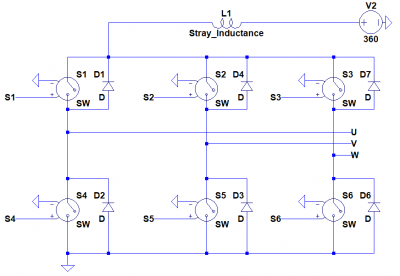

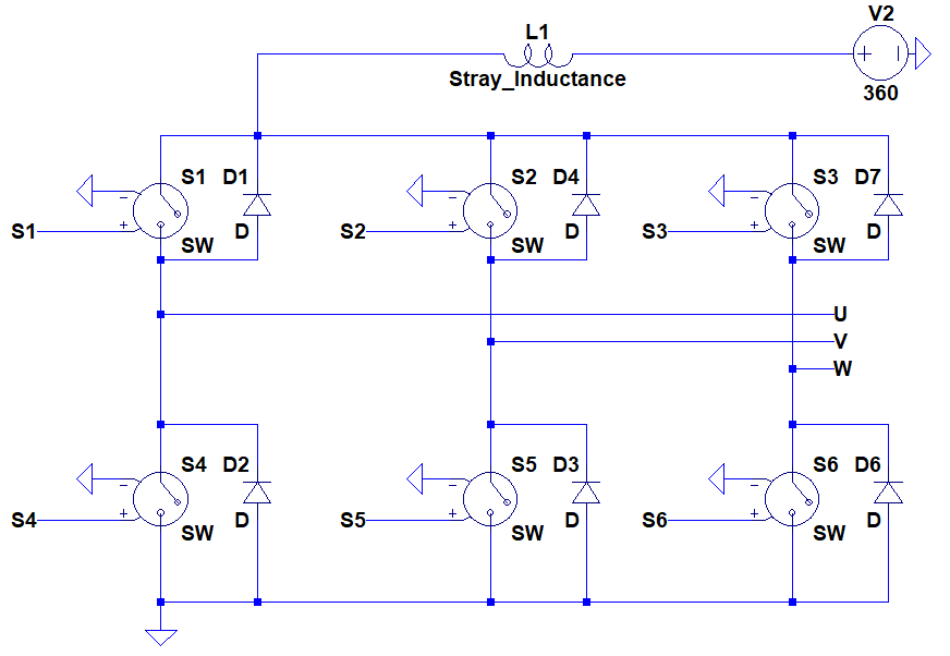

I am not putting the blame on the busbars 100% but it seemed to me that they are way too long than they should be. It's generally desired that the caps are placed almost directly on the IGBTs to minimize the stray inductance. You're using electrolytic capacitors and their ESL is higher than that of the film caps, this can be another factor. So it would be better if you could redesign your DC-link, as Arber also pointed.
Even 50 nH of stray inductance between the capacitor and the IGBTs might result in a voltage spike of more than +1kV or even +2kV while switching off an IGBT where hundreds of (300+, maybe less or more) Amps is flowing. The spike value depends on many factors (the main factor is the fall time of the IGBT), and even the gate resistor value has effect in this.

Since @GrapeNuts is going to design a new power stage, the best practice I could humbly suggest is to keep the DC inductance as low as possible using the well known laminar busbar system where two bus rails are placed on top of each other with a thin dielectric material in between, and to choose the gate resistor value as what's written on the datasheet. With the current high inductance system, the only way to make them survive is to increase the gate resistors though as Johannes suggested.

Thanks for the feedback. I will make modifications to the power stage to reduce inductance. I tried to mount the capacitors as close to the IGBT terminals as I physically could. I was hoping this vertical arrangement and the thick copper bars would achieve that. The vertical section of the bus bar is 3.75 inches. Unfortunately reducing the vertical clearance of the bus bars crowds the IGBT gate terminals. The IGBT module I have has power terminals on either edge of the device. I decided to shape my bus bar in this "C" shape so I could have my bus connected to both sets of terminals with the caps in the center. I may have to move the capacitors out to the side rather than above the IGBT. I will also add a second snubber cap, and reduce the length of the wires from the gate drivers to the IGBT gate terminals and twist them.
Would the inductance on the power stage cause the voltage I measured on the gate driver output and the general symptoms I'm seeing over all? Is there some testing I can perform while I await my new parts to arrive? The gate drivers seem to put out clean signals when the IGBT doesn't have high voltage on it, which makes me wonder if voltage is leaking from the IGBT emitter to the gate?

The inductance might have killed one of your IGBTs in your six-pack. Reducing the wire lengths and making them twisted-pair would be better than the current one, but ideally you must mount the gate drivers directly on your IGBTs. See the image below. In this one the gate drivers pins are soldered at the IGBT pins. Johannes' gate drivers cannot be mounted like this one so you have to use wires, but I would not exceed 1 inch. Assuming you have +15/-9V DC/DC converters and assuming you're using 6 Ohm gate resistors, you're pushing and pulling 4 Amps and those long wires could damage both the gate driver and the IGBT gate because of the inductance in the gate drive circuitry. The stray inductance we were talking about is the inductance of the DC-link which causes a voltage overshoot at the plus and minus terminals. But the gate driver cables are also stray inductance (another one) and they cause a voltage overshoot at the gate terminal of the IGBT and the output of the gate driver. If the gate voltages exceed 20V, the gate is very likely to get damaged. To avoid that bidirectional TVS diodes are placed at the gate terminals, but since the diode is on the PCB and there are very long cables between the PCB and the IGBT, the TVS becomes useless. Most importantly, because of the stray inductance of the gate wire and the gate capacitance, you will have a LC resonant circuit and you'll have deadly voltage oscillations at the gate.GrapeNuts wrote: ↑Sun May 19, 2019 7:01 pm I may have to move the capacitors out to the side rather than above the IGBT. I will also add a second snubber cap, and reduce the length of the wires from the gate drivers to the IGBT gate terminals and twist them.
