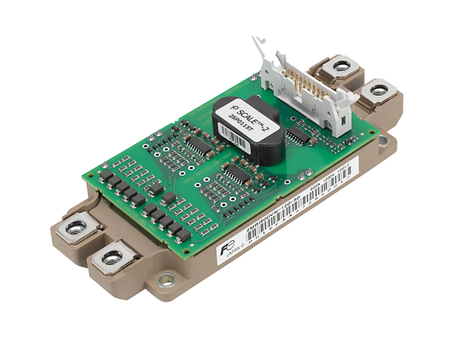

The inductance might have killed one of your IGBTs in your six-pack. Reducing the wire lengths and making them twisted-pair would be better than the current one, but ideally you must mount the gate drivers directly on your IGBTs. See the image below. In this one the gate drivers pins are soldered at the IGBT pins. Johannes' gate drivers cannot be mounted like this one so you have to use wires, but I would not exceed 1 inch. Assuming you have +15/-9V DC/DC converters and assuming you're using 6 Ohm gate resistors, you're pushing and pulling 4 Amps and those long wires could damage both the gate driver and the IGBT gate because of the inductance in the gate drive circuitry.
The stray inductance we were talking about is the inductance of the DC-link which causes a voltage overshoot at the plus and minus terminals. But the gate driver cables are also stray inductance (another one) and they cause a voltage overshoot at the gate terminal of the IGBT and the output of the gate driver. If the gate voltages exceed 20V, the gate is very likely to get damaged. To avoid that bidirectional TVS diodes are placed at the gate terminals, but since the diode is on the PCB and there are very long cables between the PCB and the IGBT, the TVS becomes useless. Most importantly, because of the stray inductance of the gate wire and the gate capacitance, you will have a LC resonant circuit and you'll have deadly voltage oscillations at the gate.
If you have high inductance DC bus you must have high capacitance elcaps AND fast reaction snubber caps. The more your DC bus is laminated the less snuber caps you need. But my experience shows that having only film caps can produce DC resonance and snubbers are still neccessary for large currents.
@Arber, I actually have to object to this, partially :) Film caps are superior in many ways, especially on current ripple durability, ESL and ESR values over long frequency ranges. With a good-enough DC-link design created with film caps, you don't even have to use any elcaps or snubbers. Most importantly, what I have seen from the experiments I have made, more capacitance doesn't make things better if the stray inductance is high. Even if you have "infinite" capacitance, the capacitor becomes ideal voltage source and the circuit becomes like this with the stray inductance (kept it very simple).
In my current design I didn't use any snubbers. Only a 1000uF/700V film cap (power ring). I used 16 Amps gate drivers directly mounted on the IGBTs, and my gate resistance is 1.8 Ohms (datasheet suggests 1.5). Not a single desaturation error has occured so far and I am taking off with full throttle drawing around 500-600 Amps. All the IGBT faults are history like yours :)
