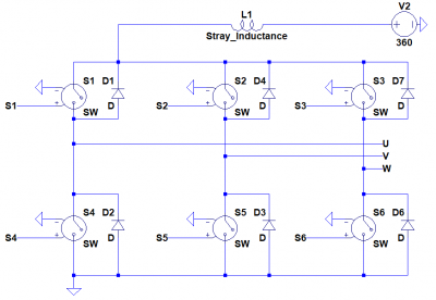

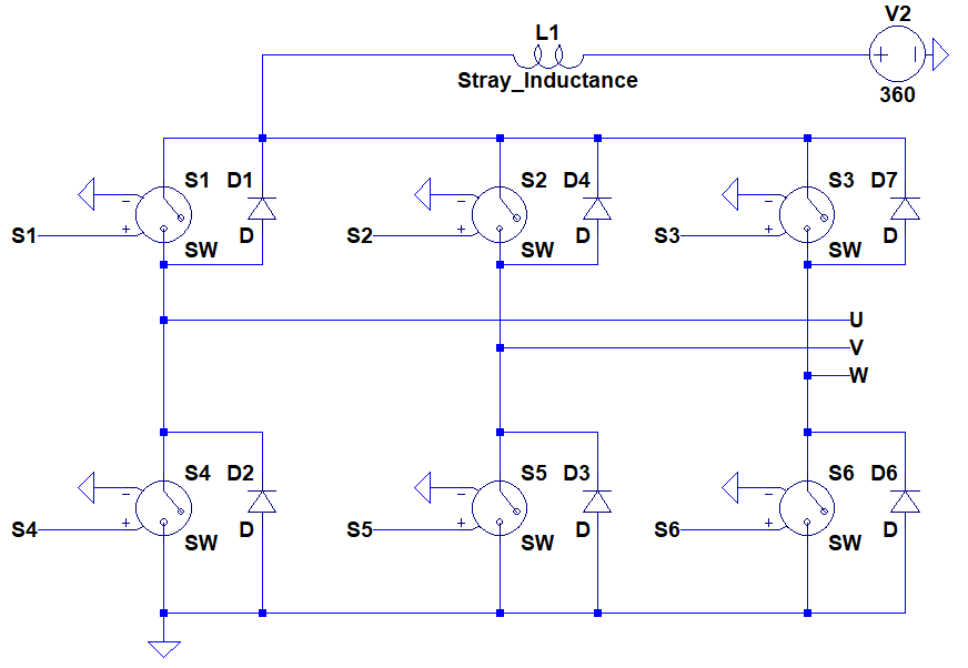

I am not putting the blame on the busbars 100% but it seemed to me that they are way too long than they should be. It's generally desired that the caps are placed almost directly on the IGBTs to minimize the stray inductance. You're using electrolytic capacitors and their ESL is higher than that of the film caps, this can be another factor. So it would be better if you could redesign your DC-link, as Arber also pointed.
Even 50 nH of stray inductance between the capacitor and the IGBTs might result in a voltage spike of more than +1kV or even +2kV while switching off an IGBT where hundreds of (300+, maybe less or more) Amps is flowing. The spike value depends on many factors (the main factor is the fall time of the IGBT), and even the gate resistor value has effect in this.
